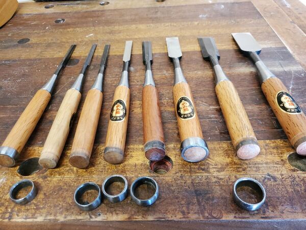

April 21Apr 21 comment_375072 Folks, I inherited this wonderful set of Japanese chisels a few years back from a deceased old woodworker, a WWII and Korean War veteran James Ecklar, who was a friend of our lifetime friends. I was fortunate to inherit many of his tools including the old workbench you see in many of my images.So, these hoops are either falling off, or are loose. Do you have any suggestions how to tighten them back onto the handles? Report
April 21Apr 21 comment_375078 I imagine thru continued use, the top wood would mushroom out a bit and tighten up. Maybe some thick CA in the meantime?? Report
April 21Apr 21 comment_375079 Wish I had those. Anyways..Setting Japanese chisel hoops (katsura) involves removing the hoop, filing its inside edge to a radius, then seating it 1–3 mm below the handle top by compressing the wood fibers. I use a hex socket that fits over the wood but sits on the hoop edge allowing you to drive the hoop down tight. Finally, the handle is soaked on the hooped end and the wood is mushroom peened over the hoop with a gennou hammer to lock it in place. This allows the hoop to take hammer blows and prevent splitting. Does this help? Report

April 22Apr 22 Author comment_375099 Well this is interesting. I can do the same thing by banging to top with a hammer around the edges as you gents suggested, but there is actually a tool for this.WNWoodworksChisel Ring SetterWeight 1.1 lbs Dimensions 2 x 2 x 2 in Report
April 22Apr 22 comment_375101 What if??? You soaked the ends in some type of oil to swell the wood fibers. I have no experience doing this so maybe experiment with one of them. Report
April 22Apr 22 comment_375102 1 hour ago, John Morris said:Well this is interesting. I can do the same thing by banging to top with a hammer around the edges as you gents suggested, but there is actually a tool for this.I'm sorry I didn't mention it John. I knew this. But a hex socket works just as well and even better. Save your money for something else. Report
