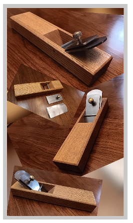

Well, I embarked on a new journey making another type of plane. This time it's making a Japanese Kanna Plane.
A kanna is a traditional Japanese hand plane used to shave, smooth, and finish wood surfaces by pulling the tool toward the user. It consists of a wooden body (Kanna-Dai or Dai) usually white oak and a laminated steel blade (Kanna-Ba), often creating a surface so smooth it requires no sanding.

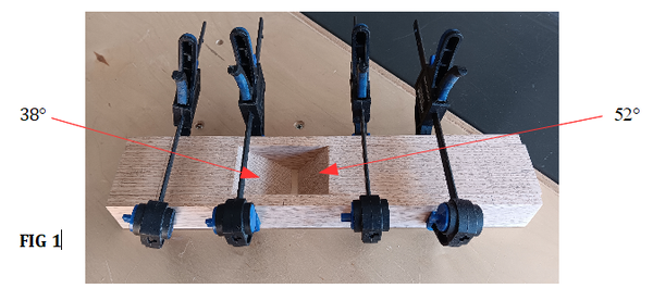

I began by milling a block of White Oak a little larger 3” ( 76.5 mm ) wide x 11” ( 279.4 mm) long x 1- 1/2” (38.1 mm) high. Then I sliced off two pieces that will be the Sides (Left and Right) at 3/8” (9.53 mm) thick x 11” (279.4 mm) long. The center portion that will be the Front and Rear pieces are cut as blocks and then sloped for the bed and mouth areas. The Bed angle is 38 degrees. The face opposite is 52 degrees.
Here's a dry fit clamped together (Fig 1):

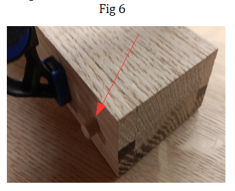

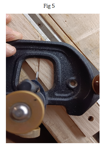

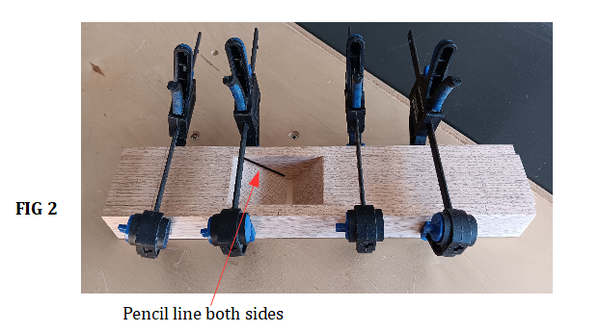

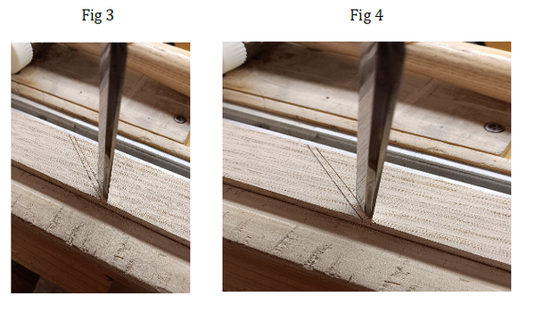

Next, I make a pencil line on both sides of the 38 degree bed (Fig 2). This will allow me to cut the slots required for holding the blade edges. Then I used a blade blank to offset the pencil line accounting for thickness (Fig 3). Then using a chisel, I make knife walls in preparation for hogging out the track with a router plane (Fig 4). This is done for both sides.
Here you see me using my router plane making the tracks (Fig 5)

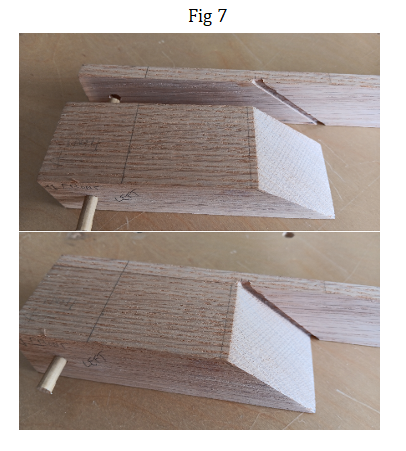

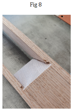

I knew as I made this that I would be taking it apart back and forth checking details and refining the process. I wanted all the pieces to always go back together accurately as I worked. First, I made the overall block length a little longer than 11”. Doing this allowed me to temporarily dowel pin (Fig 6, see red arrow) all pieces at both ends and after all is said and done I will glue these in at final assembly and cut to the finished overall length of 10”.
Here you'll see why the temporary dowel pinning helps in the build process, Fig 7.
I can take it all apart and back together again with perfection registration Fig 8.

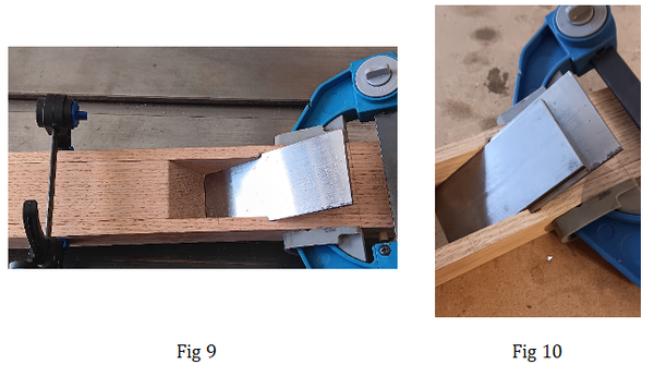

Here's a test fit of the blade blank in place per Fig 9 and the blade and chipbreaker together per Fig 10 .

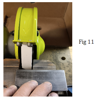

I start by cutting two blanks out of 1095 steel. One will be the blade at 2” wide x 4-1/4” long x 1/8” thick. The other is the chip breaker at 1-1/2” wide x 3-1/2” long x 1/8” thick. I start by perfecting the blank shape for each by passing through the grinder shown here per Fig 11. Afterwards preliminary 25° bevels are put on both.

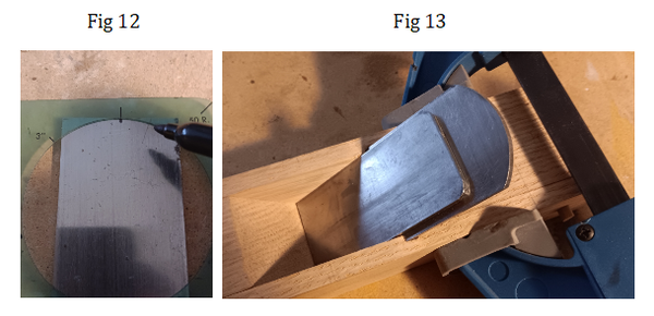

Next I put a 1-1/2” radius on the the top of the blade (Fig 12) and 1/2” radius on each corner of the chip breaker and then both housed for a fit (Fig 13).

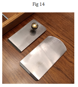

On the chip breaker I tapped a 1/4-20 threaded hole for adding a brass knob. Here they both are per Fig 14. We now proceed to Hardening and Tempering the blade.

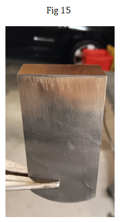

There are a couple of ways to do tempering. You can place in your oven or toaster oven at 375 – 400° F for 1-1/2 to 2 hrs and let it completely cool down or you can do it by hand in a vise. The oven method usually is done twice. The process is more controlled but it uses a lot of energy just to do a blade and you do have to baby sit the process to make sure it doesn't go past a straw color. Then you have the waiting time to let it cool which can be longer than an hour. It can take over 6 -7 hrs when all is said and done. My wife wouldn't be too happy. Of course you can use a toaster oven if you can find one with stabile consistent temperature. The hand held method is done in the vise as mentioned under annealing above. You torch the blade about a half inch down from cutting edge and across the width until it reaches a straw color.
BUT....once the color starts it moves towards the edge so fast that its easy to ruin. If you go past the straw color then its likely ruined and you have to start all over again. I use a another piece of steel sandwiched under the blade's bottom and heat with the torch from the underside of this piece. This slows the heating process for the blade on top and gives you time to react when you see the straw color. Normally tempering is done by allowing it to cool naturally once you see the straw color at the cutting edge. But I have found that a quick quench in oil stops it from going past the straw color and being ruined. This is particularly true with 1095 steel. Ron Hock, who is known for making Hock blades (now owned by Lee Valley), quenches in oil when tempering.

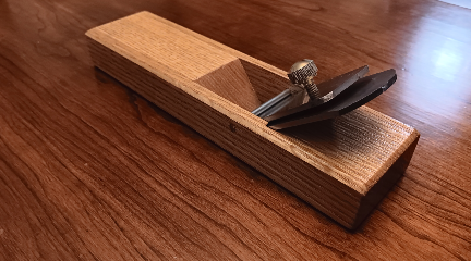

Here's my blade tempered (Fig 15) and ready for final honing.

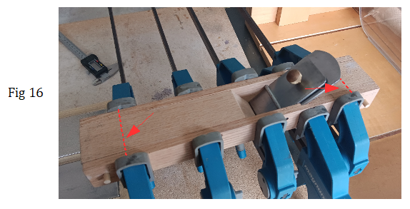

Now I glue all the planes parts and clamp them together. When its dry, I'll remove the clamps and cut off the front and rear portions of the body. (see the red dotted lines). This will reisze the plane's length to the final 10” long. See Fig 16.
The completed body (Dai) is 2.5" (63.5 mm) wide x 10" (254 mm) long and 1-1/4” (31.75 mm) high and as mentioned previously is made out of American White Oak.

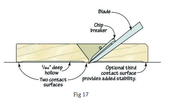

Relieving the Bottom
The process of relieving the bottom is necessary because it reduces the friction and provides effective planing. This was was a challenge for me. Hard to relief it 0.015" ( 0.038 mm) as required on all kanna planes. See Fig 17.
On the bottom of this plane I chose three points of contact as shown in Fig 17 above. These three areas are all on the same plane. I used a card scraper to do these relief areas. I set it on top of my cast iron tablesaw and checked the bottom for the .015” gap by using a feeler gauge. You could also set it on plate glass and measure your progress as well. I only had to do this a couple of times.

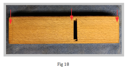

Per Fig 18, I start by penciling out boundary lines and cross hatching indicating the areas to be recessed. Red arrows indicate areas not recessed and lay in the same plane (the original bottom). These areas are 1/4” by the plane's width.

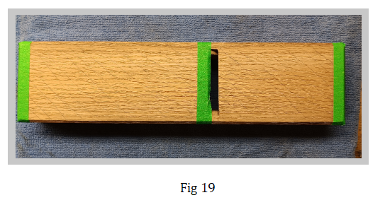

Then per Fig 19, I green tape it to provide better visibility and cover the areas that wont be recessed. All hatched areas (look closely) are ready to scrape down 0.015”. Gads!!

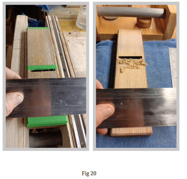

Here in Fig 20 is the process in action!! Keeping it dead flat was a challenge.

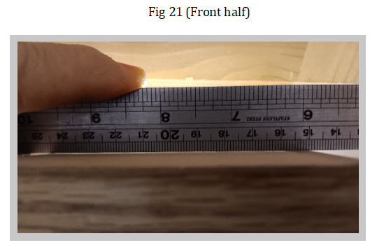

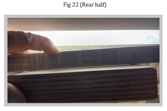

Here in Fig 21 and Fig 22, I am checking all the recessed areas as I go to achieve the .015”. I hold up to light and use a steel rule straight edge to monitor the gap and then check with a feeler gauge.

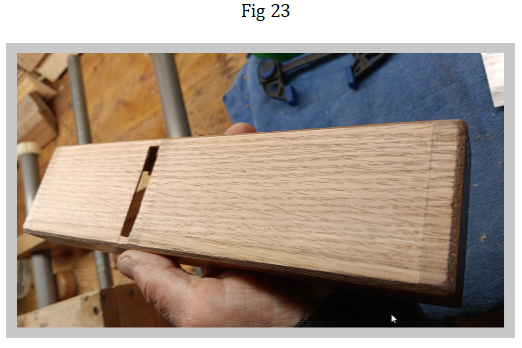

Here per Fig 23, it is finally completed and everything is dead level and perfect!!
