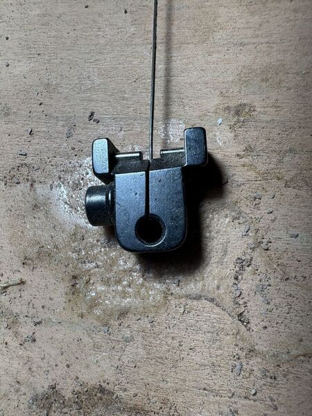

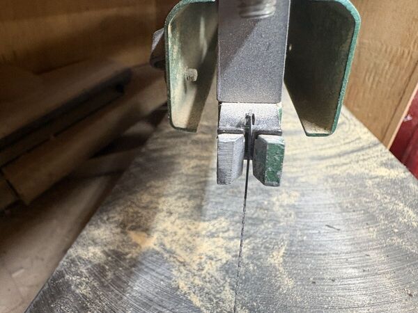

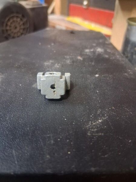

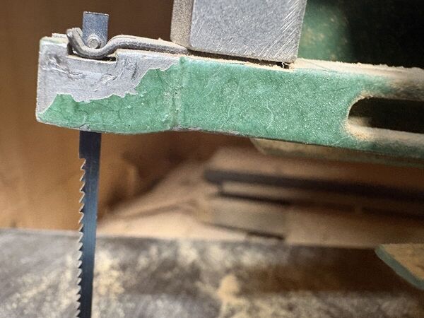

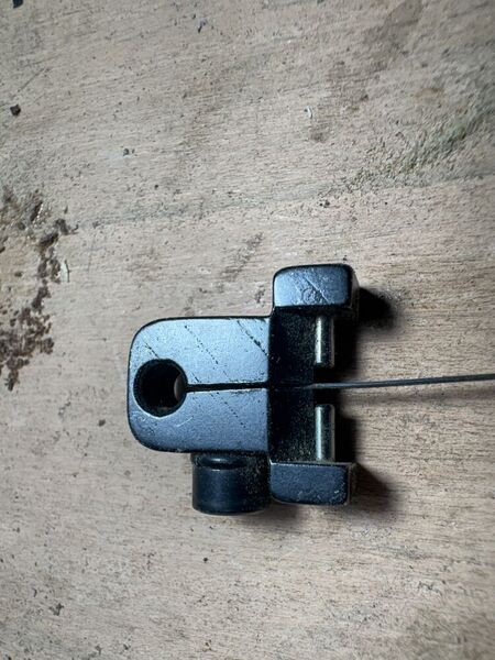

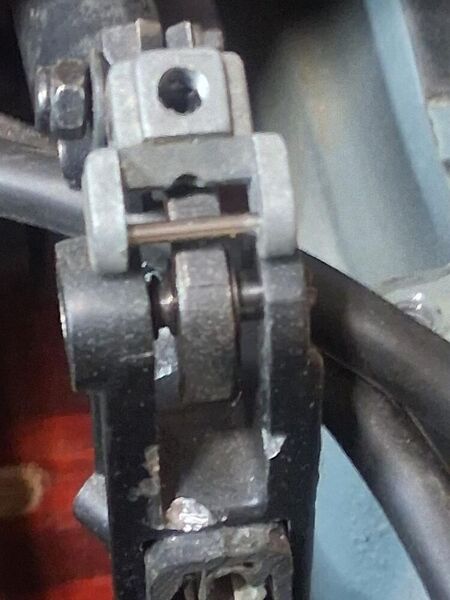

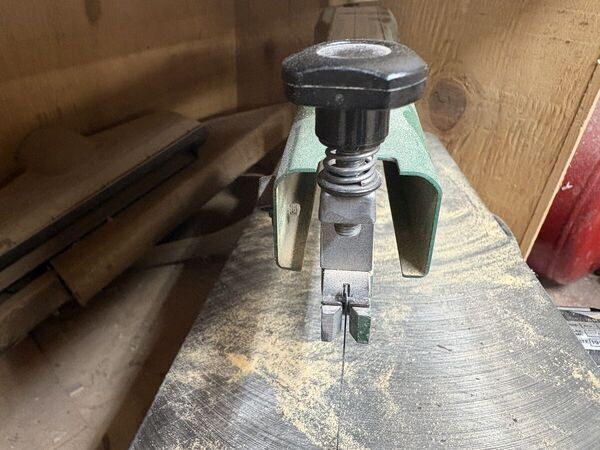

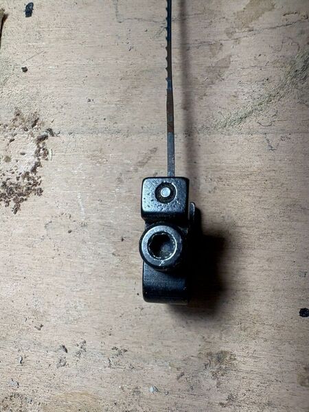

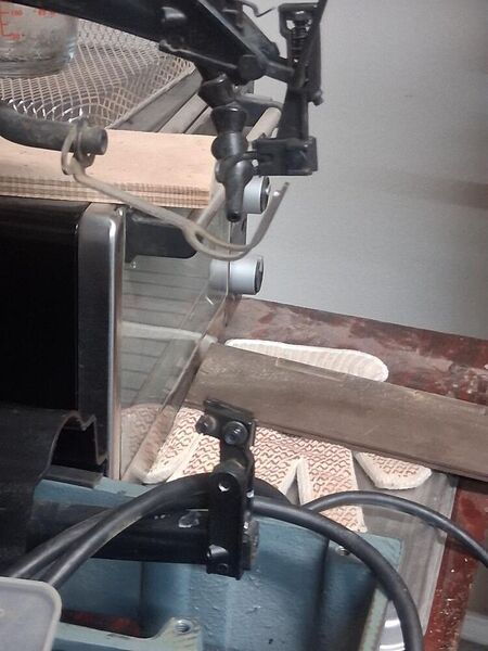

May 19May 19 Author comment_376415 Update on the Delta. As stated earlier I have a work around for the bad printed circuit and it works. Upper blade chuck is together and seems to work. Lower blade chuck is incomplete but I may have a work around and need some input.See posted pics. 1 is alignment of top and bottom chuck (ignore the oven in background). 2 is lower chuck incomplete. 3 is possible modification. My concern is if I remove the lower chuck - blade seems to be slightly to rear of screw holding assembly to lower arm. If I use pic 3 mod with a home built connecting block (measured and will work) is the blade going to be out of alignment with top chuck? OR am I overthinking this. Connecting block would be steel although I do have brass Report

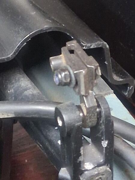

May 20May 20 comment_376427 After looking at the last image (lower rite) it reminded me of the adapter that came with my very old Taiwanese scroll saw. My saw was made to use pinned blades but also came with an adapter for pin less blades. Maybe it will give you an idea for something you can make.The adapter- Report
May 20May 20 comment_376430 7 hours ago, Lost Oki said:Update on the Delta. As stated earlier I have a work around for the bad printed circuit and it works. Upper blade chuck is together and seems to work. Lower blade chuck is incomplete but I may have a work around and need some input.See posted pics. 1 is alignment of top and bottom chuck (ignore the oven in background). 2 is lower chuck incomplete. 3 is possible modification. My concern is if I remove the lower chuck - blade seems to be slightly to rear of screw holding assembly to lower arm. If I use pic 3 mod with a home built connecting block (measured and will work) is the blade going to be out of alignment with top chuck? OR am I overthinking this. Connecting block would be steel although I do have brassPicture #2 is of the lower blade clamp, correct? If it is, it appears that the plate with the "hooks", on the right side is installed backwards; the "hooks should face away from the other side, and you should be able to clamp a blade in the lowers holder by tightening the nut with a nut driver.Tightening the blade: loosen nut until blade can be slipped into the space between the two plates (in the front of the assembly), rest the blade on the lower housing, push the blade back as far as possible, carefully tighten the nut while holding everything in place. Thread blade through pilot hole and use the upper clamp, then apply tension. Report
May 20May 20 Author comment_376454 Thanks for the pics Lew. Food for thought.Wichman3. Had not thought of that, pic is the way it was when purchased, similar to the upper. Not sure why I did not explore just clamping the blade in. This is what I like about this site, always good info. Thank You Report
May 20May 20 comment_376458 Sorry, I was wrong about the parts being installed incorrectly, but you can just use the clamp manually and not with the spring.There are several threads I'm following on a couple of different sites, and my brain ain't braining. (migraines brought on by two different medications).I have a Delta two speed with the quickclamp on the top, so I have a ready item I can refer to. :) Report
May 21May 21 Author comment_376497 Wichman3. I was able to clamp the blade on the bottom manually but there seems to be a lot of slop between the pin that secures the clamp to the bottom arm. There is a keeper on the right side and a spring on the left. The pin shows a little wear but very little on the clamp arm. is this normal? Is there a bushing taking up the slack? On the positive side I did manage to run the saw without the blade coming out. Edited May 21May 21 by Lost Oki Report
May 22May 22 comment_376527 Sorry for the long response time (bad day with headache and light sensitivity 6/6, plus dark bars on the outside of my field of vision).there seems to be a lot of slop between the pin that secures the clamp to the bottom arm That seems normal to me, I've never had any trouble with the blade wobbling, I think the roll pins flex's slightly under tension and keeps the blade centered.\There is a keeper on the right side and a spring on the left. The pin shows a little wear but very little on the clamp arm. is this normal? This also sound normal to me.Is there a bushing taking up the slack?Not as far as I know.At this point, I'd just start cutting; and I'd start with some practice patterns just to get used to the machine. :) Report
