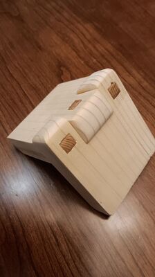

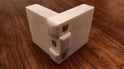

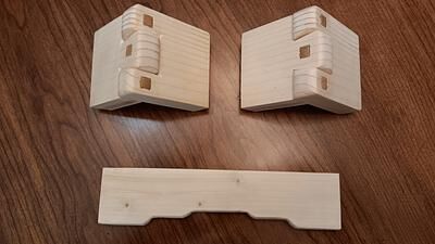

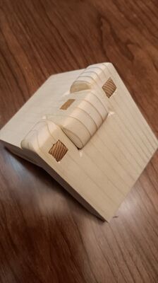

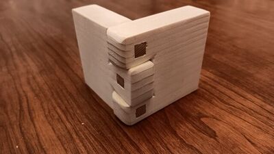

I had never done G&G before so I decided to start experimenting. Keep in mind here that these are being done roughly so I can decide if I'm going to go further.
Usually box finger joints employ a G&G flavor but I wanted to see how the technique would look with hand cut dovetails.
I bought a 5/16" square hole punch from Lee Valley and started into it after cutting the dovetails.
All this was done with pine.
The punch is very sharp but I found it tricky to judge how hard to tap with the hammer in order to get crisp cuts. It wasn't too bad but I'm learning.
I read several articles with a few good suggestions which I tried and it was helpful.
Making the plugs wasn't bad at all and I have developed a few ways to make them.

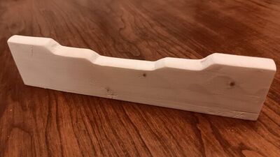

On these I made darted reliefs. It just a flavor. Not sure I like them.
No finish has been applied yet. Maybe I'll shellac it all.
Here's what's called a  "cloud lift"
