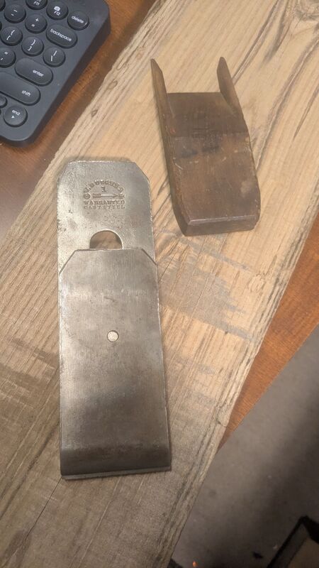

A very long time ago a good friend gave me this.
The blade is 2 7/16 wide.
I have had it for so long because I could never find enough wood to do what I want to do with it, and I am not certain I could do it, anyway.

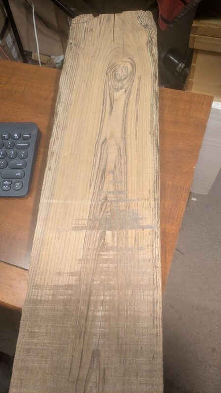

I have this as well.
It's Sassafras, and about 30 inches long by about 1 and an eighth thick and 7 inches wide.

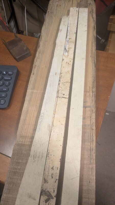

I also hve these.
They are offcuts of a board that came from an old barn. Black Walnut, about 3/4 thick by about an inch high.
I'm thinking of joining them and sandwiching them between the sassafras. That would give me a blank around 3x3, and I think after cutting away the trashy stuff I might get between 18 and 20 inches length.
