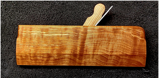

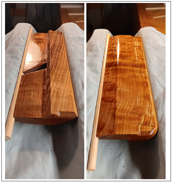

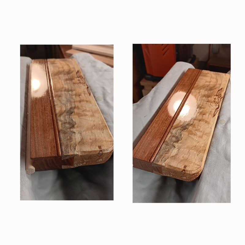

January 9Jan 9 Popular Post comment_368547 This is what it looks like! Man I love it! (Zoom in !) Edited January 9Jan 9 by MrRick Report
January 9Jan 9 comment_368551 Beautiful! I’d be afraid to use it for fear of destroying the finish Report
January 9Jan 9 comment_368552 Certainly further enhances the spalting as well as the grain characteristics. Report

January 9Jan 9 Author comment_368581 12 hours ago, lew said: Beautiful! I’d be afraid to use it for fear of destroying the finish Lew... French Polishing (FP) to my knowledge is a finish never seen on moulding planes. FP is probably one if not the only finish that truly is refined and superior to many many others. It's main job is to "pop" the grain and show the beauty of it. Which it does nicely. FP does not wear well to friction so I try not to put on the sole where the cutting action is when planing. Never be afraid to experiment. The experience is two fold: 1) the beauty of the finish itself and 2) learning and gaining the experience and the Joy in the Journey. Not being afraid affords you learning something new or improving on what experience you may already have. Being afraid or not trying at all is a loss in that joy you could have had. Report
January 9Jan 9 Author comment_368582 12 hours ago, Grandpadave52 said: Certainly further enhances the spalting as well as the grain characteristics. IMO You can't beat the way French polishing enhances the grain. However where you apply on moulding planes matters. Report

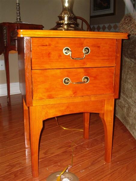

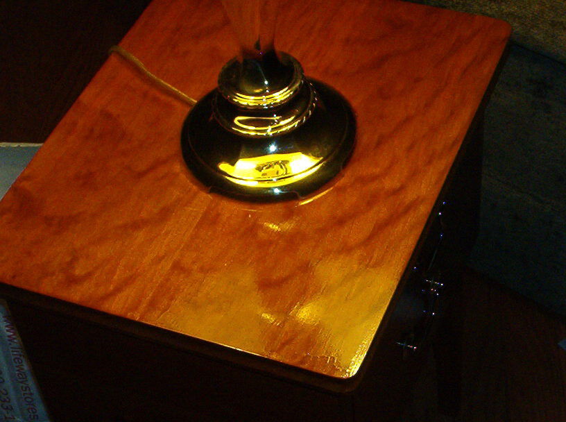

January 10Jan 10 comment_368617 My experience with French Polish started several times as I would mess up and basically have to start over. I think it is only 4 pieces but it started with this stand modified from a NYW plan as a shaving stand. This is my side table. This is the only FP on it. Have to say it is both frustrating and fun ( that is at the time you have finally figured it out). Report

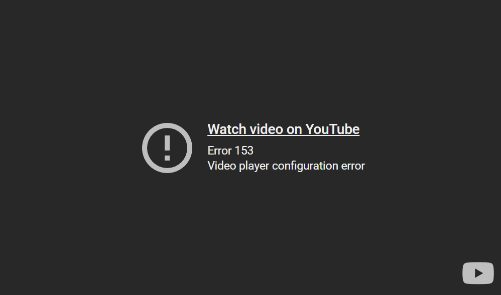

January 10Jan 10 comment_368642 This is one of the best instructional videos I've ever seen for French polishing - I'm not sure why the videos I post are showing as an error because I've posted plenty before and they didn't do this. Either way, this is a great video but here's the link if that helps - https://www.youtube.com/watch?v=MxRIPkzgUTM Report
January 10Jan 10 Author comment_368644 11 hours ago, Gerald said: My experience with French Polish started several times as I would mess up and basically have to start over. I think it is only 4 pieces but it started with this stand modified from a NYW plan as a shaving stand. This is my side table. This is the only FP on it. Have to say it is both frustrating and fun ( that is at the time you have finally figured it out). Gerald...FP Can be frustrating but once you figure it out it is awesome. I find most woodworkers don't allow enough drying time in between coats. They get impatient. They also don't understand when to add more oil or more alcohol to the rubber (fad). The other thing is how you sweep into the surface and out. There are a bunch of little things but once you get them you're in your way. Report

January 10Jan 10 comment_368656 4 hours ago, difalkner said: I'm not sure why the videos I post are showing as an error because I've posted plenty before and they didn't do this. Well, I just pulled this thread up on my phone and all the videos show as they should. Looks like I've got some sleuthing to do on my computer! 🤔 Btw, this is how they're showing on my computer but I'll find the issue - Report

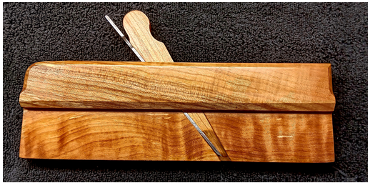

January 11Jan 11 Author comment_368666 Here's another one of my moulding planes that I French Polished with shellac. It's a #2 (¼”) Round Moulding Plane. Report
January 11Jan 11 Author comment_368671 1 minute ago, difalkner said: Gorgeous, just gorgeous!! Thank you @difalkner ! Report
