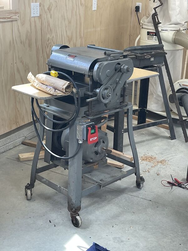

Thanks @lew That review was pretty glowing for sure. I have purchased woodworking equipment at auction before and did VERY well with it.  So I’m not really afraid of an auction.  But I enter into an auction with a fixed price in mind. I won’t go over that amount. Something my dad taught me. I already have a 220 circuit ready for a bandsaw. I did that when I had to run a special circuit for my surface plainer I bought at an auction. It is a beast and even came with new blades.  I did put a safety switch on it and a new cord. But I have been incredibly impressed with the quality.
