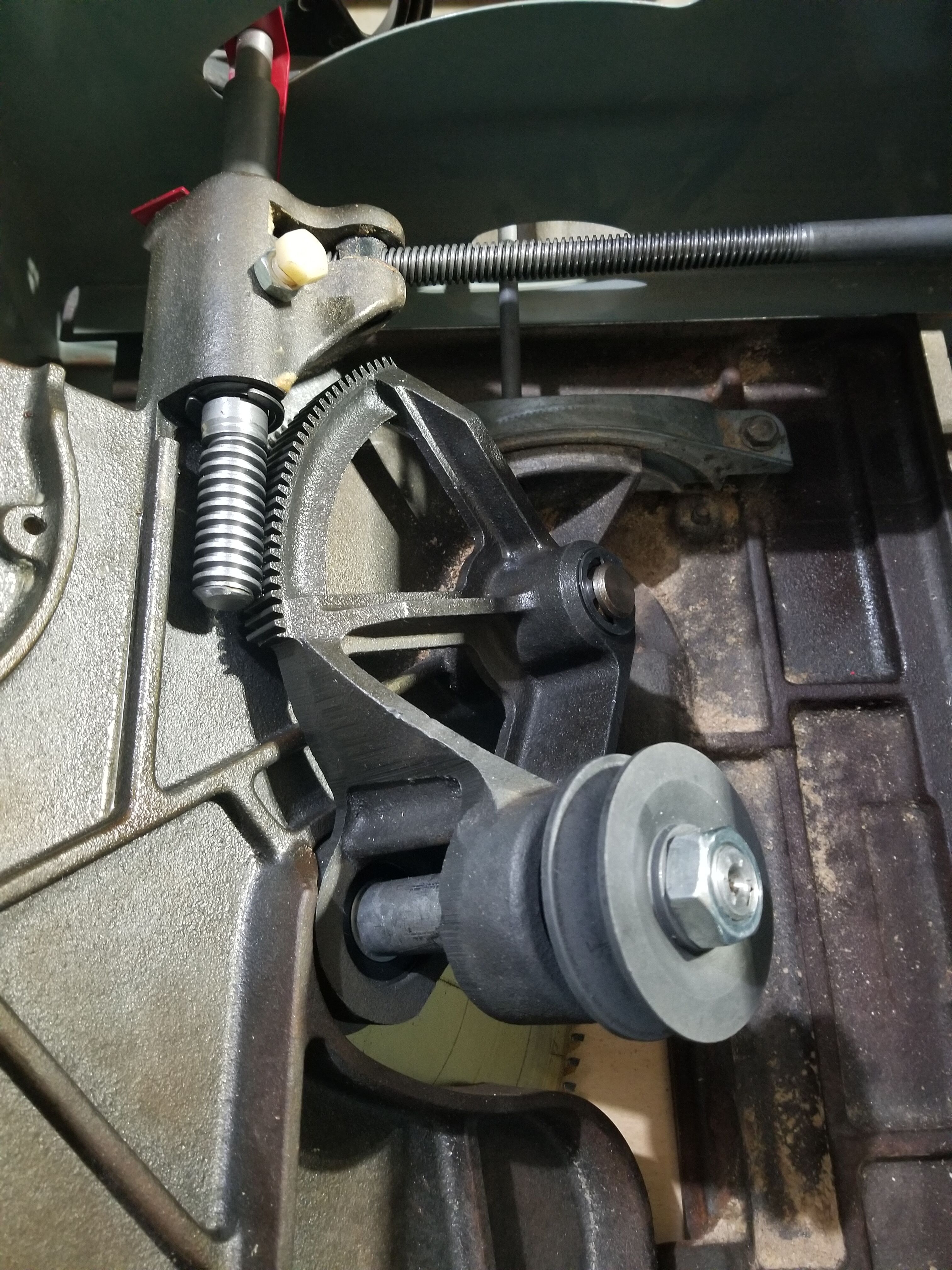

So, I'm finally getting started on the overhaul of my Delta 36-630 table saw. I already had the stand and everything else disassembled for my move earlier this year. I decided to go ahead and do an overhaul cleaning and maintenance while it's apart. I have the bearings out and will pick up replacements this week. Little did I know that the large washer flange thing on the inside of the arbor was actually pressed on the spindle, not threaded on. I used a pair of jaw pullers and it came off without further trouble. This leads me to my first question. How do I press that part back onto the arbor??

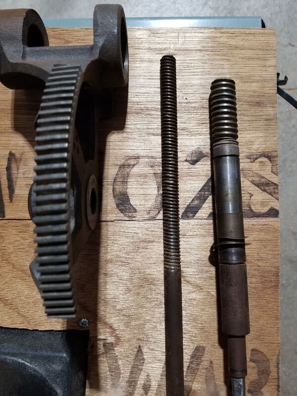

I'm also going to work on cleaning every moving part that is threaded. This saw is multiple decades old at this point and the build-up of sawdust and general grime is significant in places. In between the teeth for the arbor bracket, and on the threads of the elevating screw and tilt screw, there is some fossilized sawdust. Is there an easy/recommended way to remove this wood concrete? I have brushes, screw drivers, and lots of other things I could use to scrape it out, but I don't want to damage anything in the process.

 I would spray the sawdust with some P-B blaster or Truster a couple of times and let it soak in. A scratch awl is a good starting tool pick at the sawdust.
I can't believe I completely forgot to include the pictures I took!

My default for cleaning the threads, gear sector etc. would be a wire wheel either in a drill press or bench grinder. Bob's idea of pre-soaking with PB Blaster would help to soften and make removal easier.

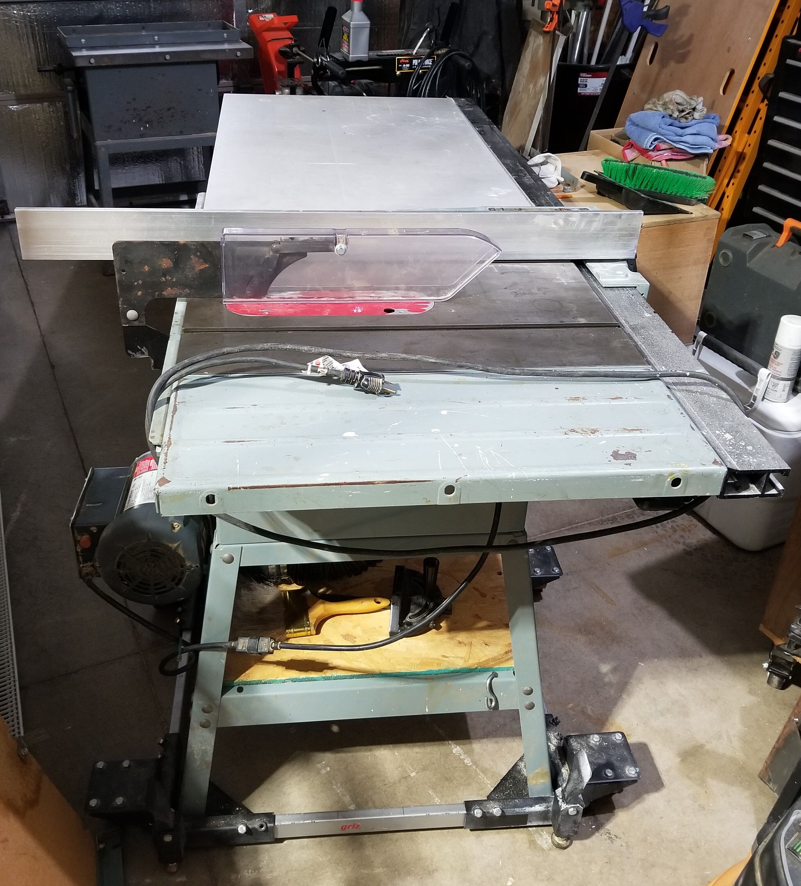

@JWD - Thanks for the offer! I ended up just using the old wave washers and shims. I got impatient and put everything back together. I figured if I had everything apart, considering the age of the saw, that it would be good to replace stuff. However, I just want to get my saw back together and start making stuff! I need to start phase two of my pantry/shelves/storage cabinets project. Of course, I'm adding to my wait time anyway now. I just found a similar table saw with a larger extension table, rails, and fence for a 52" cross cut for cheap. I'm picking up Saturday and will finish assembling the saw then. Here's a picture of the reassembly so far.

For the fossilized sawdust, soak the parts in mineral spirits or Simple Green, then clean with a brass brush or pick. A little heat helps too. Once everything’s cleaned and lubed, that old Delta will feel brand new.

The saw has been fully reassembled! I picked up an older Rockwell saw with no motor that had the longer extension table, a 7' rail, and Unisaw fence (it's in the top left of the photo) and I swapped all of that over to my Delta. I only had to drill one hole in the back rail support and then 2 to relocate the support legs. Everything else lined up perfectly. All for $125! I've done very well this past year with finding some great deals on Marketplace. All I have left is to check the alignment of the blade and set the alignment of the fence. I put some PALS on the saw when I initially got it and I'm very curios to see if the alignment has held through the long-distance move.
