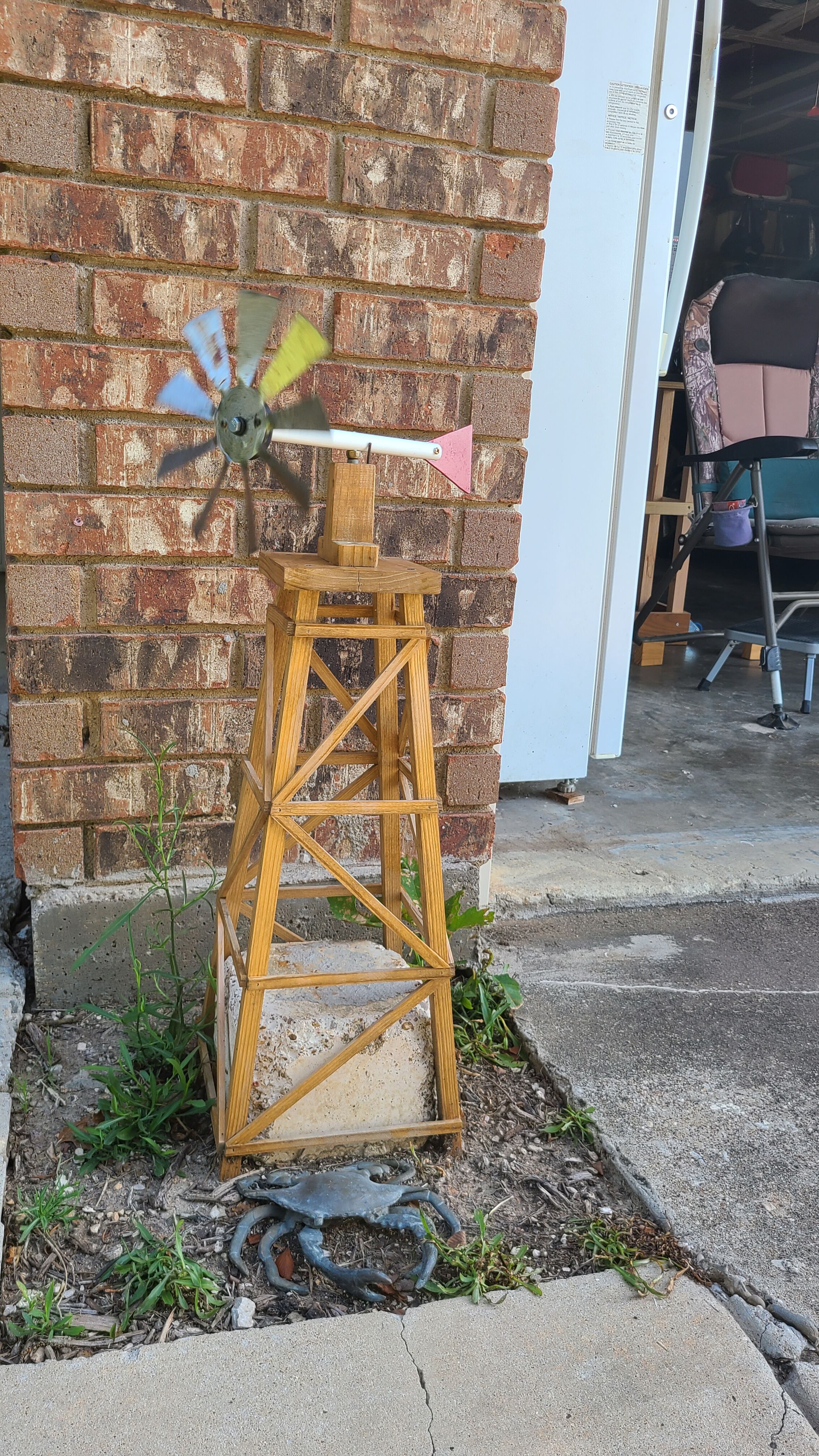

October 17, 2025Oct 17 Author comment_363350 7 hours ago, Ron Dudelston said: Define the piece a little. Furniture, deck or other? It's just a windmill I built out of scrap wood that sits in front of my garage. Report
October 17, 2025Oct 17 comment_363351 Well Bubba IMO, the "best" way is to use good quality, oil based, exterior paint. Probably not what you may want aesthetically, but will require less maintenance than any form of "transparent" finishes. Anything but paint will need cleaned and finish reapplied at least every 3-5 years. BTW, really nice job on the windmill. Report

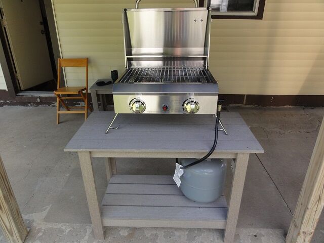

October 17, 2025Oct 17 Popular Post comment_363361 Buy some plastic deck material and build with it. Report
October 17, 2025Oct 17 Author comment_363387 Thanks for the idea @HandyDan. I'm not looking to build another windmill just make the one I have last a little longer. I can see how that material might work for future projects. Is it very expensive? I'm a cheapskate. Report
October 18, 2025Oct 18 Popular Post comment_363394 2 hours ago, Bubba said: Thanks for the idea @HandyDan. I'm not looking to build another windmill just make the one I have last a little longer. I can see how that material might work for future projects. Is it very expensive? I'm a cheapskate. I don't like to spend money either and the deck material isn't cheap. I know a guy that builds decks and he gives me cut offs he would just throw away. Makes it very affordable to me.🙂 Report
