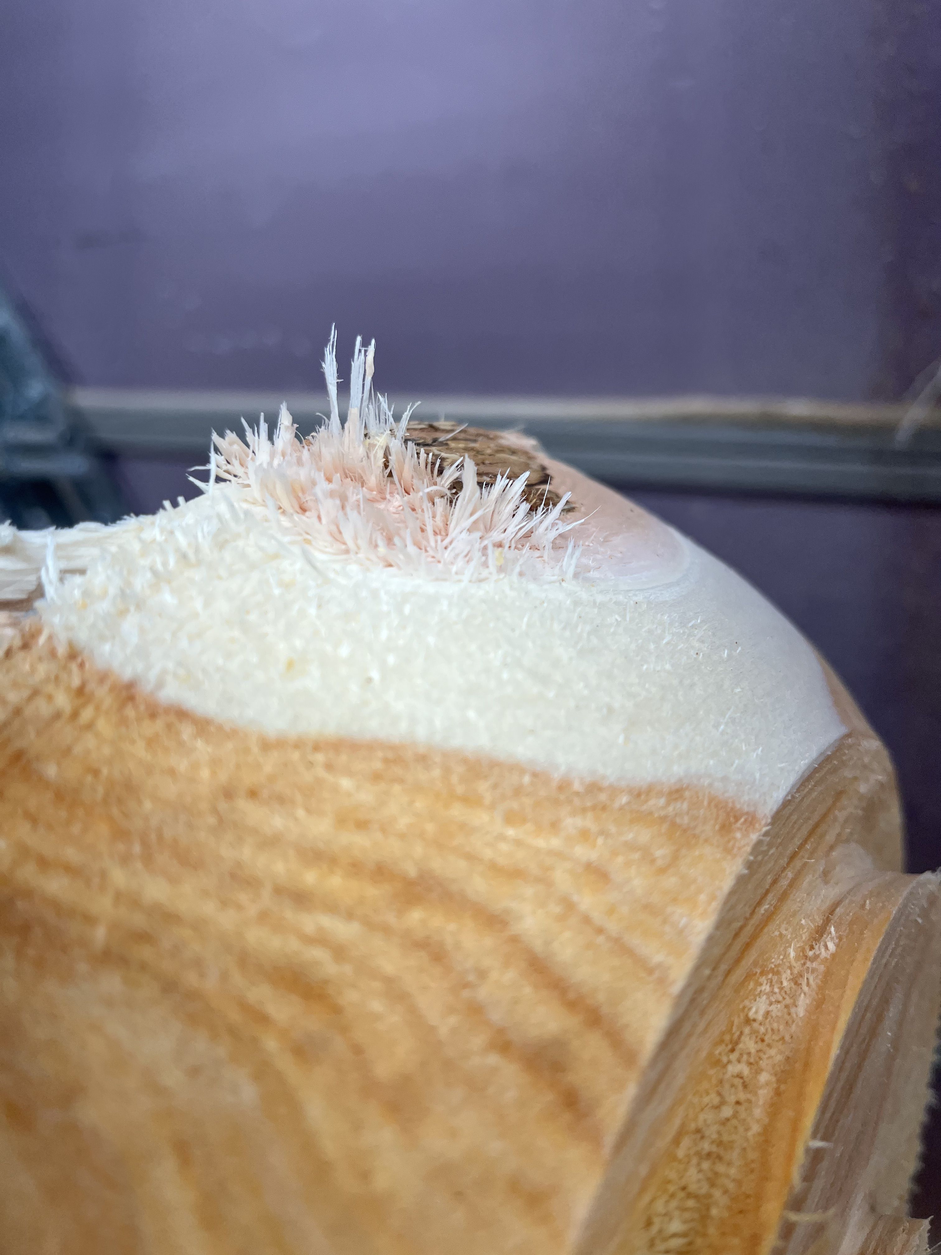

Started doing a wet turn on some of this elm. The end grain fibers just don’t want to cut,no mater how sharp I get the gouge. I’m guessing that is the same characteristic that makes it tough to split.
I’m wondering if I should just let it dry out some more?

You could put CA glue on that area to harden the fibers
I might give that a try. Thanks
