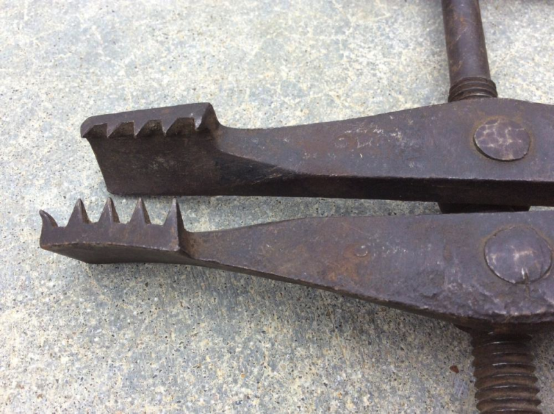

Medieval in the nose torture devise.  Don't know what it is but did find an additional picture to peruse.
hand screw clamp parts...
Looks like an official 1895 roach clip.  DAMHIK Dave. 🥹        On a serious note, it is really old because the rivet pin is hand swedged.  If you look, the teeth are offset and interlock but are only on one side.  I’d guess leather working or canvas tool of some sort.
Ding.  Ding.  Ding. Ding.
I believe Mr. Dudelston has guessed it correctly.
Found this after a brief search for leather clamps.
Dang and I think it is a threading device for corks

@Headhunter, you brought it home, Ron got it there and you confirmed, plus, Ron got it last month so he's set for a year! :) I think Ron would approve.
Winner
@Headhunter is the winner of this months What's It. It was a combined effort between @Ron Dudelston and Headhunter, since Ron won it last month, I think he'd be happy to let Headhunter have this one.
