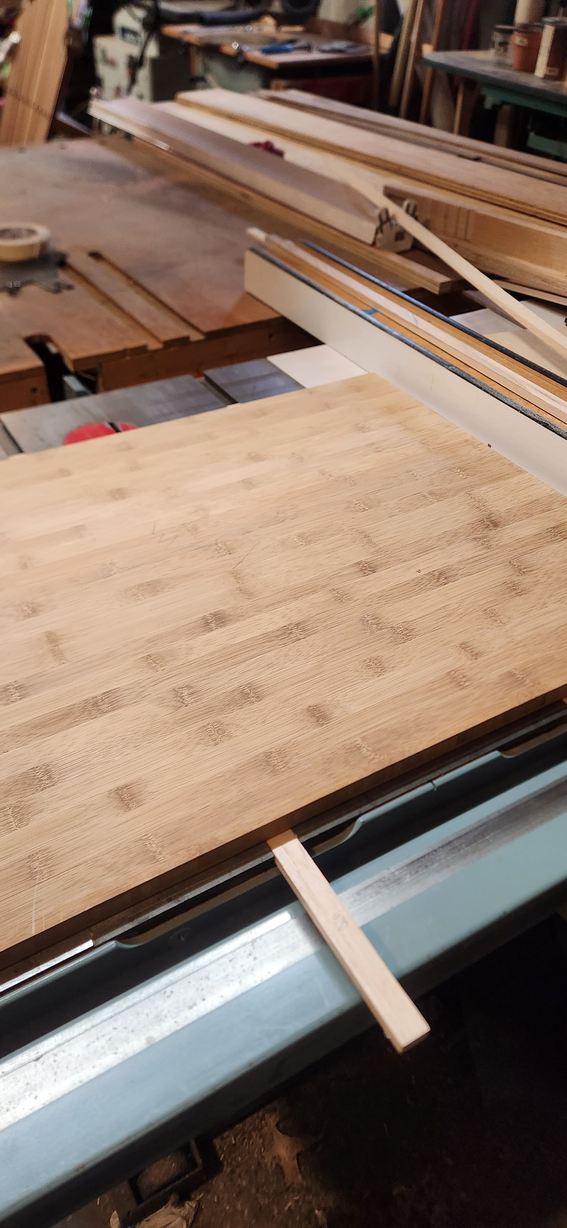

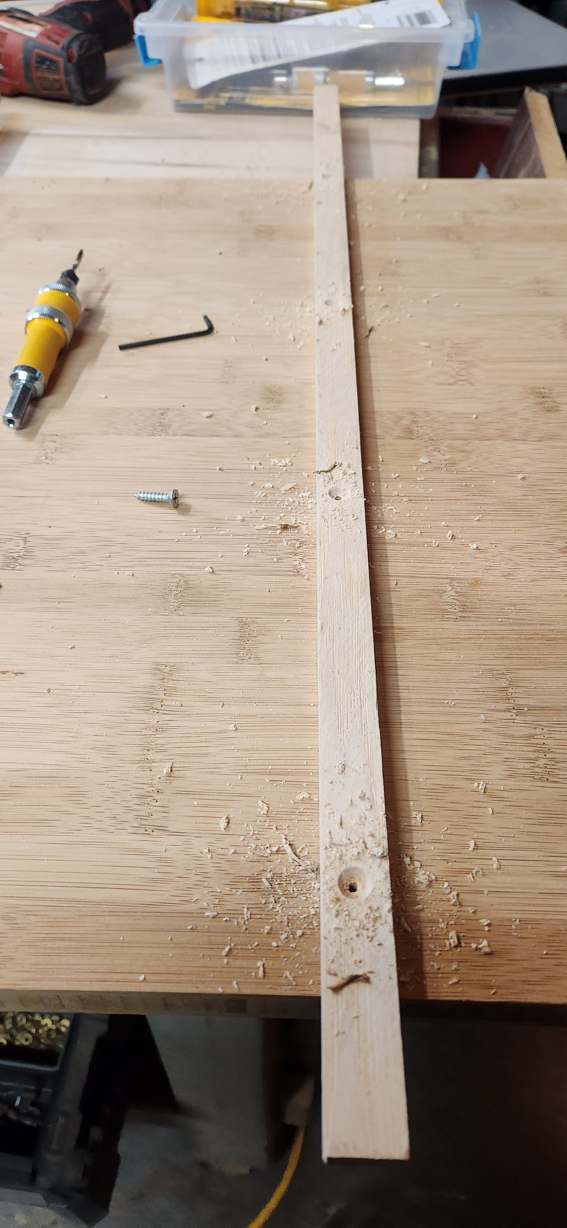

Let's a sled

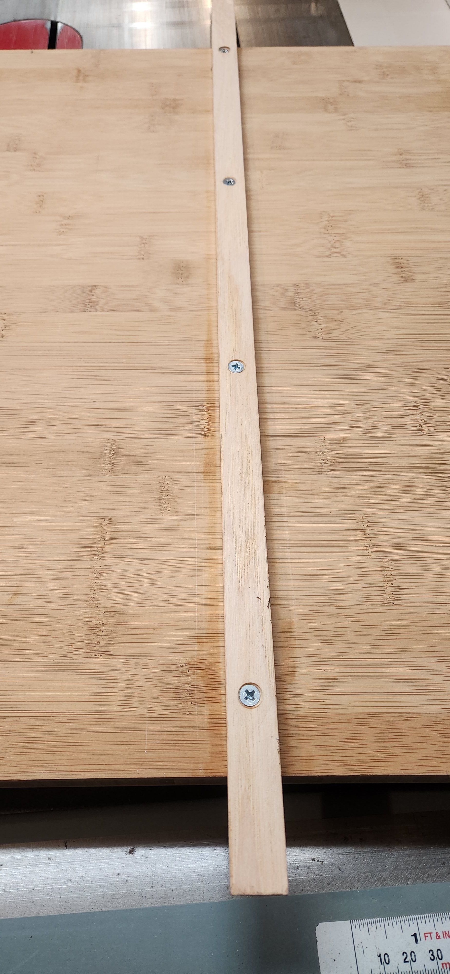

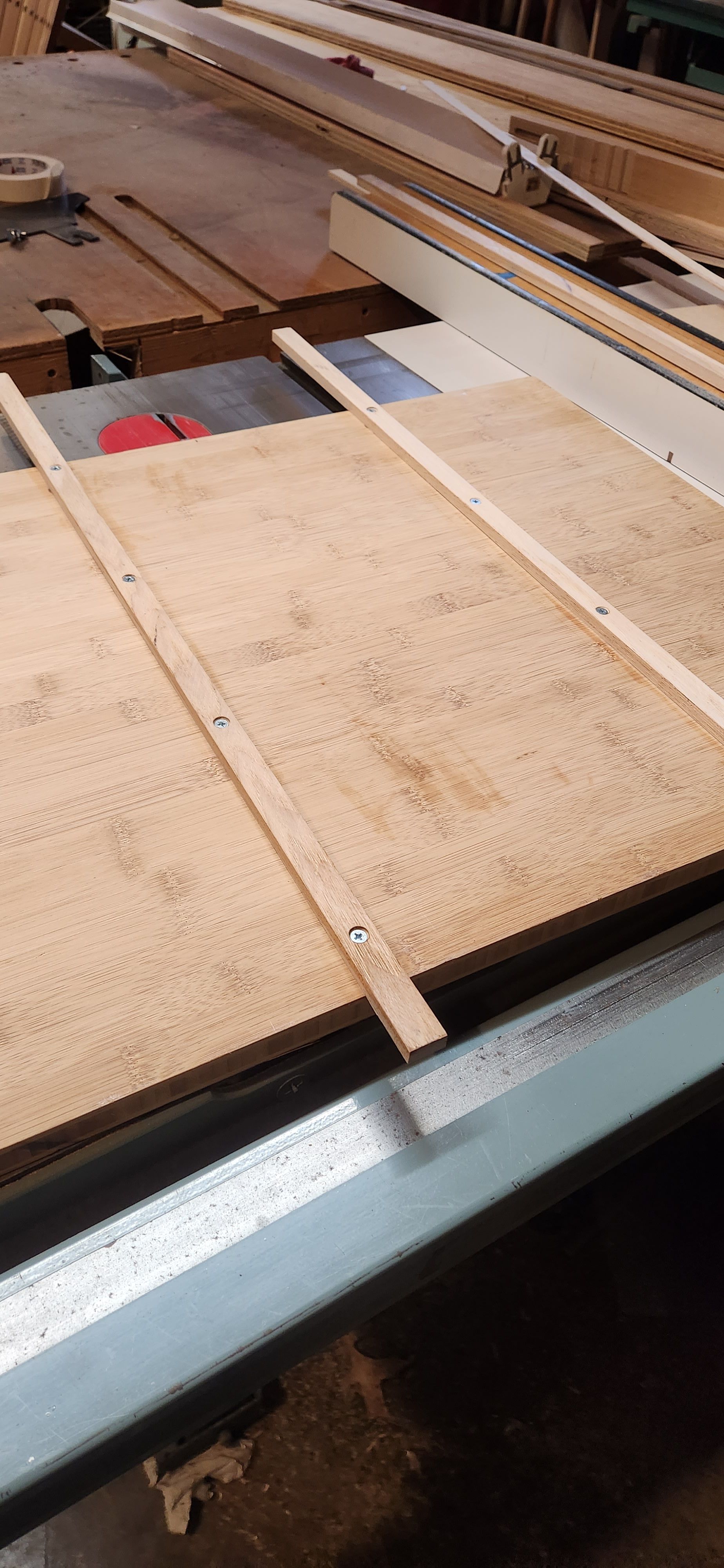

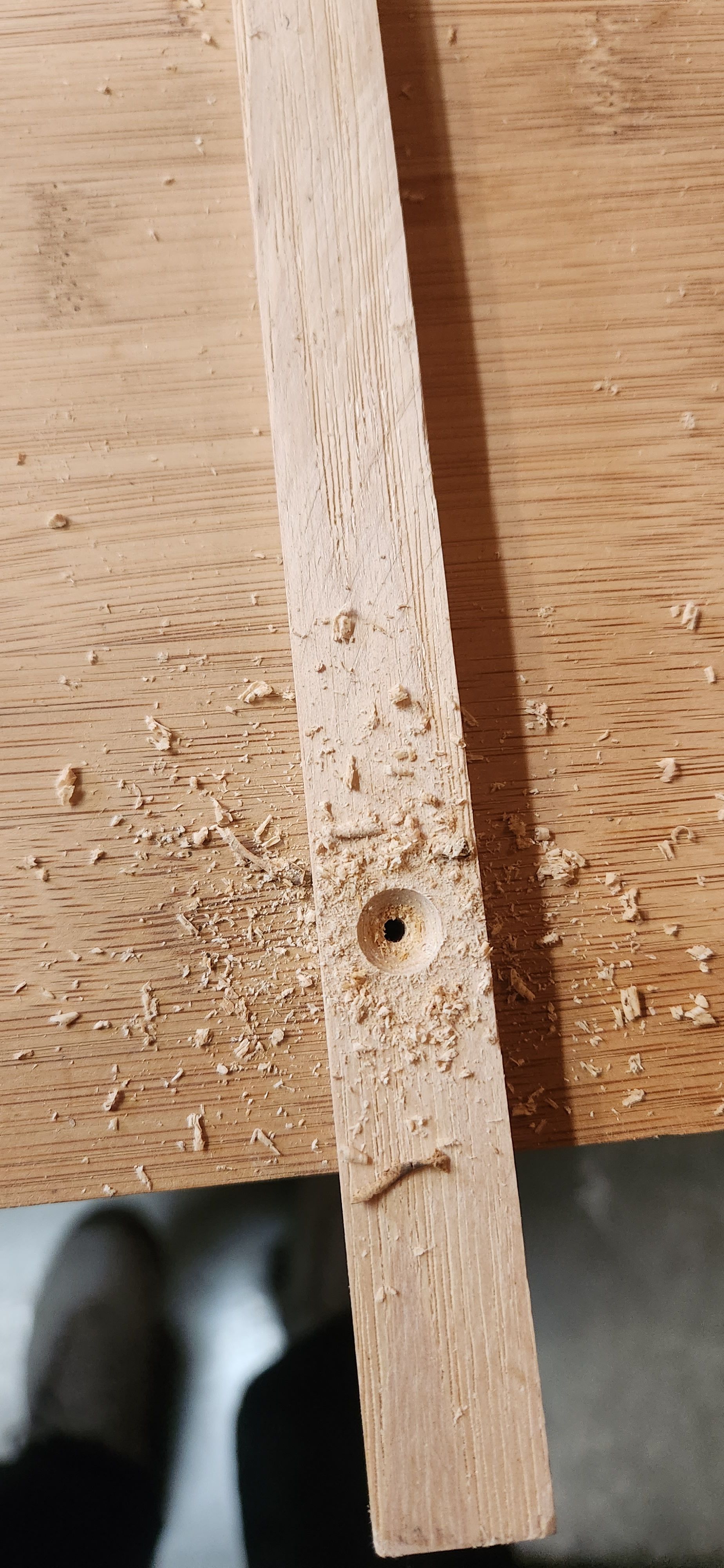

I have Bamboo around the shop. It's a very study material. I will cut a piece or two of hickory. I will test this several times before I’m happy with the fit..

I like the double runners. Really improves the accuracy/stability. Never used bamboo but I have seen cutting boards made from it.
My basement shop can vary in humidity from summer to winter. Does hickory change much with humidity?

For 2 sleds I have, that require the most precision, I used steel runners that perfectly fit the miter slot on the table saw. Expensive. I like the sealing idea. Have to try it.

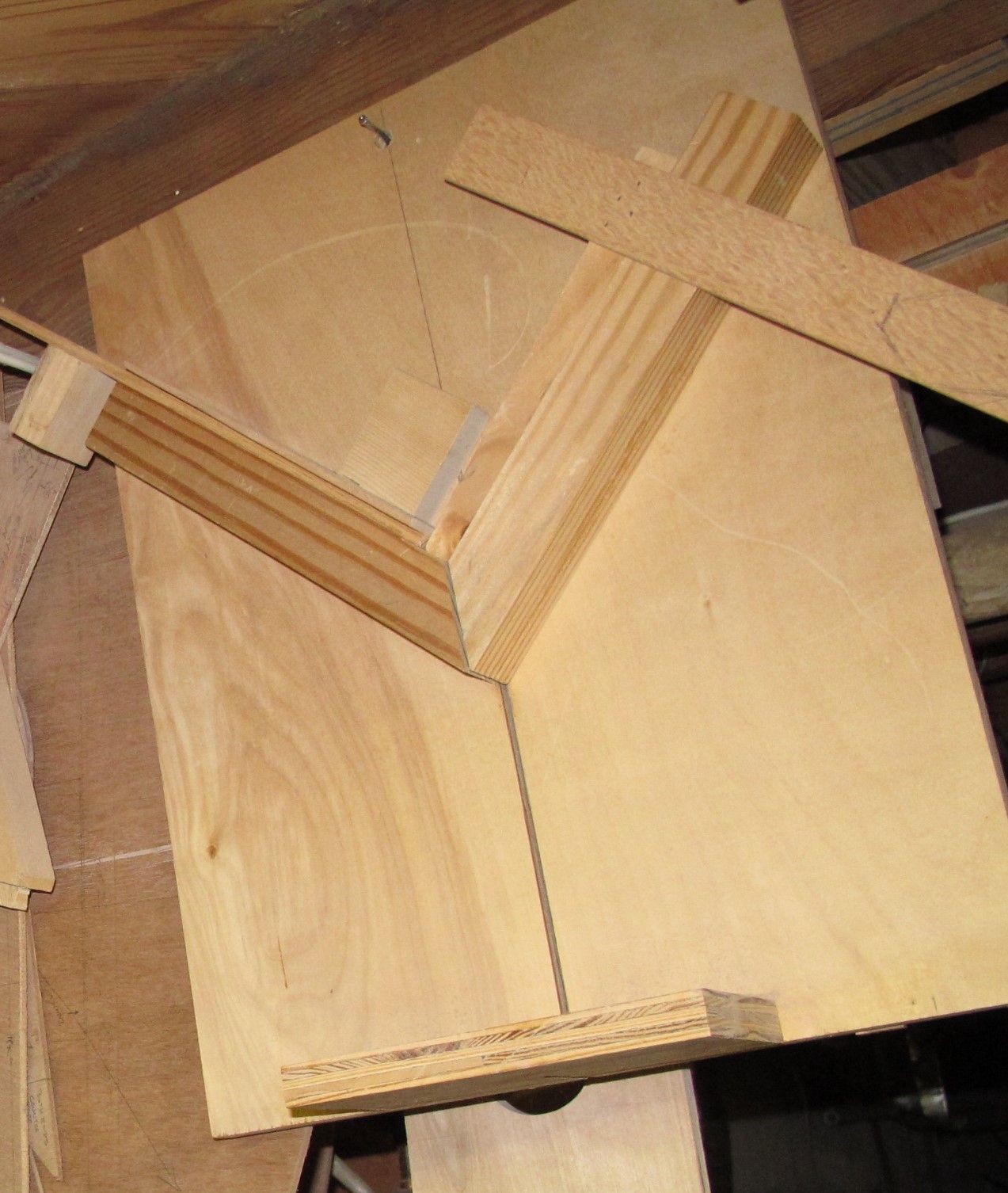

My picture frame sled with a couple of adjustable legs for repeatable lengths. Cut all angles for one end of each piece on one side of the jig. Then cut the pieces to the correct length/angle on the opposite side of the jig. This method creates perfect miter joints.

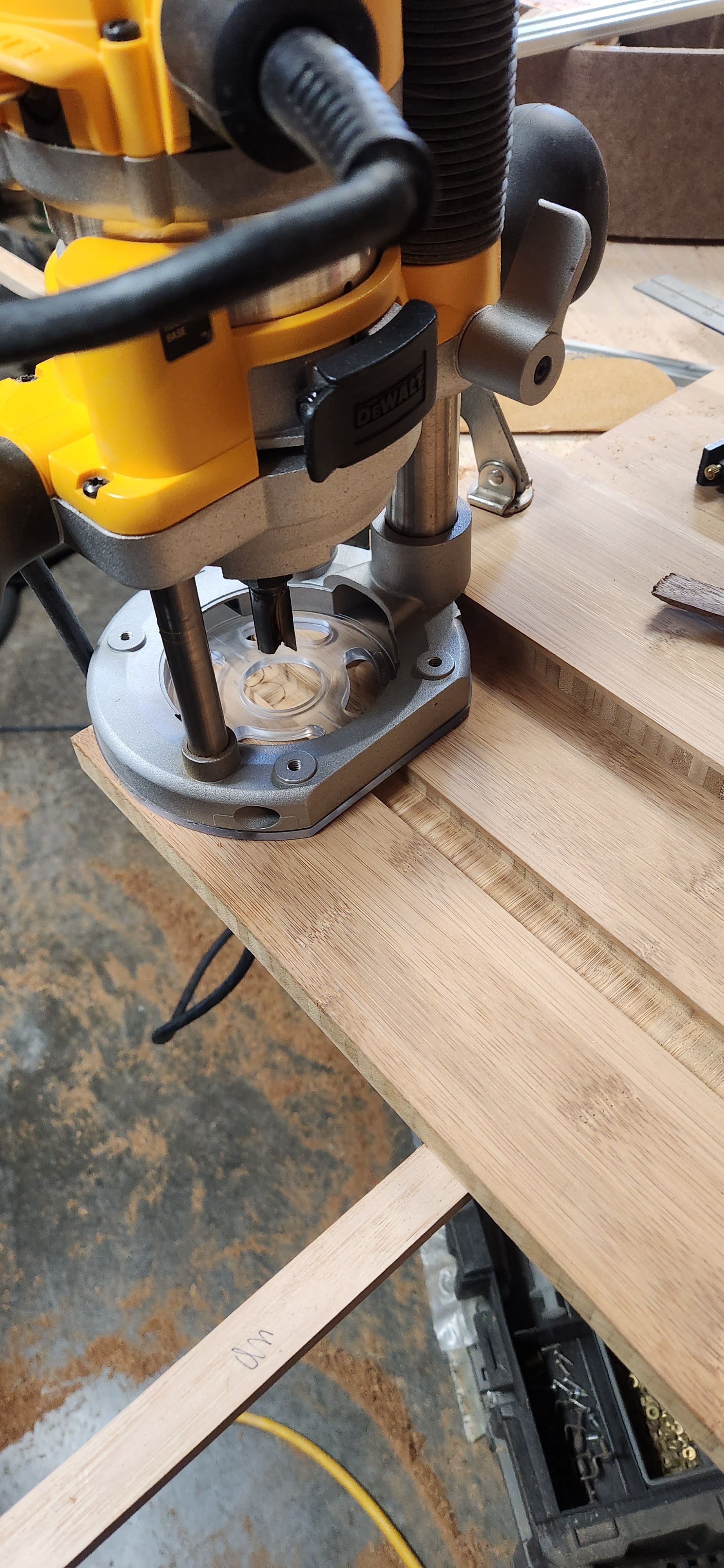

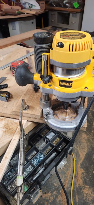

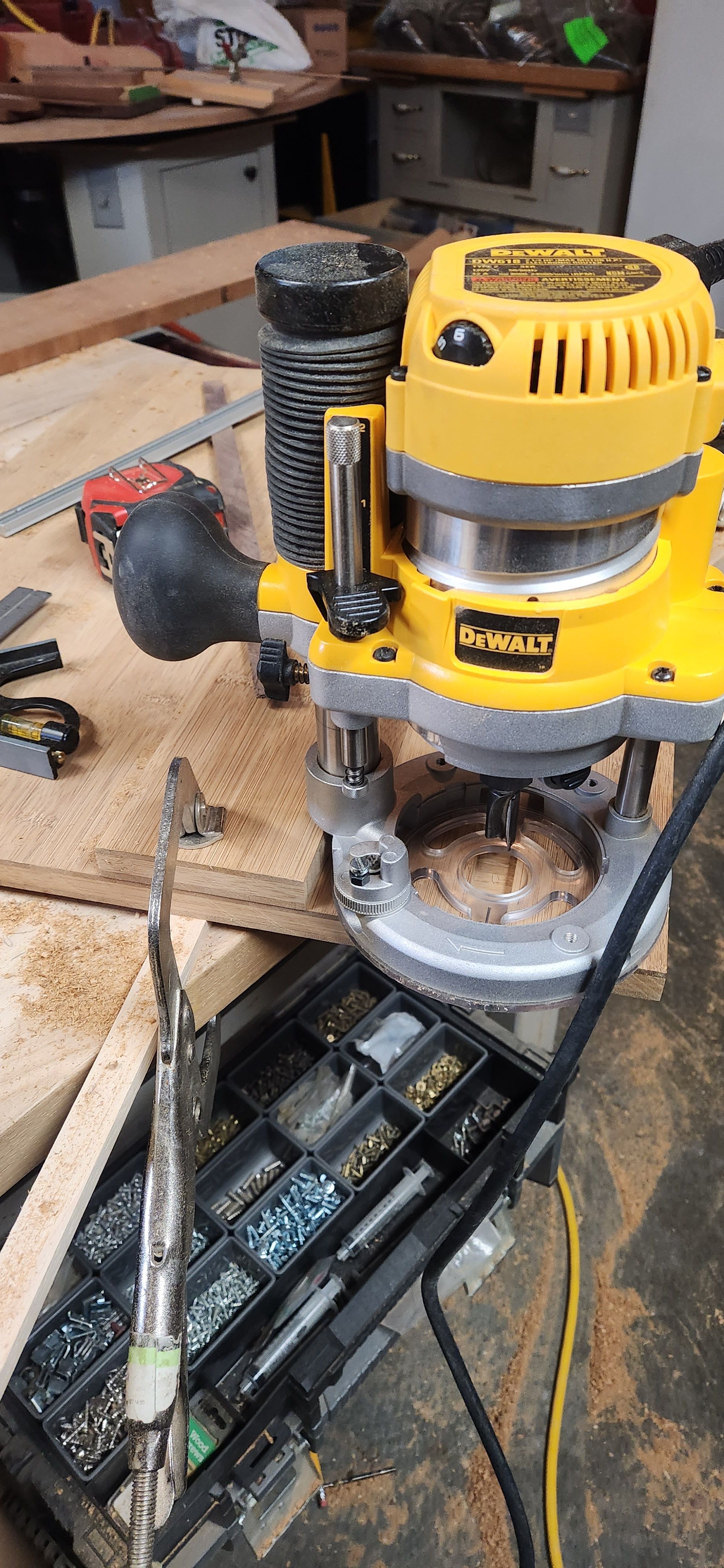

My DW625 router  was too big for this, so I used a 618.I try and use Amana router bits.I don’t remember if this bit had been sharpened yet, but I have route to fit anyway..

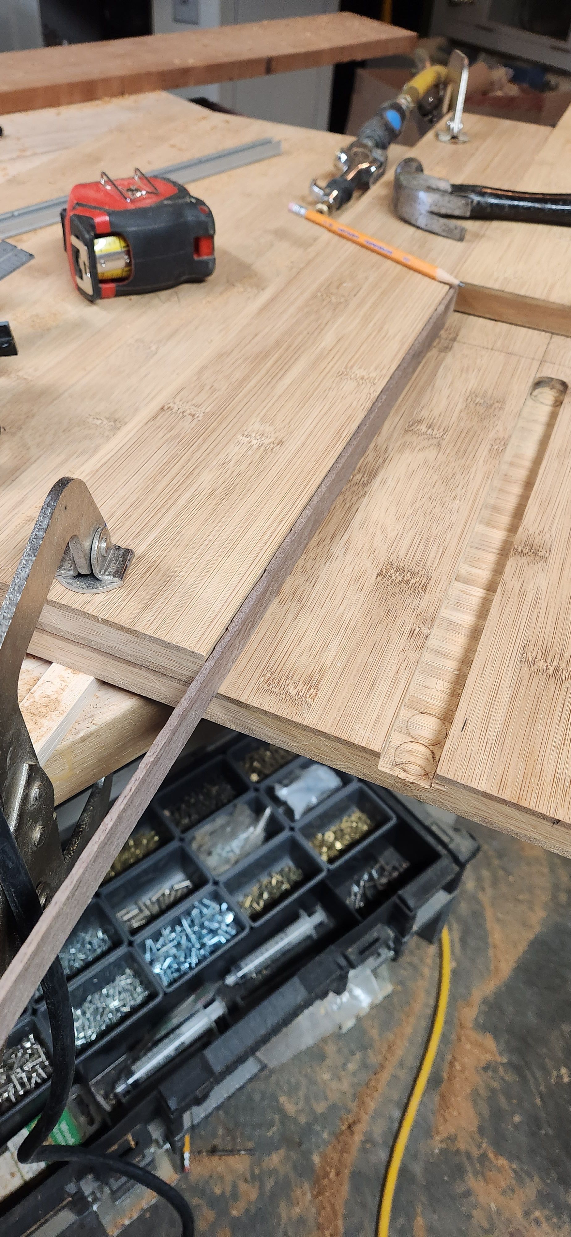

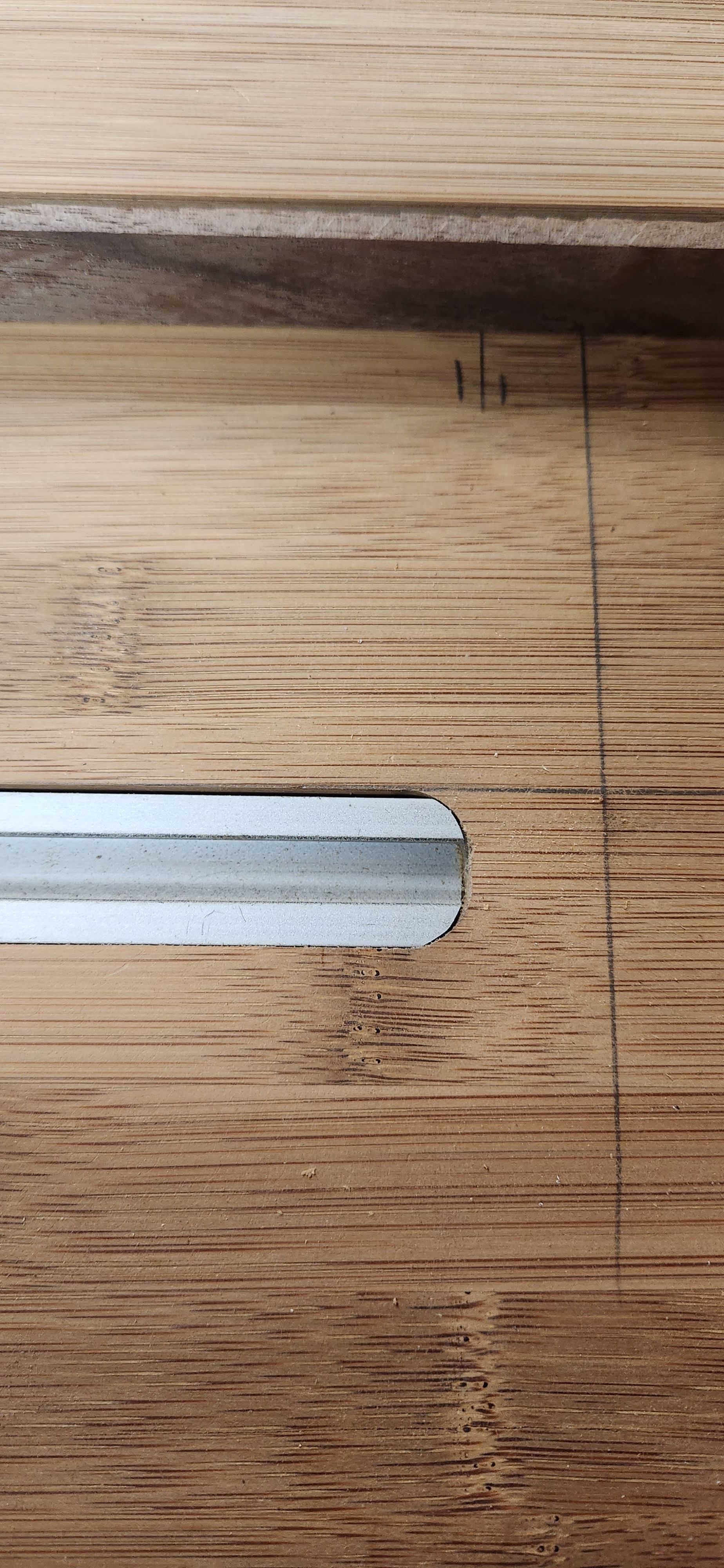

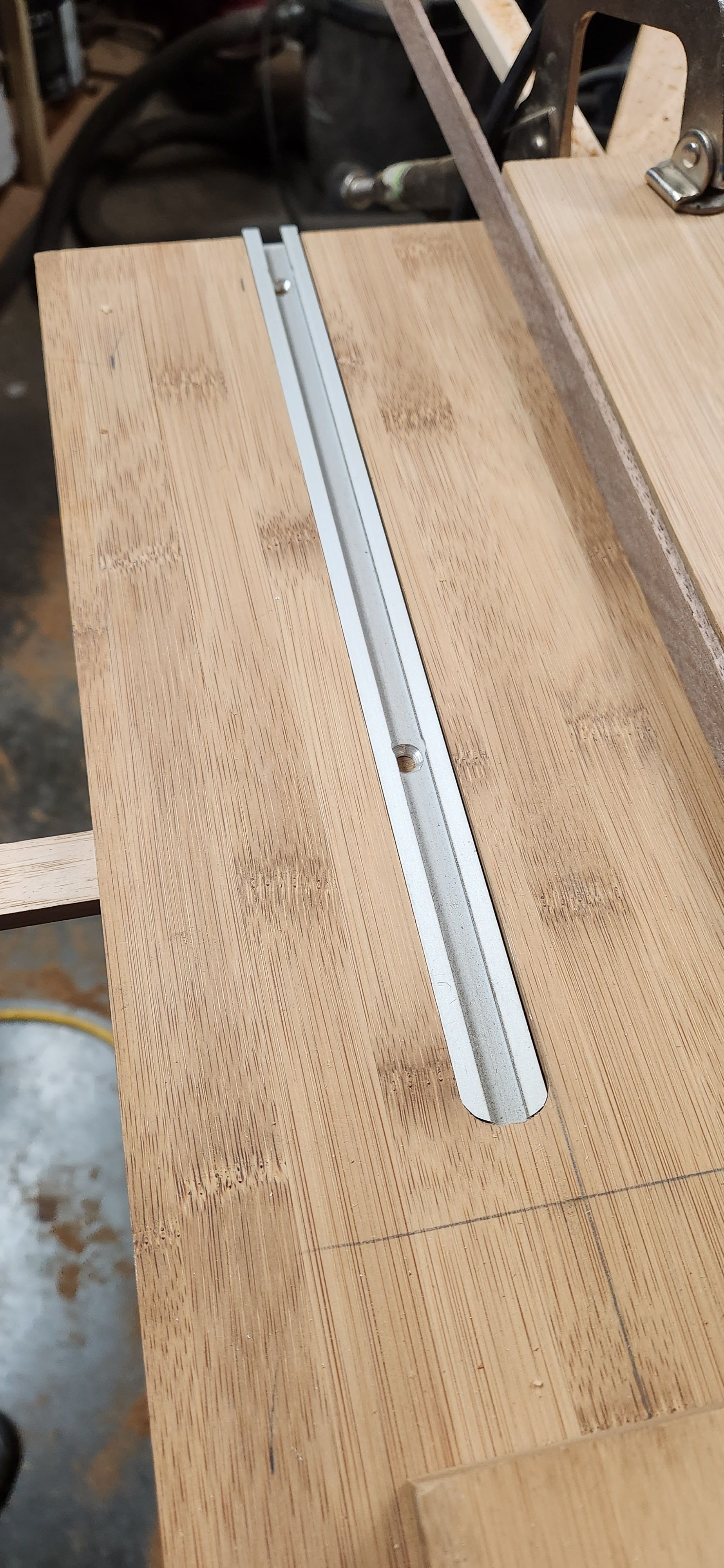

Cutting the slot. I will add a shim to get the correct width..

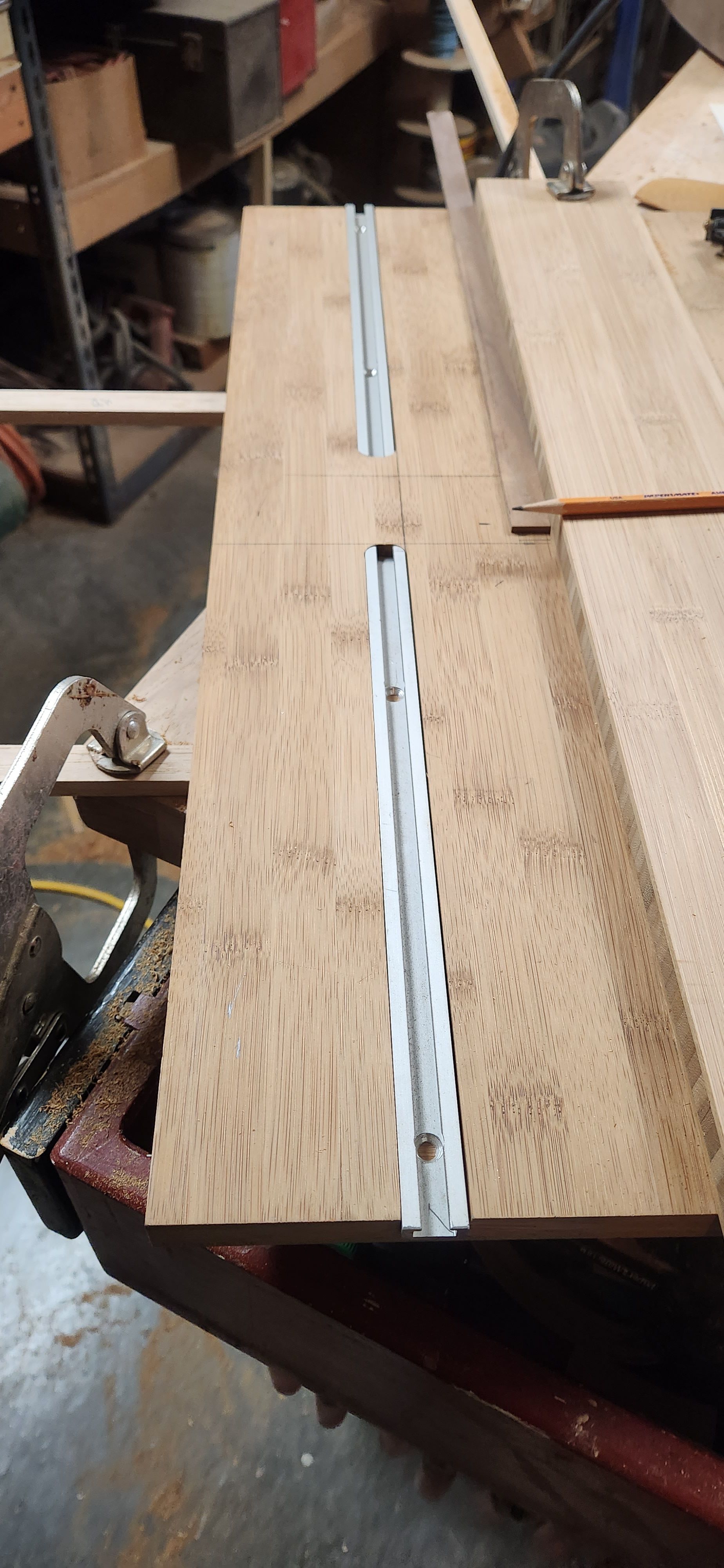

What's the purpose of the "metal" insert in the last image?
To be continued….
It will all make sense soon.
Edited by BillyJack

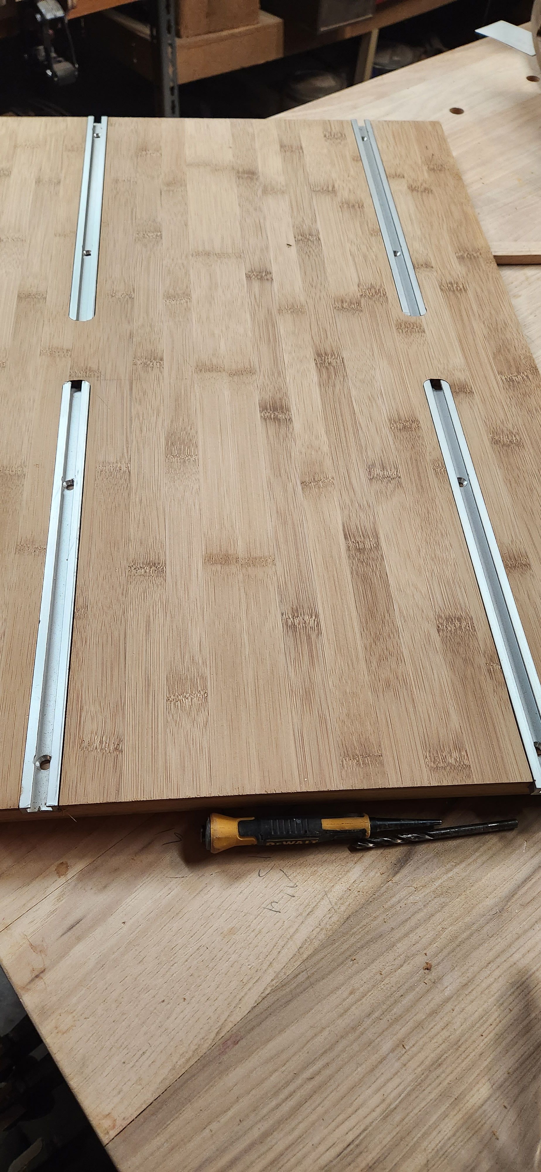

4 pieces of metal track in a piece of bamboo plywood.
Edited by BillyJack
46 minutes ago, BillyJack said:
How about some details on what you are doing for the rest of us hobbyist.
The pictures provided will answer any questions to be asked.,
