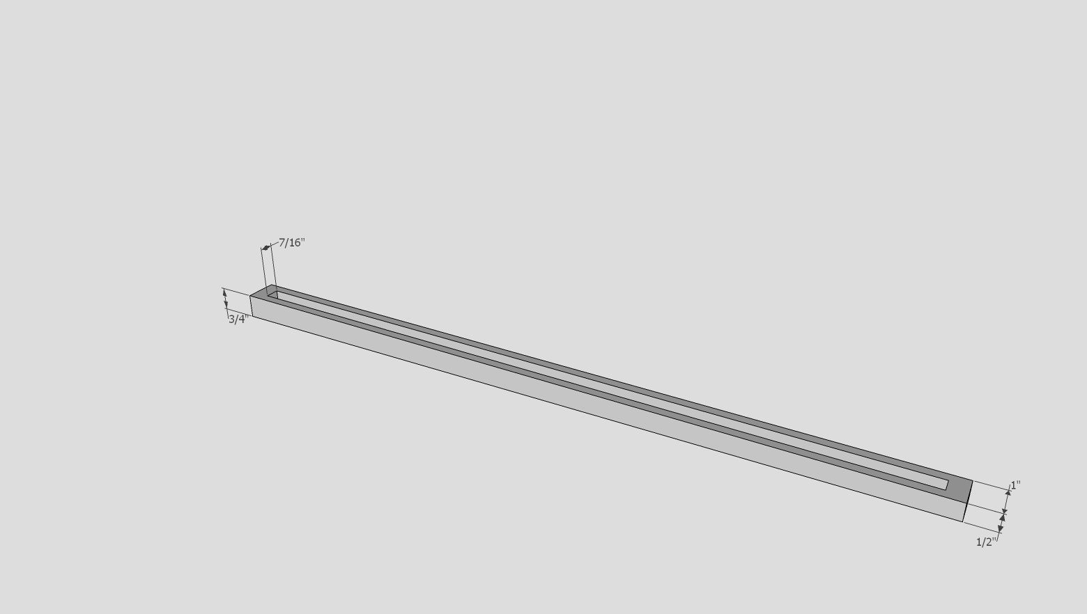

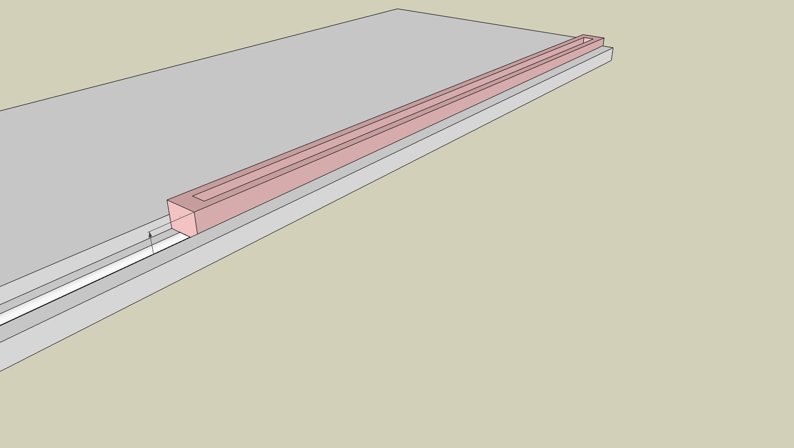

Got to thinking about the width of the plywood lip (red arrow). Made it a bit wider so it would be less likely to split off. Also I used cabinet grade plywood dimensions for the thickness of the piece (3/4")
I'd make the first dado cut at "A" and remove 7/16" of material. The raise the blade and make the second cut at "B" and remove 3/8" of material. The finally route the trough at "C" with a 3/8" diameter half round bit.
The attaching leaf edge would be a mirrored profile but without the trough.
Hope that makes sense.
Sure does and I need to be careful to match 3/4 to T and 3/8 to 1/2T and I can step the cove bit down at the ends to facilitate draining.  Thanks
Much and now to go make some simple pieces to make sure it all works.
