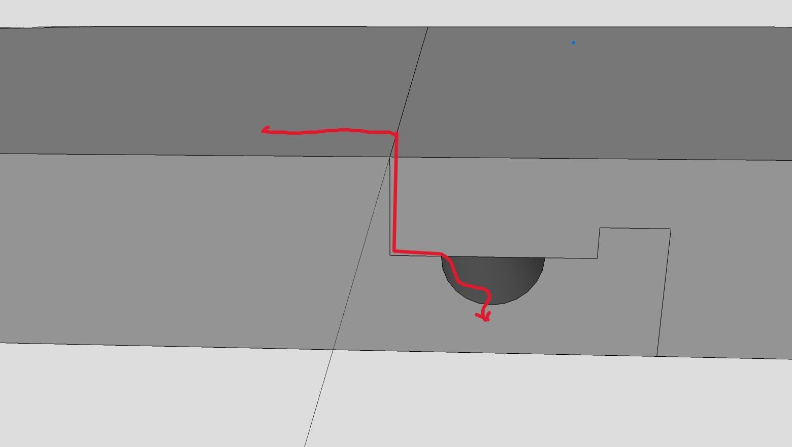

lew Posted February 21 Report Posted February 21 I wonder if something like this would work, if I'm understanding what you are trying to do. The pieces would lock together and overlap. Liquid would be caught in the "lower tray" and the routed channel would carry it away. DuckSoup and Headhunter 2 Quote

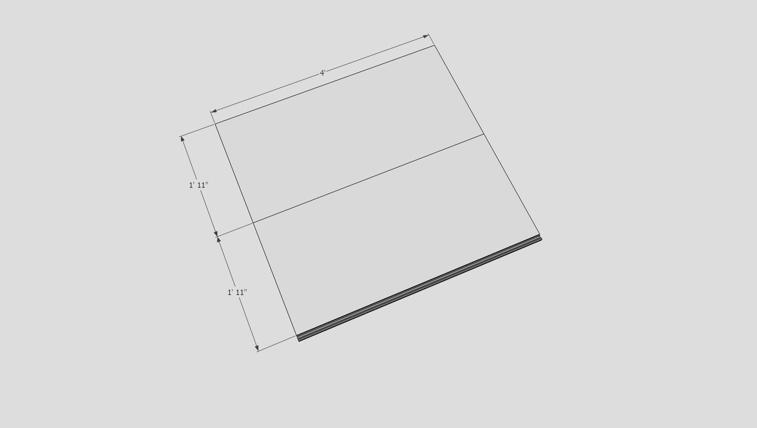

lew Posted February 21 Report Posted February 21 I should have put dimensions on the drawings. The channels do run across and out of the edges. I think I still don't understand about the tubing. The interlock on the extension leaves would trap any water from the surface by channeling it down through the joint and into the routed "U" shaped channel. Directing the liquid out to the sides. Any liquid in the channel cannot leak through because of the shape of the interlocking board. Maybe I'm way off base and not understanding your idea. I can be pretty dense sometimes DuckSoup 1 Quote
Michael Thuman Posted February 21 Author Report Posted February 21 31 minutes ago, lew said: I should have put dimensions on the drawings. The channels do run across and out of the edges. I think I still don't understand about the tubing. The interlock on the extension leaves would trap any water from the surface by channeling it down through the joint and into the routed "U" shaped channel. Directing the liquid out to the sides. Any liquid in the channel cannot leak through because of the shape of the interlocking board. Maybe I'm way off base and not understanding your idea. I can be pretty dense sometimes i think this works if there is no tubing with your drawing update I can see a well now how to tilt the well from the center to the ends to get the water to flow outward? lew 1 Quote
Michael Thuman Posted February 21 Author Report Posted February 21 2 minutes ago, Michael Thuman said: i think this works if there is no tubing with your drawing update I can see a well now how to tilt the well from the center to the ends to get the water to flow outward? Is the profile without the semi round recess a drawer lock router bit? lew 1 Quote

lew Posted February 21 Report Posted February 21 I didn’t consider that. There might be a router bit that could work. My first thought was to create the shape with a table saw and dado blade an then use a cove box routers bit to create the half round channel Headhunter and DuckSoup 2 Quote
Michael Thuman Posted February 21 Author Report Posted February 21 24 minutes ago, Michael Thuman said: Is the profile without the semi round recess a drawer lock router bit? Or is this a lap joint with dado grooves that from the interlock. Quote
Michael Thuman Posted February 21 Author Report Posted February 21 13 minutes ago, lew said: I didn’t consider that. There might be a router bit that could work. My first thought was to create the shape with a table saw and dado blade an then use a cove box routers bit to create the half round channel is this a half lap joint then cove bit. I see the dado grooves but do you have any dimensions that work with 3//4 ply or matching oak? Quote

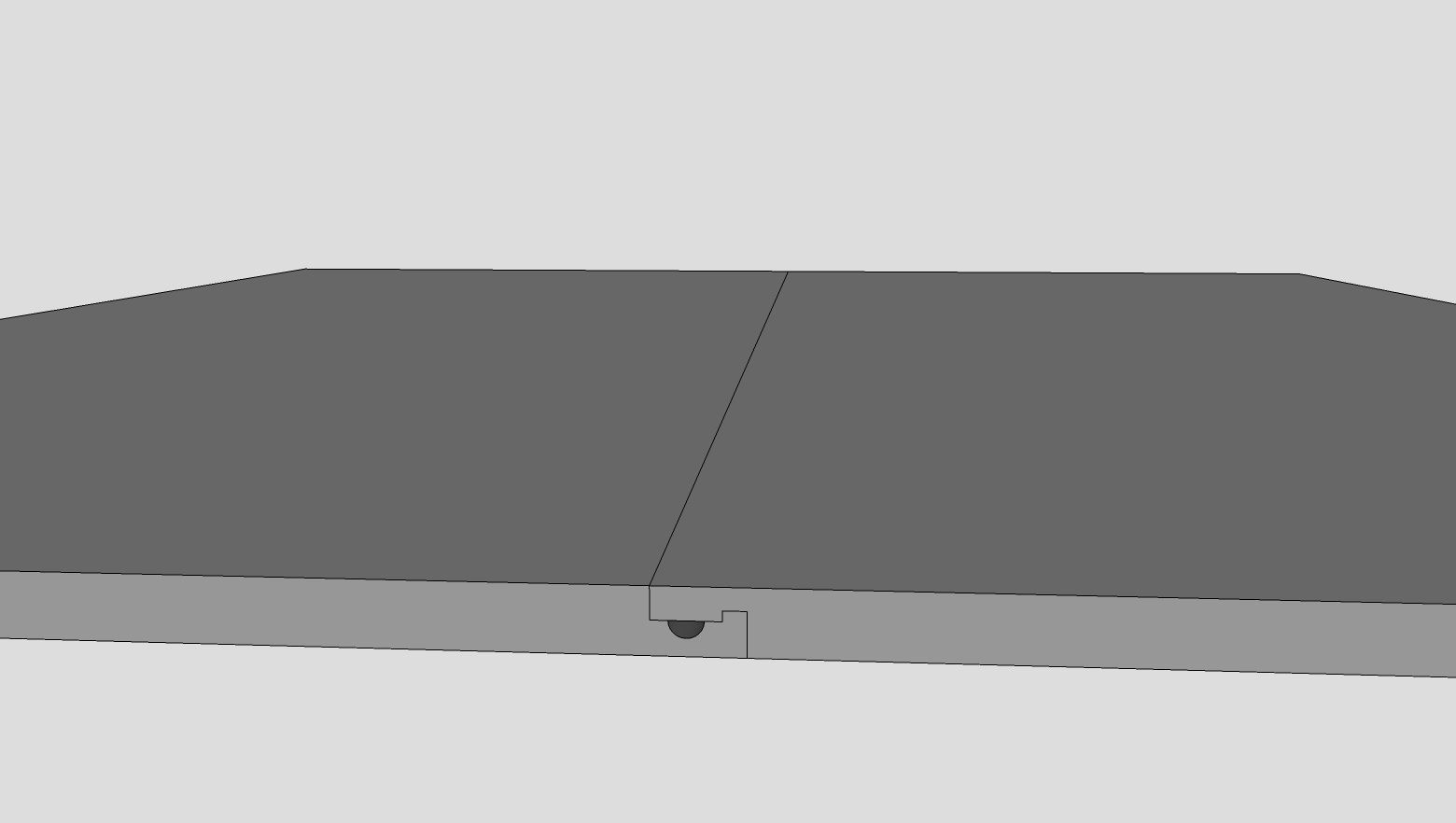

lew Posted February 22 Report Posted February 22 Got to thinking about the width of the plywood lip (red arrow). Made it a bit wider so it would be less likely to split off. Also I used cabinet grade plywood dimensions for the thickness of the piece (3/4") I'd make the first dado cut at "A" and remove 7/16" of material. The raise the blade and make the second cut at "B" and remove 3/8" of material. The finally route the trough at "C" with a 3/8" diameter half round bit. The attaching leaf edge would be a mirrored profile but without the trough. Hope that makes sense. Headhunter and DuckSoup 2 Quote
