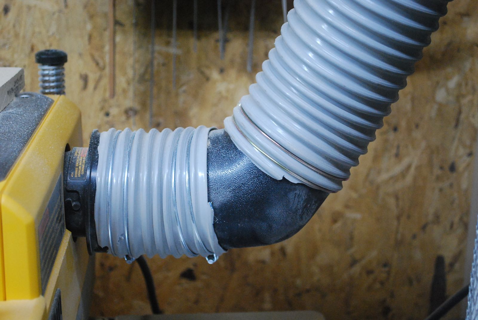

January 23, 20251 yr Popular Post I didn't like the way the chip collector hose adapter came straight out over the outfeed table. Materials were always catching on the hose. Turned a wooded adapter and used a 90° elbow to change the way the hose positioned.

January 23, 20251 yr 18 hours ago, lew said: I didn't like the way the chip collector hose adapter came straight out over the outfeed table. Materials were always catching on the hose. Turned a wooded adapter and used a 90° elbow to change the way the hose positioned. Had the same concerns when I first got mine. Solved the problem!
January 23, 20251 yr I don’t know why I always overthink everything. I like the 45 better than the 90
