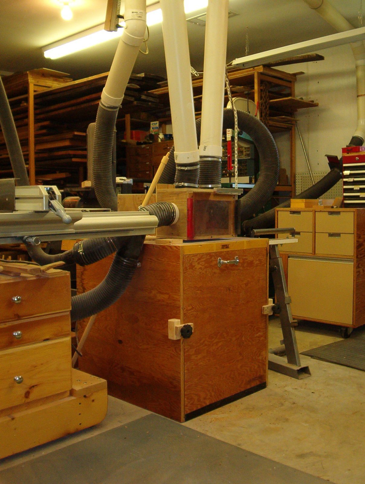

Gerald Posted December 4, 2024 Report Posted December 4, 2024 I have changed so much in my dust collection it would take a lot of space to tell it. Mine is a Grizzly and it is over 25 years in service. Usually have it on all the time I am in the shop and just open and close gates. First I had a home made box and finally still keeping that box in place I added a Dust Deputy with 5 inch pipe up to the DC in attic.This saves a lot of climbing into the attic to empty bags. That 5 inch hose alone increased suction considerably. This is the Box with lots of pipe as this is a central unit. Grandpadave52, lew and HARO50 3 Quote

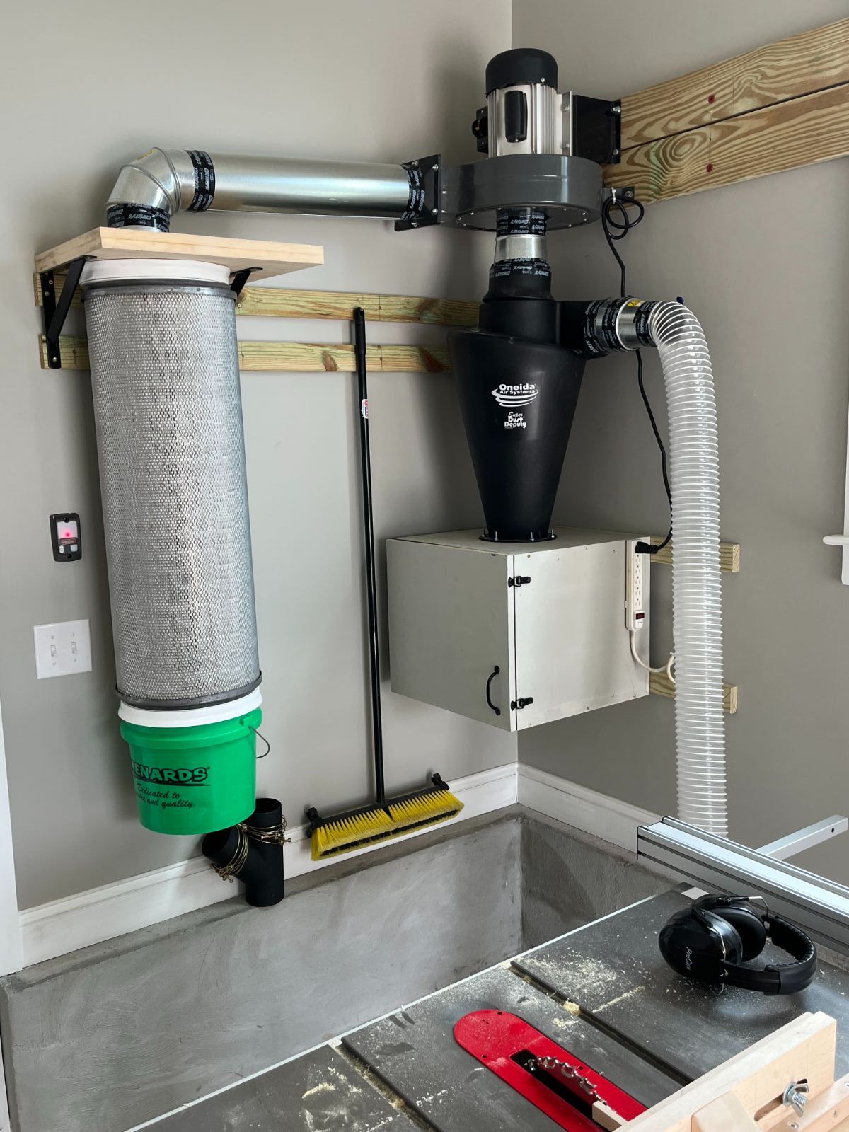

JimM Posted December 4, 2024 Report Posted December 4, 2024 My shop is pretty small, so I'm trying to get as much off the floor as possible. The DC started life as the HF model, modified with an Oneida separator and a Wynn filter. It's patterned after one seen here on TPW, but I don't recall the original designer. Grandpadave52, User74, HARO50 and 1 other 4 Quote

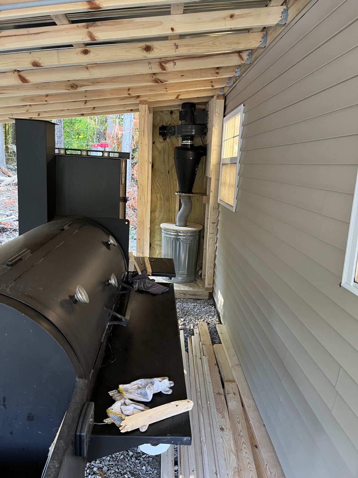

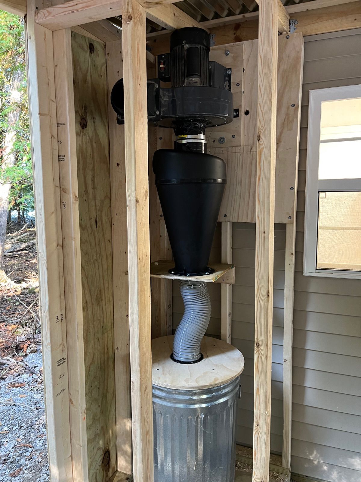

Popular Post Gordon Posted December 4, 2024 Popular Post Report Posted December 4, 2024 Great score, nothing beats free. My shop is relatively small as well. I found a used HF dust collector and decided to put it outside. So glad I did, it saves so much space inside and is very quiet. JimM, HARO50, Grandpadave52 and 2 others 5 Quote
Danl Posted December 4, 2024 Report Posted December 4, 2024 (edited) 2 hours ago, JimM said: My shop is pretty small, so I'm trying to get as much off the floor as possible. The DC started life as the HF model, modified with an Oneida separator and a Wynn filter. It's patterned after one seen here on TPW, but I don't recall the original designer. Here is the original post. Small foot print, mobile, 115 volt, great filtration. Danl Edited December 4, 2024 by Danl lew, JimM, Grandpadave52 and 1 other 3 1 Quote

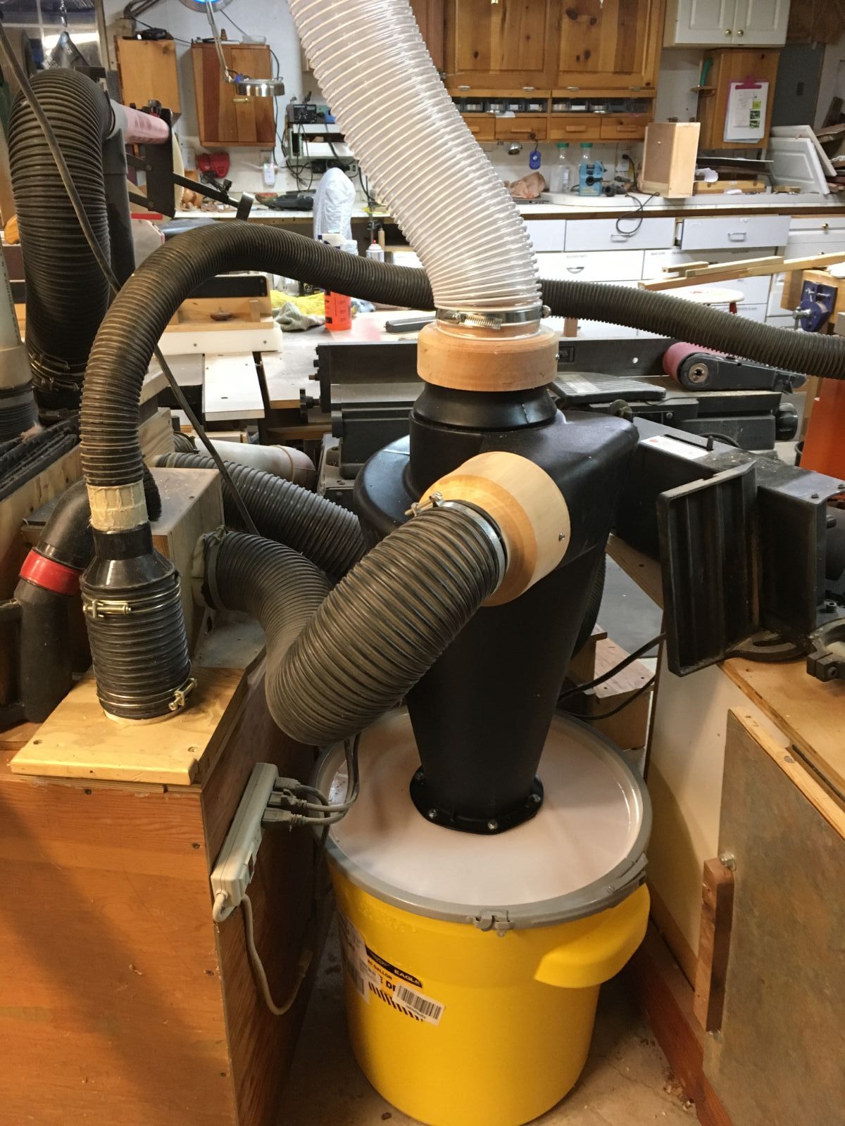

Popular Post User74 Posted December 4, 2024 Popular Post Report Posted December 4, 2024 I have the same one from HF. I haven't been able to get it out up yet but I made the impeller upgrade which is supposed to make it more "sucky". Lol I plan on trying to get it going within the next few months. As if the present I'm using a shop vac with a dust deputy on a 5 gallon bucket and just move it to which ever machine I need to use. There's several videos on YouTube on how to juice up this collector for better efficiency. HARO50, Headhunter, Gerald and 3 others 6 Quote

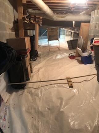

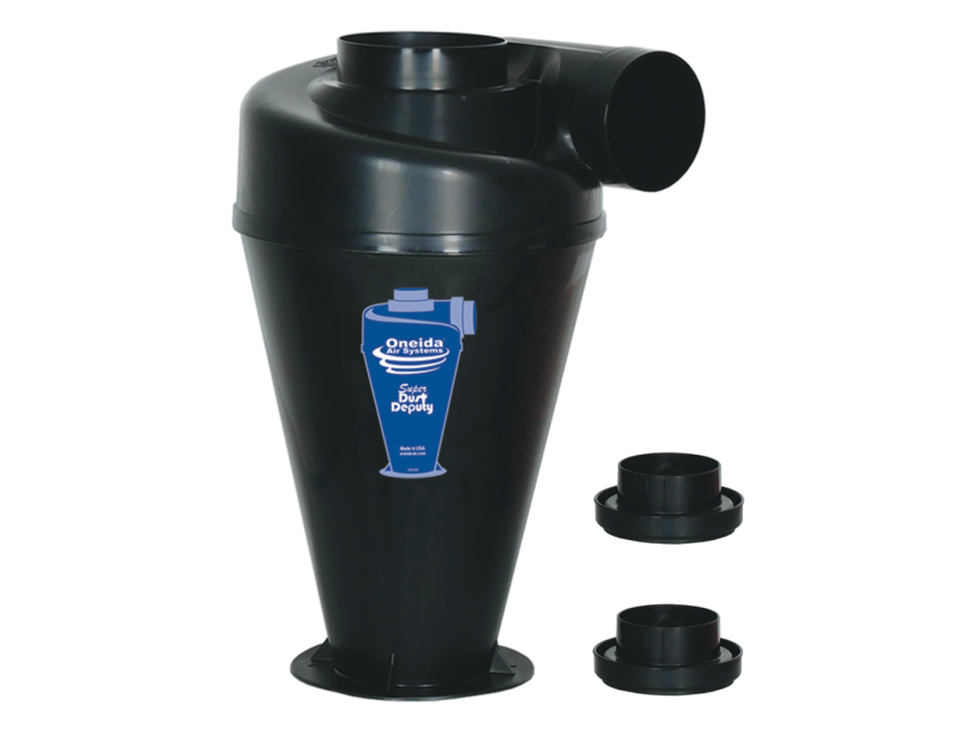

Lost Oki Posted December 25, 2024 Author Report Posted December 25, 2024 (edited) Thanks for the reply's and idea's. My main concern about installing under house is how much dust is going to escape thru the cloth filter. My previous experience with dust collectors has been in manufacturing and there is always a little dust residue around the cloth bags. My Heat and air unit is under the house in what is referred to as crawl space, but mine is actually walk space and it is encapsulated. I actually use for storage and winter archery range. I also noticed that some of you have a black cone attached above the collection container? Any info on that would be appreciated. Edited December 25, 2024 by Lost Oki lew and Grandpadave52 2 Quote
JimM Posted December 25, 2024 Report Posted December 25, 2024 If you’re asking about this, it’s the Oneida dust deputy. It’s a separator for collecting the larger chips. Grandpadave52, HARO50, lew and 1 other 4 Quote
Danl Posted December 25, 2024 Report Posted December 25, 2024 Attaching a separator is what makes the system a 2-stage system. When using the separator and a good filter, you will have very little fine-dust escape. The filter which comes with the Harbor Height systems allow a large amount of dust to escape. Danl lew, JimM, Grandpadave52 and 1 other 4 Quote
