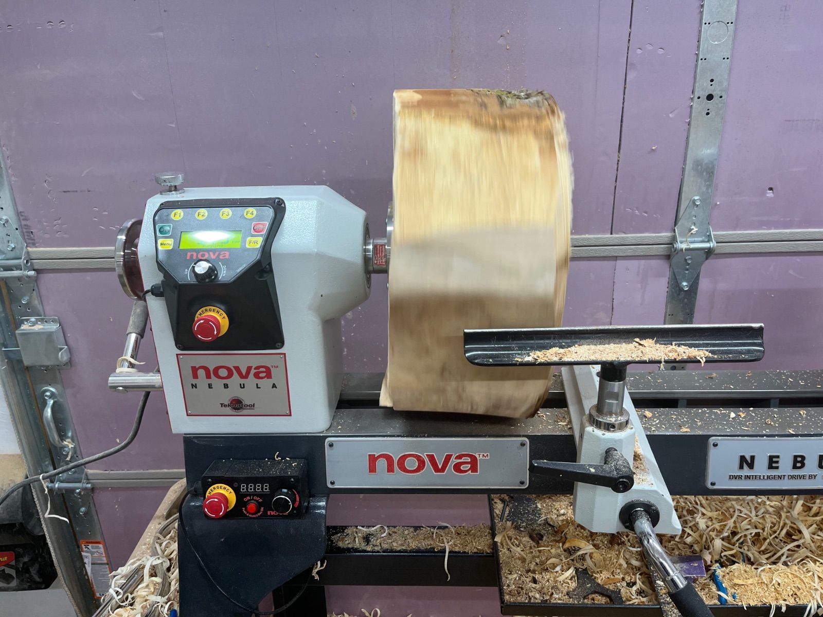

Popular Post Gordon Posted October 28, 2024 Author Popular Post Report Posted October 28, 2024 Got a chance to put that big hunk of maple on the lathe yesterday. I Han planned to take more pictures but with the intimidation or nervousness and a little excitement I only got these 3. This is by far the heaviest piece I’ve done. for me it was too big and heavy to safely balance on my bandsaw so I “rounded” it with the chainsaw. it was so out of balance I started turning at 175 rpm’s. I was very excited to find all the marking inside this wood. I think it’s going to be a beautiful piece. I don’t know how accurate my moisture meter is but it says it’s 60% water, as heavy as it is I have a tendency to believing it. Another bit of surprise to me is the dark half (which has some crotch grain) is heavier so even being round it was slow going. I now have the end grain coated with Anchor Seal and it will rest through the winter. lew, Headhunter, Fred W. Hargis Jr and 5 others 4 4 Quote
lew Posted October 28, 2024 Report Posted October 28, 2024 2 minutes ago, Gordon said: Got a chance to put that big hunk of maple on the lathe yesterday. I Han planned to take more pictures but with the intimidation or nervousness and a little excitement I only got these 3. This is by far the heaviest piece I’ve done. for me it was too big and heavy to safely balance on my bandsaw so I “rounded” it with the chainsaw. it was so out of balance I started turning at 175 rpm’s. I was very excited to find all the marking inside this wood. I think it’s going to be a beautiful piece. I don’t know how accurate my moisture meter is but it says it’s 60% water, as heavy as it is I have a tendency to believing it. Another bit of surprise to me is the dark half (which has some crotch grain) is heavier so even being round it was slow going. I now have the end grain coated with Anchor Seal and it will rest through the winter. That's gonna be a pretty bowl!! Grandpadave52, DuckSoup and Headhunter 3 Quote
Fred W. Hargis Jr Posted October 28, 2024 Report Posted October 28, 2024 Indeed, there's a lot of character in that piece! DuckSoup, Headhunter and Grandpadave52 3 Quote
Grandpadave52 Posted October 28, 2024 Report Posted October 28, 2024 The grain and color contrast is amazing. Looking forward to seeing this again in the spring. DuckSoup and Fred W. Hargis Jr 2 Quote
DuckSoup Posted October 29, 2024 Report Posted October 29, 2024 +1 with all the above, that should finish really nice. Grandpadave52 1 Quote
