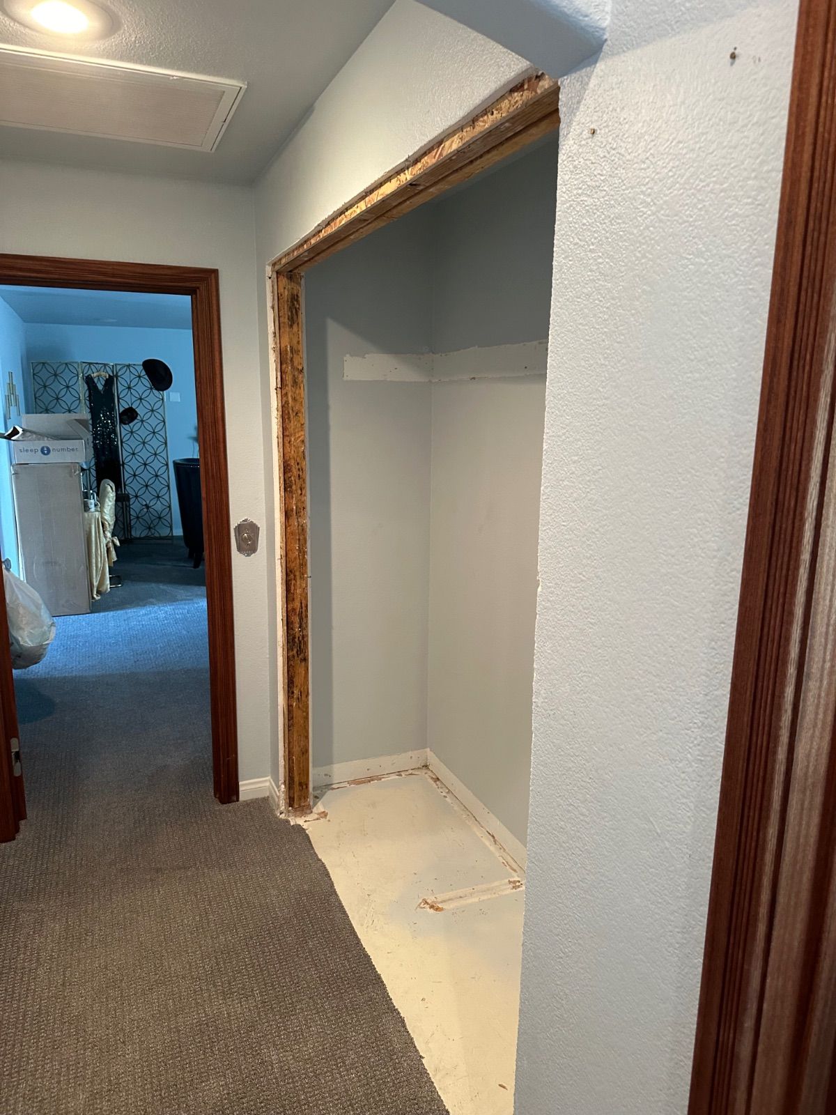

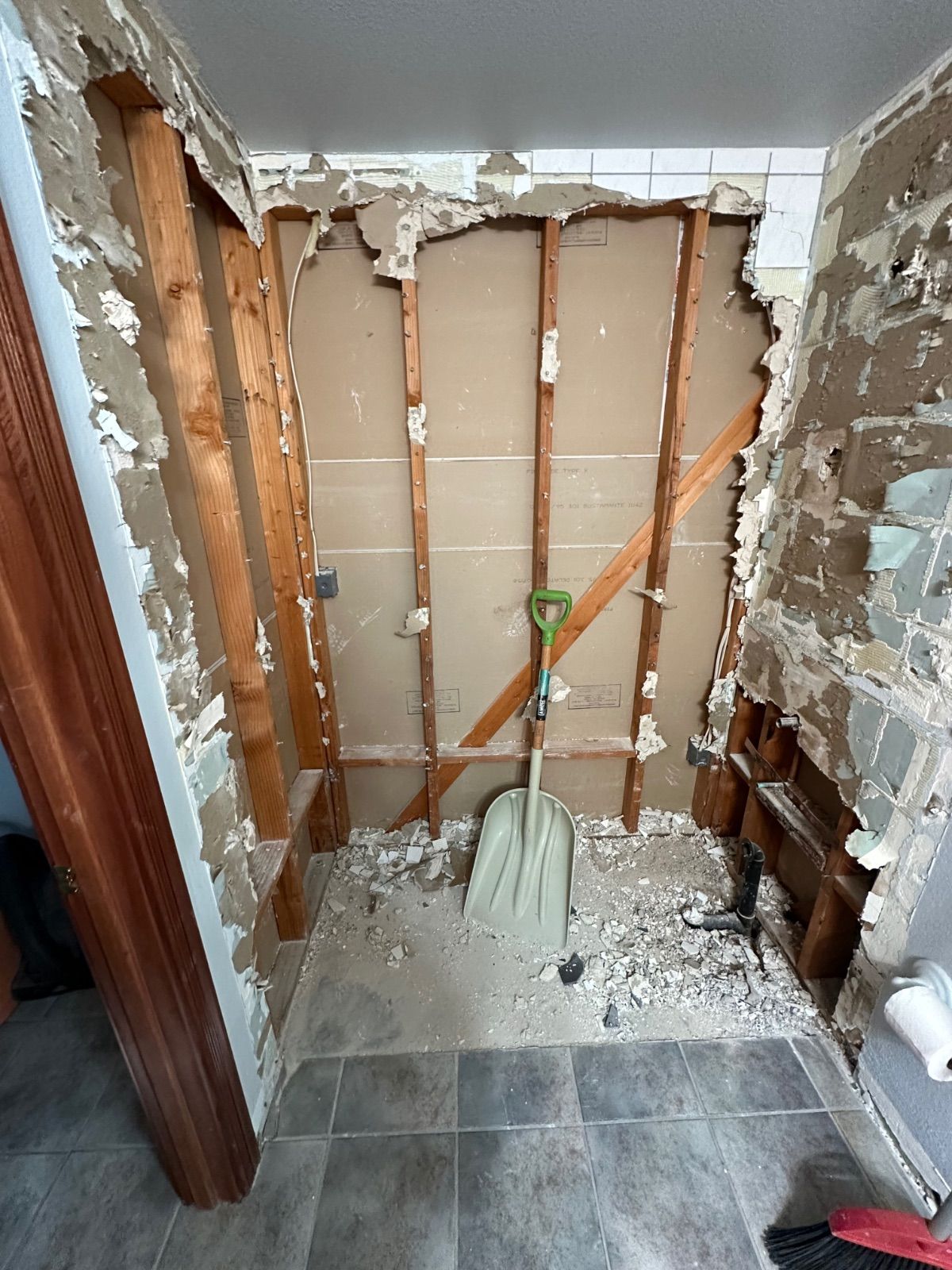

Popular Post Masonsailor Posted August 30, 2024 Author Popular Post Report Posted August 30, 2024 Well today was demo day. All cleaned out and ready for cabinets. Paul Fred W. Hargis Jr, lew, Artie and 6 others 9 Quote
lew Posted August 31, 2024 Report Posted August 31, 2024 ...and no damage to the drywall, good job! Al B, Grandpadave52 and HARO50 3 Quote
Popular Post Masonsailor Posted August 31, 2024 Author Popular Post Report Posted August 31, 2024 All cleaned up ! Paul Artie, Al B, Grandpadave52 and 2 others 5 Quote
Grandpadave52 Posted August 31, 2024 Report Posted August 31, 2024 Demo and cleanup are the worse parts. Now the fun work begins. HARO50, Artie, Al B and 1 other 4 Quote

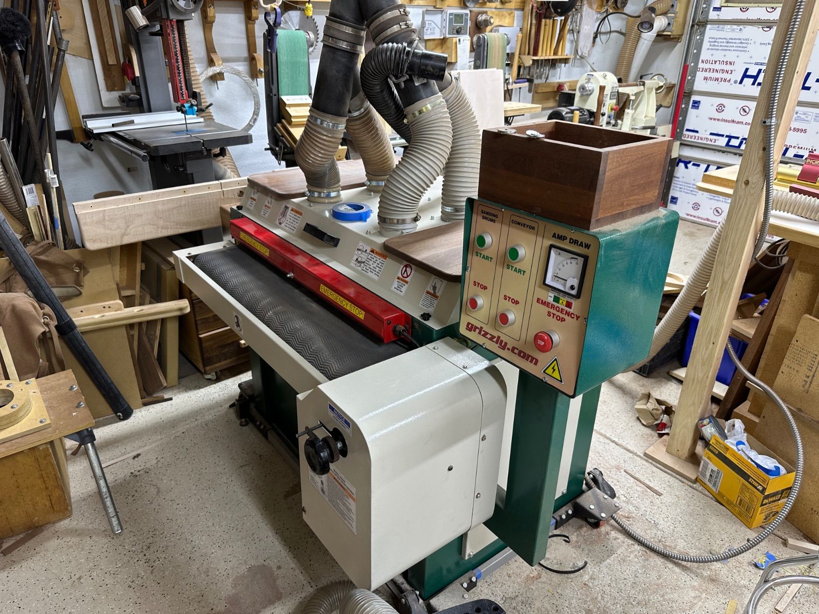

Popular Post Masonsailor Posted September 7, 2024 Author Popular Post Report Posted September 7, 2024 It’s been a busy week and the shop is thrashed. Several days of cutting, ripping and glue up. Have one more day of it and then all the panels can be run through the sander and start the assembly process and make the 10 lazy Susan’s. I’m waiting for fixtures on the bathroom project at this point. Paul Gunny, Al B, Gerald and 3 others 6 Quote
Grandpadave52 Posted September 7, 2024 Report Posted September 7, 2024 4 minutes ago, Masonsailor said: It’s been a busy week and the shop is thrashed. Several days of cutting, ripping and glue up. Have one more day of it and then all the panels can be run through the sander and start the assembly process and make the 10 lazy Susan’s. I’m waiting for fixtures on the bathroom project at this point. Paul Good thing you're "retired" Paul. Gunny, Al B, DuckSoup and 1 other 1 3 Quote
DAB Posted September 7, 2024 Report Posted September 7, 2024 is that green board behind the tiles? sigh. how about some concrete board kids? and then a coat or two of the red stuff, and then the tiles?! Grandpadave52, DuckSoup and lew 3 Quote
Masonsailor Posted September 7, 2024 Author Report Posted September 7, 2024 Yes it is. It is unfortunate how some people will basically do schlock work and get away with it. Oh well. Now it will be done properly. Paul Grandpadave52, lew and DuckSoup 3 Quote
Masonsailor Posted September 14, 2024 Author Report Posted September 14, 2024 A few busy days putting panels through the sander and today starting to get everything cut to size. We should be assembling in a day or two. Paul lew, Grandpadave52 and Gerald 3 Quote

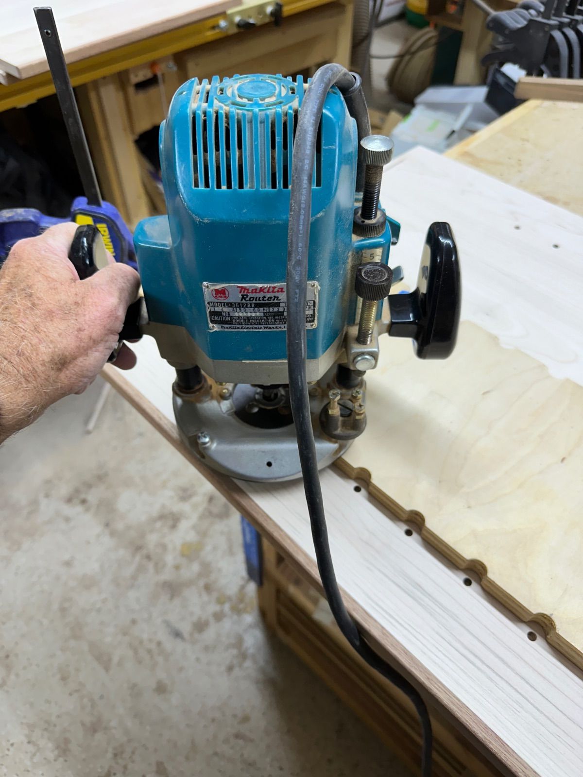

Masonsailor Posted September 14, 2024 Author Report Posted September 14, 2024 The first carcass is mortised, routered and ready for final sanding and assembly. Getting there slow but sure. Paul Grandpadave52, lew and Gerald 3 Quote
Gerald Posted September 14, 2024 Report Posted September 14, 2024 Like the router template. Very good idea Grandpadave52 and lew 2 Quote
Masonsailor Posted September 15, 2024 Author Report Posted September 15, 2024 Those templates date back to the 80’s and the cabinet shop. Now they have CNC machines that do it all. Paul Grandpadave52 and Gerald 1 1 Quote

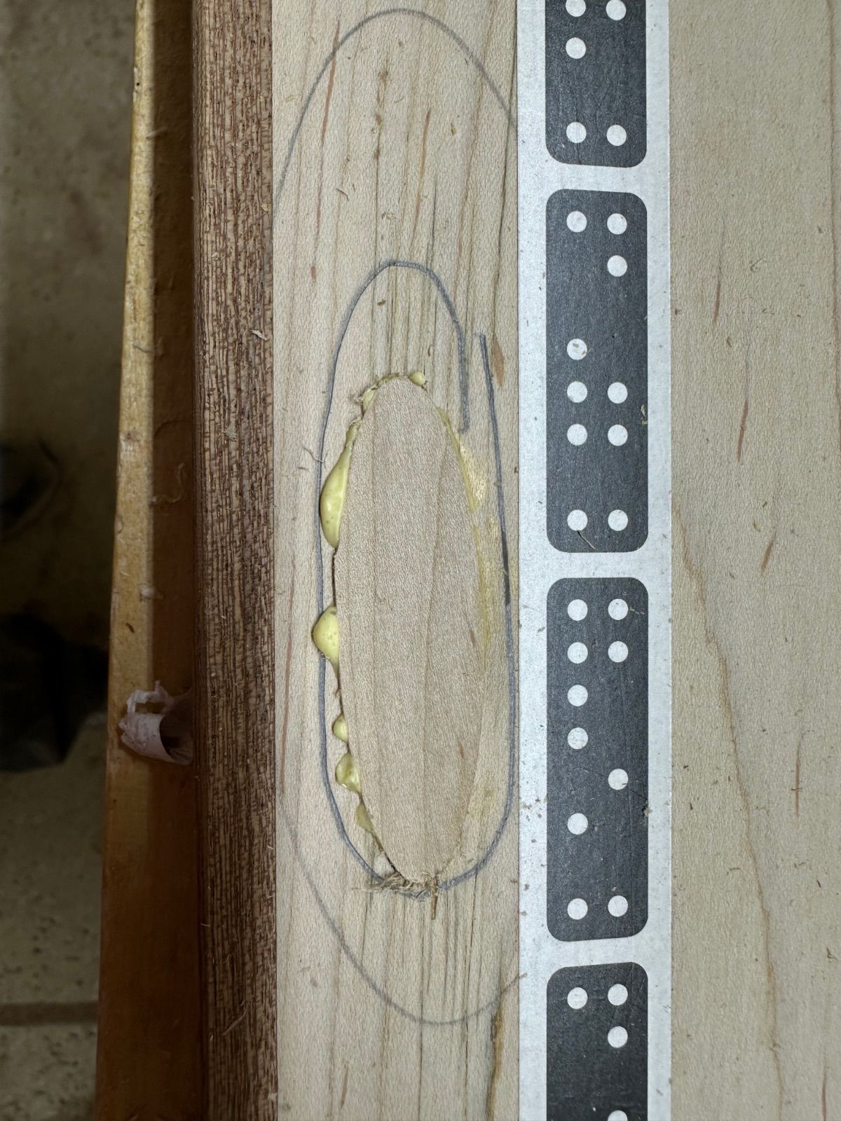

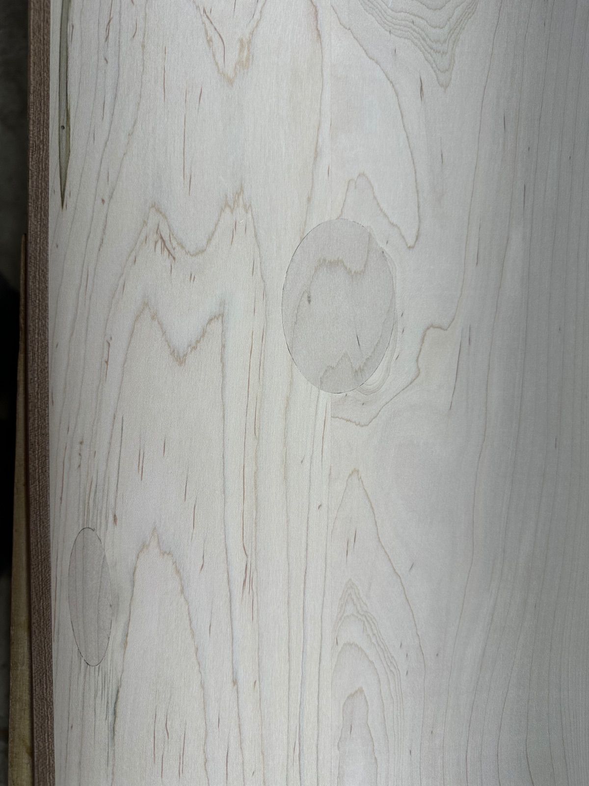

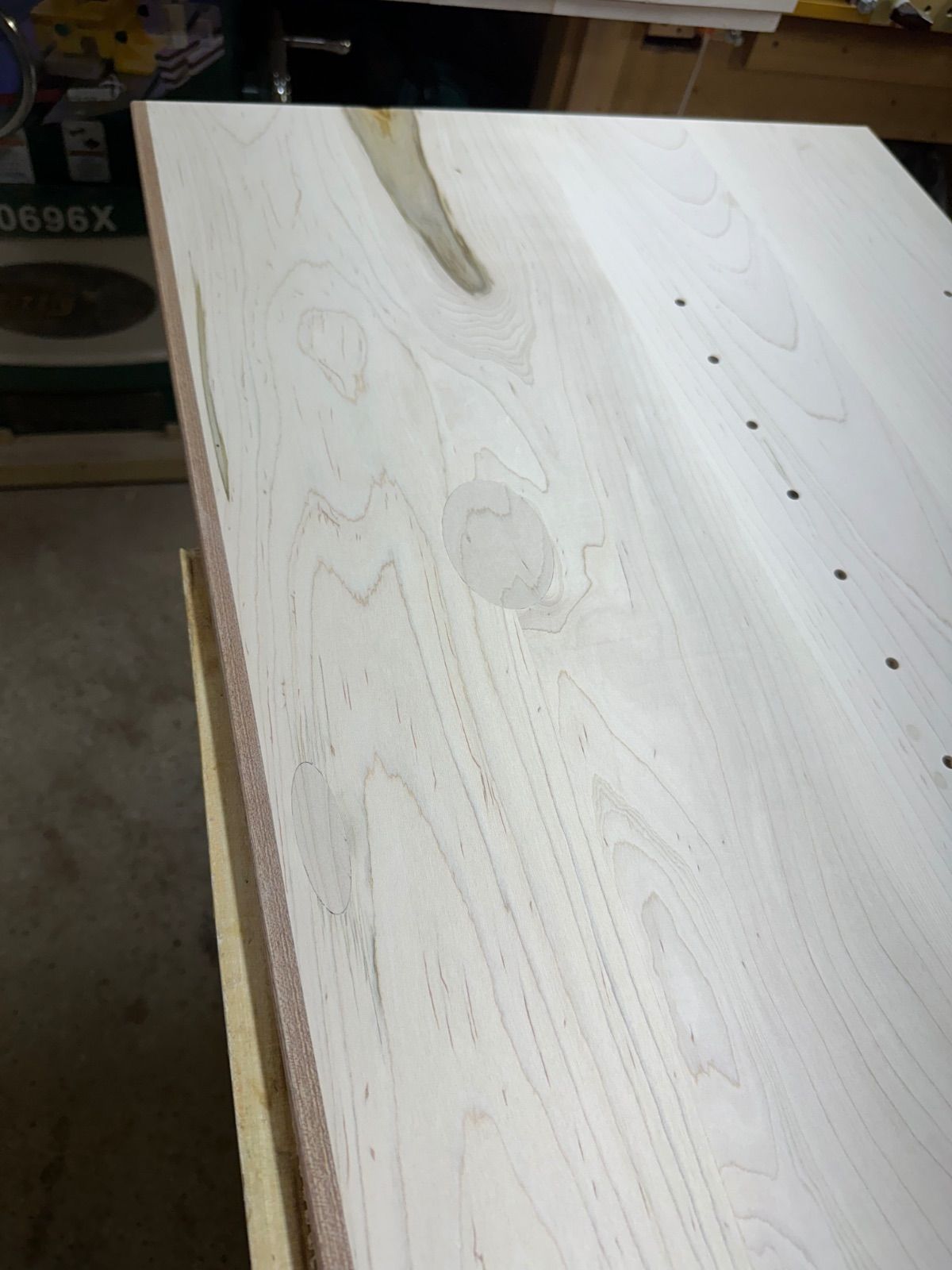

Masonsailor Posted September 24, 2024 Author Report Posted September 24, 2024 I’m back on the linen closet while we are in a holding pattern on the bathroom. I unfortunately didn’t notice a couple of major defects in one of the vertical panels. I meant to make it an outside side of a panel so it would not have mattered. I decided to try and use the Shaper Origin to eliminate both of them rather than make a new panel. You can judge the results for yourselves. Paul Gerald, lew, Grandpadave52 and 1 other 2 2 Quote
Gerald Posted September 24, 2024 Report Posted September 24, 2024 Looks like a good match , just a little darker lew, Grandpadave52 and DuckSoup 3 Quote
