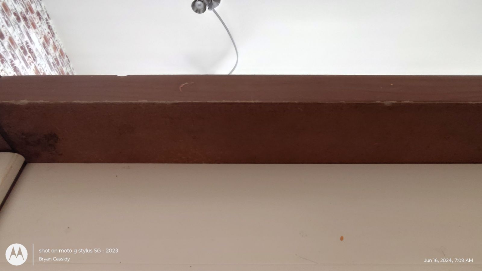

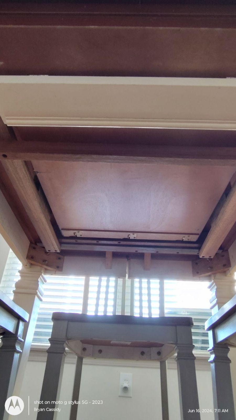

June 16, 20242 yr Author comment_337361 DAB, that would definitely be something I would be willing to try later on. I like the idea. At the moment, I'm going to focus on stripping, sanding, and refinishing and see how I feel about the results. We'll see what happens! Ron, I have to be honest, I'm not totally sure at this point what I have. It appears the grain is in the "end" (referred to as "end grain"?) and underneath the seat of the chairs, and tables, it feels and looks a little differently than the surface material of the tabletop and seat. I'm totally new to this and learning from scratch. What else can I say? Unfortunately, I did notice on the underside of the seat a sticker that reads "Made in Malaysia". A little disappointed but will go with it. We are still very happy with the table and I want to make this table my first project. With that said, if I have veneer tabletop and chair (the seat), what stripper is recommended and what grit? I was planning on going with Klean-Strip. Good choice for this project? I want to put a stain and some sort of protection on it. Want something dark with a lot of shine. It'll go really well with the rest of the place. Any other recommendations on stains/finishes/protection is much appreciated. Thanks in advance and sorry for the delayed response. I've been busy and also doing some fishing! Cheers, guys! Edited June 16, 20242 yr by Bryan Cassidy Report
June 16, 20242 yr comment_337379 Bryan, I would bet the farm that it is veneered on the top so I would move forward cautiously and sand lightly. If you use a stripper minimize the water because you could release the veneer from the top. Report
June 16, 20242 yr comment_337380 The photos of the table top are too dark (at least on my computer) to get a good look. If it is not veneered, the grain line will run off the end, if the grain goes horizontally (side grain) and or perpendicularly, then it is veneered. Another way is to look inside the joint where the leaf fits. It it looks different than the top (like plywood, then it is veneered. It is uncommon for chair seats to be anything but solid wood. When you are refinishing the chairs, definitely remove the seats by the 4 or so screws. Report
June 16, 20242 yr comment_337386 given the country of origin, it is in all likely hood veneer over some cheap white-ish wood. veneer is about 1/42" thick (i bought some recently, it was marked as 3/85" thick), so it doesn't take much sanding to go right thru it. that's another way of saying that you don't have "fine furniture" in your hands, just "solid wood" furniture made overseas in a large factory (as opposed to Ikea stuff which is largely glue and dust). my solid wood dining room table, made by the Amish in PA, shows the end grain of the wood, so i know it is NOT veneer. your edge banding is one way to hide either the end grain, or more likely, the inner core of the table top with veneer on top and bottom. they do both sides so the core will not warp. Report
June 16, 20242 yr Author comment_337388 29 minutes ago, DAB said: given the country of origin, it is in all likely hood veneer over some cheap white-ish wood. veneer is about 1/42" thick (i bought some recently, it was marked as 3/85" thick), so it doesn't take much sanding to go right thru it. that's another way of saying that you don't have "fine furniture" in your hands, just "solid wood" furniture made overseas in a large factory (as opposed to Ikea stuff which is largely glue and dust). my solid wood dining room table, made by the Amish in PA, shows the end grain of the wood, so i know it is NOT veneer. your edge banding is one way to hide either the end grain, or more likely, the inner core of the table top with veneer on top and bottom. they do both sides so the core will not warp. DAB, thanks for helping out with identifying the wood. With that said, it appears to simply be veneer. I can live with that at the moment. I definitely do not regret buying the set. I think it looks great and will be a great first project for me. It is would be nice to turn the set into something nice and maybe in a few years when I have learned more, go out and buy something amazing? So, with that said, this will be my plan of attack: 1. Strip with Klean-Strip (Starting with chairs and removing seat) I plan on letting it sit whatever time the bottle says and removing with plastic scraper. Will there be any residue left over? Do I need to follow back up with a paint thinner after stripping? I've seen some follow up with 0000 steal wool and "dip" into thinner or stripper to remove any residue. Should I let this sit and dry over night before applying a primer? 2. I was going to simply buy primer in a spray can for the extra chair I'm practicing on. I have seven chairs that came with the set and I left one in the garage to practice on first. I was also planing on buying paint in a spray can as well for the chair downstairs. I do plan on buying a paint sprayer later on. Still doing research and not concerned with buying it this second. 3. Strip the chair seat, apply a stain we pick out, and apply a varnish at the end. I do not plan on sanding the seat at this point. If I do, it will be with something like 120 - 220. A little nervous about sanding at this point. Also, all sanding will be by hand at this point. I may use a sander on the chair, not the seat, but that will be it at this point. Want to play it safe. Maybe I should just do all sanding by hand. Sorry for the million questions. I want to cover as much as I can before proceeding. I like to be over prepared. Plus, I plan on buying the stripper, scraper, and some plastic tomorrow. I may go ahead and get some spray primer too while I'm there. Edited June 16, 20242 yr by Bryan Cassidy Report
