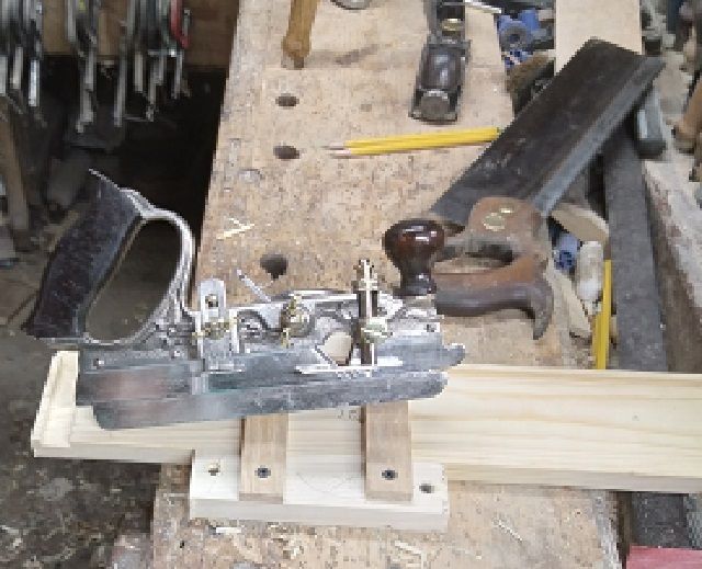

Jig building, did require a cordless drill..
To build a jig to do dados...Plane is the Stanley #45, Type 4, set up to cut a 3/4" wide dado for the drawer's back to sit in..
Mr. Jackson is there to make kerfs cuts at the entrance and exit points...to prevent any blowouts..

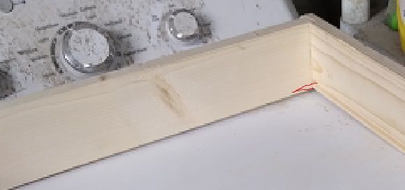

Dados were also cleaned up with a 3/4" wide chisel..
Test fit...
2 dados done...only 14 more to go..

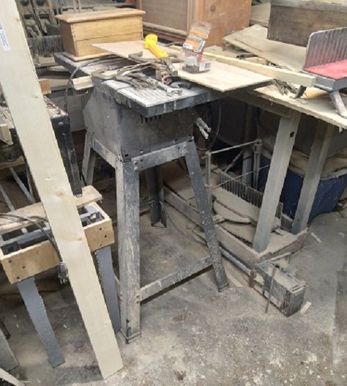

Mitersaw was in use last night...as the tablesaw was still unavailable..

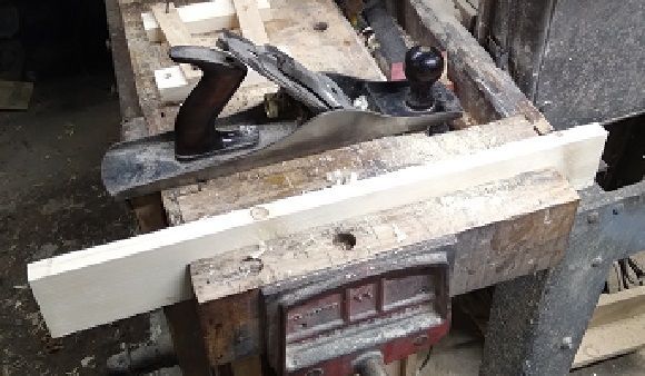

That Pine 1 x 4?   I needed to cut a couple pieces at 21-1/2" length..
Problem was...

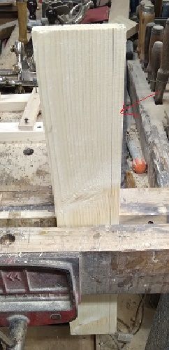

The 1 x 4 was a bit too wide..needed to loose about..
That much?  Too much to handplane down, yet
We have ways..
THEN a plane could be used..
Stanley No. 5-1/2 Jumbo Jack kind ot laughed at the knot in it's way

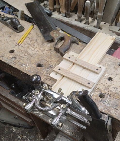

As for the 3rd and 4th Dado?
That reflection in the side of the plane, right under the handle..is my face.   Yep, it IS that shiny..
But works great...only need to do 12 more Dados..then it too can go back into it's own case..

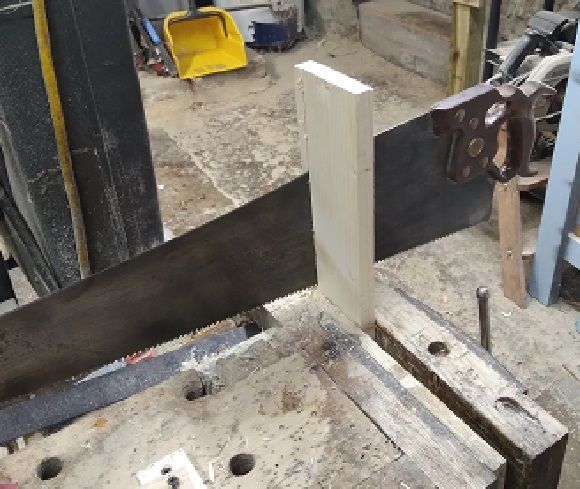

Did you know...that IF you rubbed a candle along the tooth line of a saw...it will cut much better
Whether it is that big old Disston D8 Rip saw..or that little Jackson Back saw...seems to help reduce any friction IN the kerf.

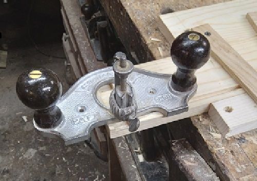

Also in use this past weekend..a Stanley No. 71-1/2 Router plane..and a 3/4" wide chisel...

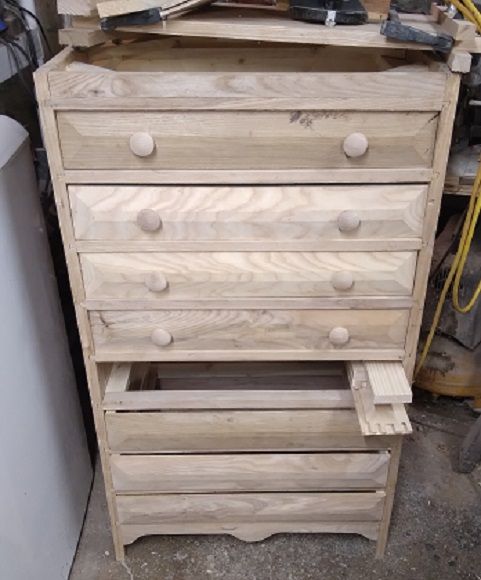

Top 4 drawers are assembled..#5 and #6 are ready to be...

Router plane, cleaning up dados

This is a solid tip!!  the candle trick works with saws and planes as well.
