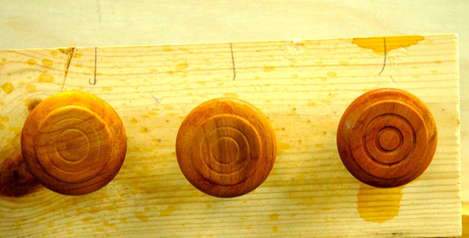

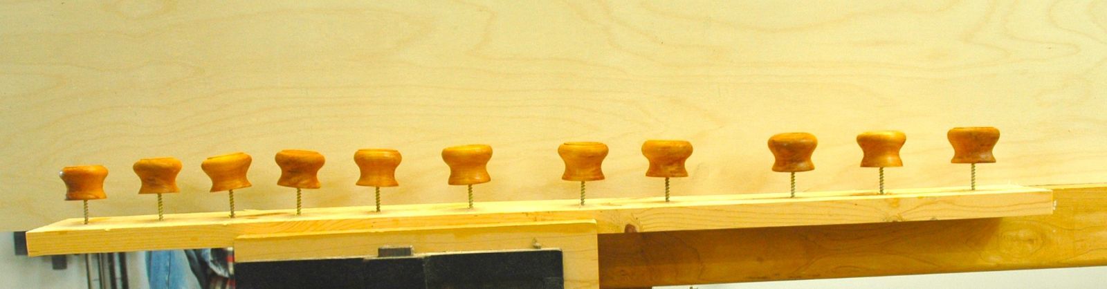

OK, I had a bit of recovery. I was able to get 11 knobs completed and while they don't match the perfection you accomplished turners get, I'm calling it a win. I had 14 blanks for this out of the piece of scrap I cut up to make them, but 2 of them had some good size chip out during the rounding process that made them unusable. The third missing one got sucked up in the DC and i can't find it in the ducts or the dust bin..it'll show up someday. The remaining 11 went very well, I got the shaping close and started using calipers to set the diameters after the first 3 making them a little closer in size. I did less well on the detail on top of the knobs, the rings aren't cut to the same depth, and sometimes the diameters aren't as close as I would like. They're mounted on a board so I could give them a coat of garnet shellac for the finish. But the whole thing was enjoyable as well (more importantly) as a good learning experience. I'll be doing more but some other things are at the top of the list for now.
Love 'em Fred as well as you sharing your journey. Helpful for current and future aspiring turners. Thanks!

They look great Fred.  As a reminder your mechanic wrenches make nice rigid calipers for such endeavors.  They can be a bit wide sometimes.
