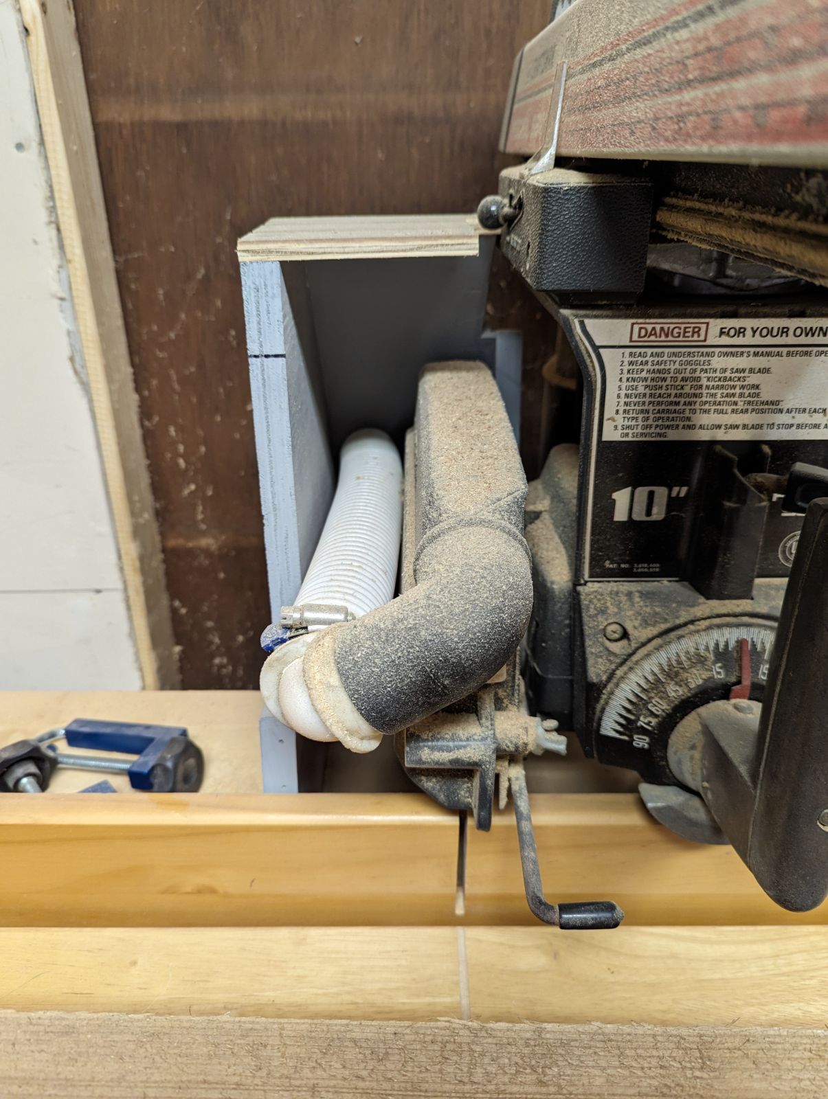

Popular Post User74 Posted April 2, 2024 Popular Post Report Posted April 2, 2024 I inherited my father's woodworking equipment when he passed in 2014. One of the most cherished pieces was his Craftsman RAS. This was his only saw. He never had a table saw. He did rip cuts, bevels, miters and all with it. I can remember standing beside it and watching him as he would cut his projects out. I'm 6.1 and my dad was about 5.9ish. When I brought the saw to my shop the first thing I did was the one thing I'd wanted to do for years, that was to raise the saw table to my height. I could not stand to have to bend over to see the blade. He would always say when I'd suggest things that "when it's your saw you can do with it whatever you want.". I removed it from the original stand and built a new taller stand. Since I was in a small workshop I put casters on it to make it mobile. I also added a drawer to hold blades and tools for changing them and recalibration. The table top was still the original 3x2x2 particle board from the mid 80's so the second thing was to replace it. At first I was just going to use a regular piece of plywood but, then my brother was moving and had to get rid of his old dinning room set. I had one of those epiphany moments while toting one of the leafs out the door. It was good solid wood, factory made and finished, smooth sliding surface and the perfect length and width. It was as if all the planets were aligned and everything was right in the world. Now all I had to do was figure out how to attach it so it could be removed easily if need be. My first thought was to have recessed bolts through the top. That was quickly shot down cause I wanted a smooth solid top. After some serious pondering and several failed ideas I finally had the solution. I took the piece of plywood from the original idea and mounted it to the saw. Then I cut some brackets that fit flush so I could slide it off when it needed to be replaced or removed. I attached it to the plywood from the bottom with 1 1/2 inch screws to keep it from sliding front to back. It worked like a charm. He also wanted the shortest fence possible. If it would just catch the wood and hold it he was happy. I like a tall fence so that was another thing that got changed. It had finally emerge into "my saw now". Over the years there has been many a board foot cut on this saw. Every time I use it it makes me think of my dad and that makes me smile. Woodman, aaronc, Cal and 7 others 6 4 Quote
Popular Post HandyDan Posted April 2, 2024 Popular Post Report Posted April 2, 2024 I had that exact saw. I bought it for $100.00 from a guy that bought it new but never put it together for use. There is a detailed set of instructions in the owners manual for setting up the saw for accuracy. Making the stand is a good idea. The rigidity will keep the saw accurate once it is set up. The Craftsman saw bases twisted too easily. Every time the saw base moved the saw went out of wack. aaronc, lew, Gerald and 7 others 10 Quote
Popular Post User74 Posted April 2, 2024 Author Popular Post Report Posted April 2, 2024 5 minutes ago, HandyDan said: I had that exact saw. I bought it for $100.00 from a guy that bought it new but never put it together for use. There is a detailed set of instructions in the owners manual for setting up the saw for accuracy. Making the stand is a good idea. The rigidity will keep the saw accurate once it is set up. The Craftsman saw bases twisted too easily. Every time the saw base moved the saw went out of wack. I don't have the manual but I've found several good videos on YouTube on how to keep them calibrated. The top of the cabinet is two pieces of pressure treated 2x12's joined and glued. It is really a tank. Woodman, HARO50, Cal and 4 others 7 Quote

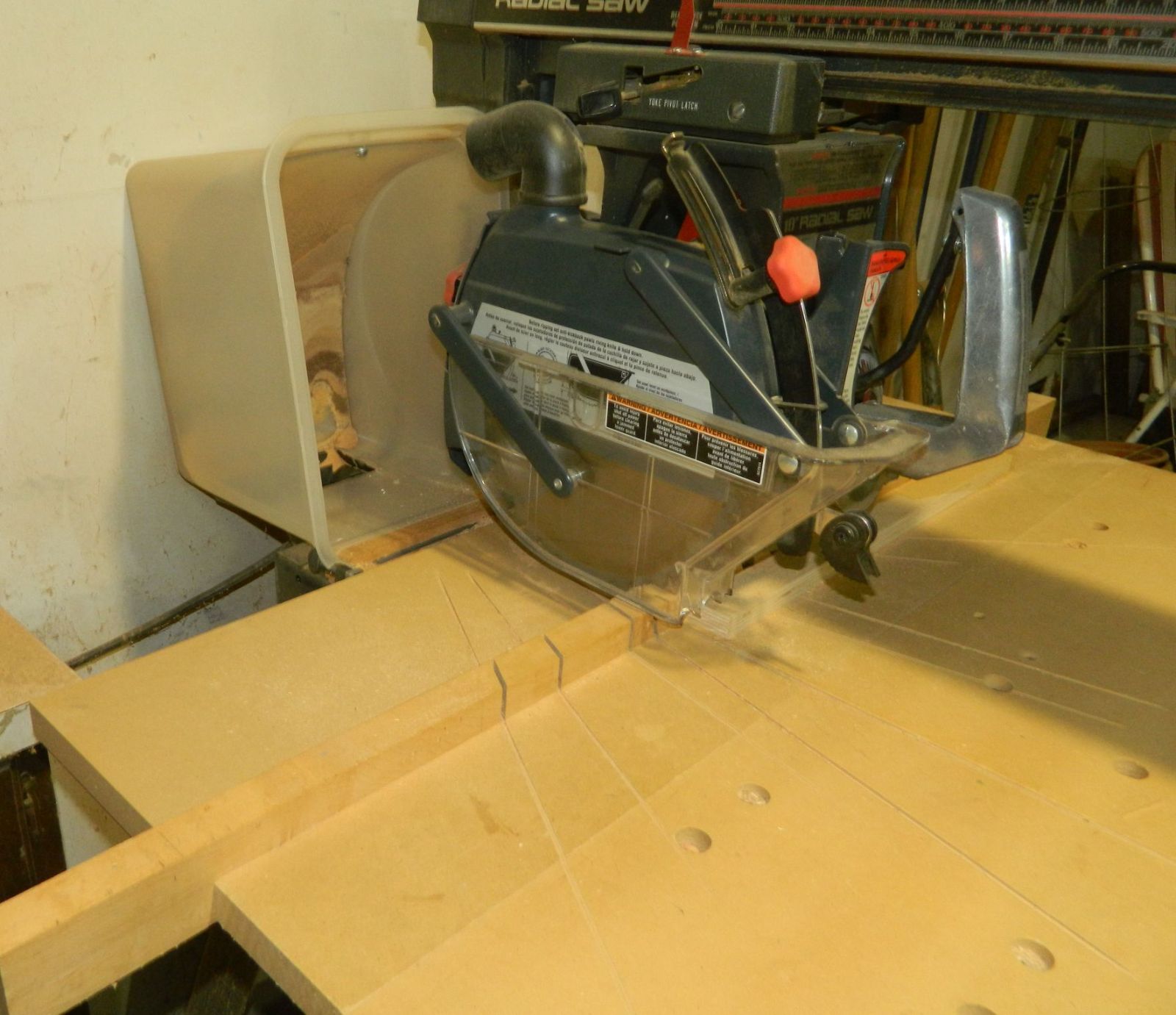

Popular Post 4DThinker Posted April 2, 2024 Popular Post Report Posted April 2, 2024 I also own that saw. There was a recall out for it a couple decades back that provided a new/better blade guard and new table top. Mine is living happily in my garage shop area and is often used for crosscuts too wide for my Bosch glide compound miter saw. I have it set up with a collector/deflector behind the blade routed down to a dust vac which prevents any blowback of chip it throws when cutting. Best update I've done for any tool I own. You might check online to see if it still is available. Didn't cost me anything other than needed to register the saw to get the updates. Headhunter, Larry Buskirk, Fred W. Hargis Jr and 6 others 7 2 Quote

Popular Post 4DThinker Posted April 2, 2024 Popular Post Report Posted April 2, 2024 30 minutes ago, User74 said: I don't think it would clear my fence. Lol I like my tall fence. I might could cut out where the blade goes through. It swings up, and would rest on your fence until pulled past. There is also a lever on the back of the handle you can lift it up with while holding the handle. I highly recommend you get it as it would be free and you could simply not use it if you don't like it/can't use it. I used mine for 15 years or so with the original table before getting the update. While it does make it just a bit harder to see the blade when lining up a cut I'm very happy with the added safety. HARO50, Cal, User74 and 2 others 5 Quote
