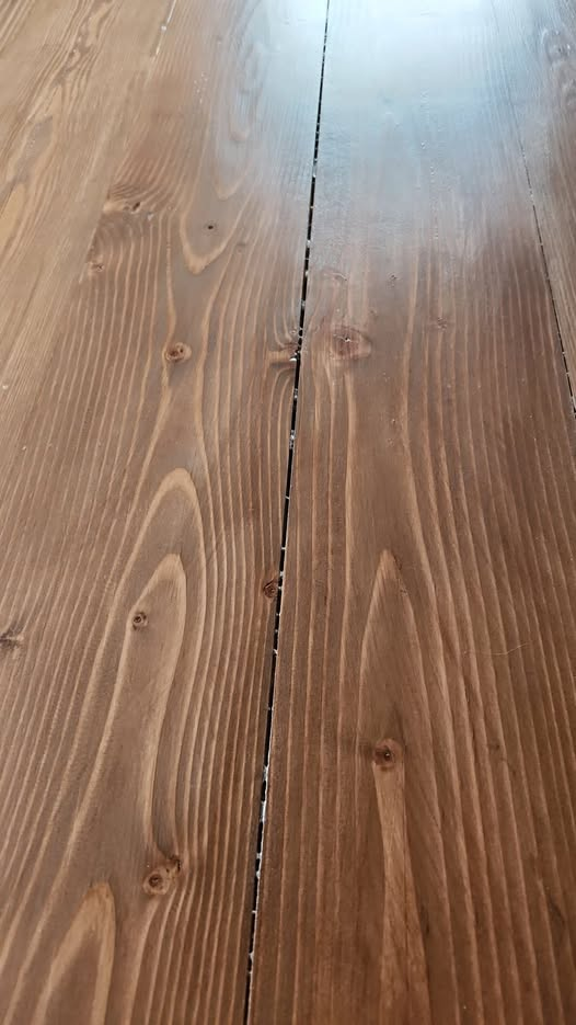

This morning's post online, "What happened to my farm table top?"
"Did you have breadboard ends?"
"Yes, glued and pocket hole screwed.  I got the wood from Home Depot and thought it was dry."
'nough said

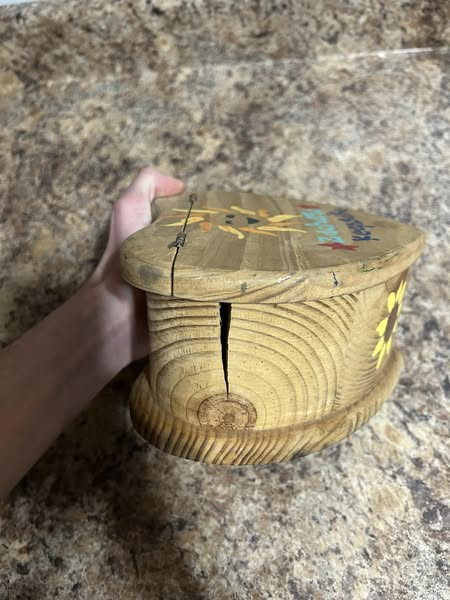

Today's example.  Very bad choice of wood for this application.  In one of the vintage FWW, I just re-read an article by R. Bruce Hoadley on wood movement, complete with a lot of technical information and data.
