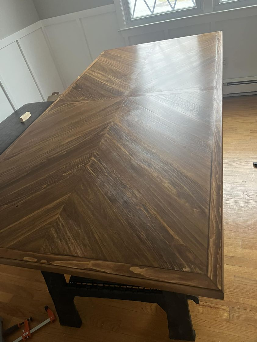

Newbie posted today about a herringbone table he made (of solid wood).   Can we have a poll to decide how long before it blows apart?
I get December 2024
those mitered corners will go first.  July 2024, once it gets warm and humid.

It's an issue I see all the time on beginner projects.   And I have seen a few tables (made in Asia) that have had cracks from one end to the other.  One customer told me, "We heard what we thought was a gunshot in the middle of the night.  When we came out in the morning, there was this huge crack in the dining table from one end to the other."  And frequently raised panel doors and sides with "suntan lines" that needed to be fixed before the piece was even sold.

To follow up all of the comments I have a question.
If that table top were made from strips of plywood, would there be an issue with expansion?  My brain wants to say no.
How about the solid wood edging with mitered corners, any issue there if the top itself is plywood?
My opinion: no, and no. I've done several tops with plywood panels and trimmed wit hardwood....nary a problem.

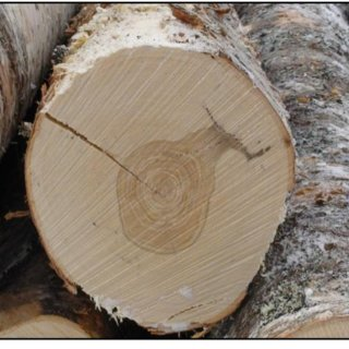

Wood expands very little along the grain (i.e., length)  It expands radially (from the center out) and tangentially (around the growth rings).  In most species, the tangential is about twice the radial.   This manifests in two things:
  • Quartersawn stock (with the rings vertically, or nearly so) has less side to side contraction, but mostly in thickness, where it matters less
  • If you take a section of a log and dry it, it will usually crack into a wedge-shaped opening because the tangential is moving more than the radial

An evolved adaptation to gravity. Then a little homage paid to geometry.  Circumference =Pi (3.14ish) x diameter.  Tree adds a new 1/16" ring, getting 1/8" bigger in static diameter. The circumference though grew .125 x Pi or 0.39269908169" .  Moisture intake has the same ratio effect, swelling a tree 3+ more times in circumference than diameter.  So face cut boards expand/contract up to 3 times more than boards cut radially through the growth rings.  Seen it happen many times as seasons changed during a semester of furniture design classes.
