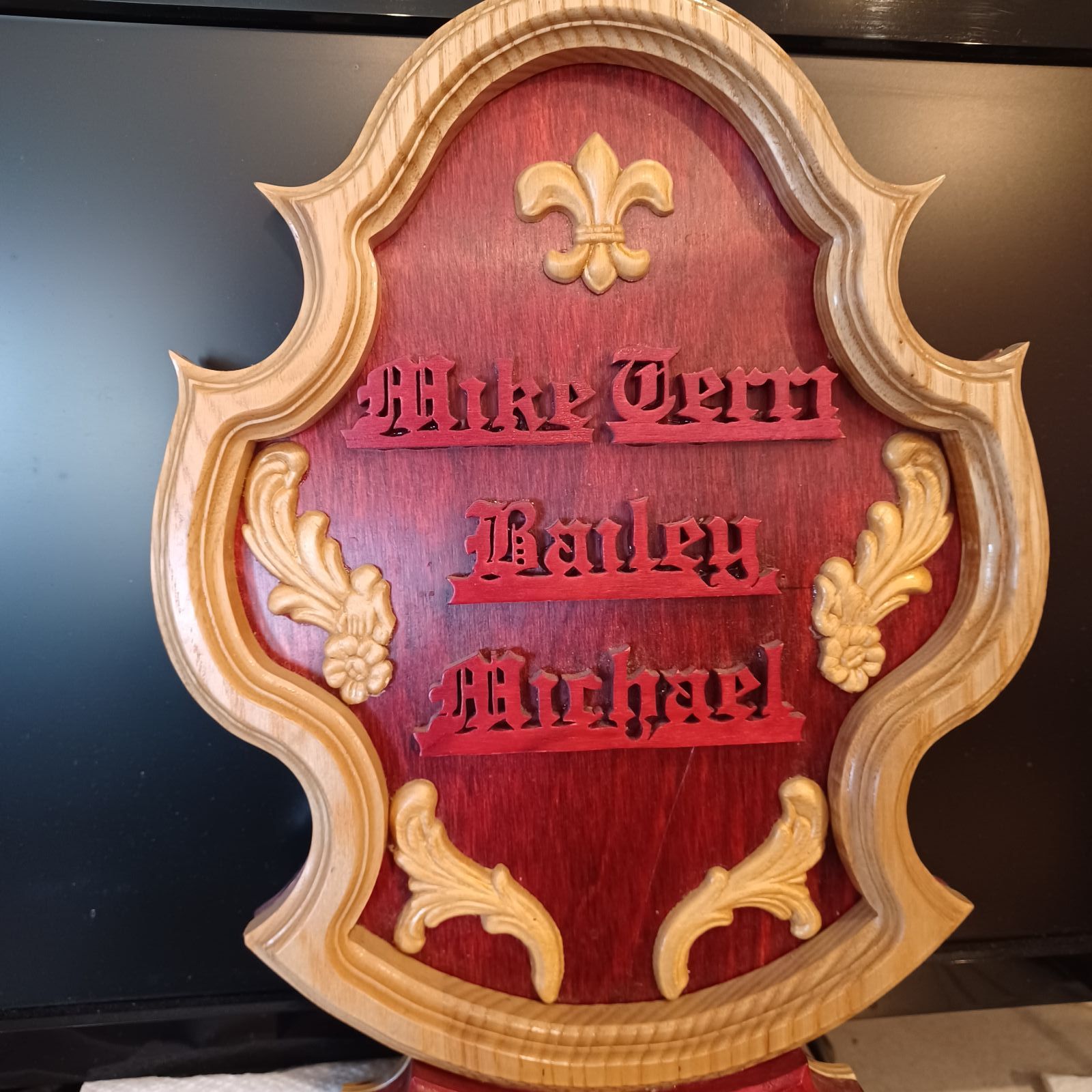

1/4 BB stained wth medium Watco. On a 1/8 BB backer rattle can painted blue.20240301_050754.jpg.c34366f1778d7a8b34814e6582f171cc.jpg

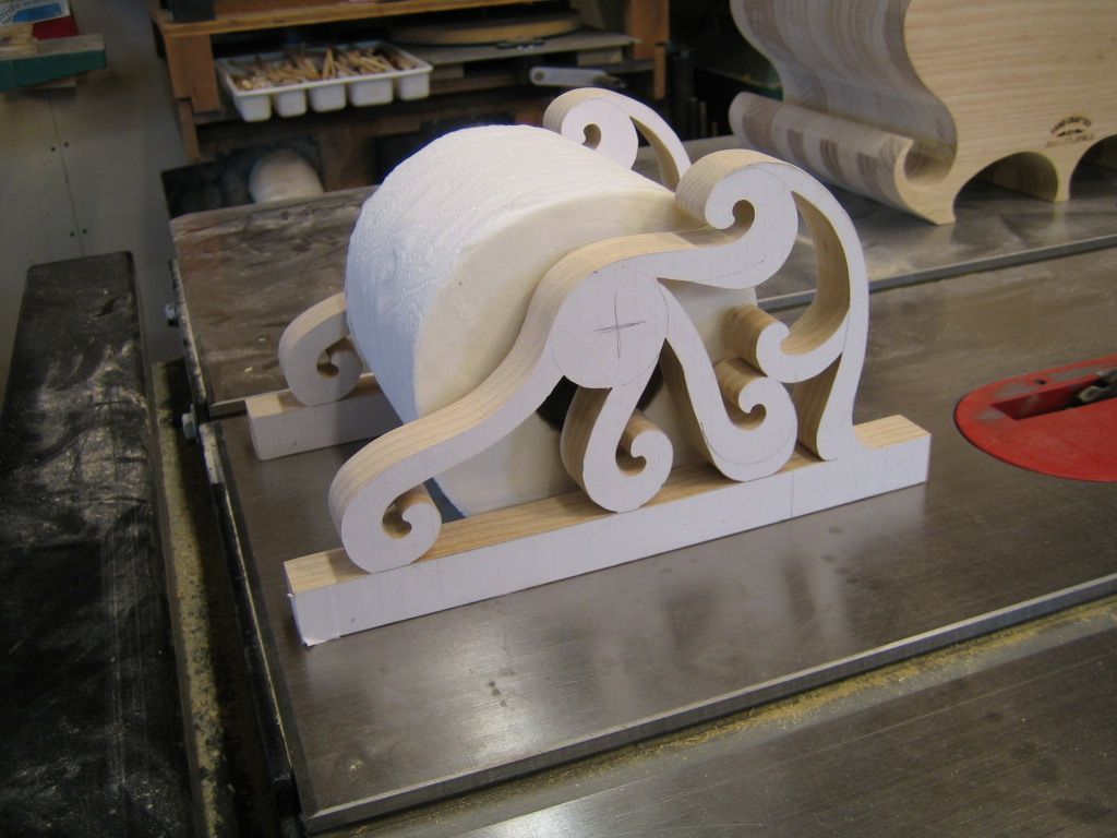

wefinallyfoundwneretobuythiswhiterollofstuffstrangestuff.jpg.02046141c498250b9f1effb5a138a7b4.jpg
This toilet paper holder I drew out using 1/4" squares graph paper.  And then use a set of French Curves from20240301_100714.jpg.456a6f6477258e9282e555a8067acd0b.jpg

None of these patterns were bought as I save any picture that is straight at me then enlarge for my patterns . I leave my patterns on and use a Dremel 3000 with the flex shaft which makes it much easier to hold and get to the area I am wanting to carve. Everything I scroll saw is done with a #5 blade and they are flying dutchman brand.  Getting use to using the reverse tooth blades is harder to use than a blade that has teeth all pointing down but in the long run you will save sanding on the bottom part of what you sawed out. You will still have fuzzies on the bottom but a lot less work to remove them.
  Through away the hold down for it gets in your way as you need to learn to control the wood with your fingers.
Only use your fingers to tighten the blades or else you will stretch out the area holding the blades and then you will never be able to tighten the blade properly.
  I find the best way to make names is to make the letters all together and join then with a little log under the letters which lets me glue just one piece down. when you attach them to the wood you are just gluing down one group for if you try to make letters separate you can never get them glued down straight as they should be.
 Once I type out the name and before I start sawing I draw two lines under the name to connect them all together ...

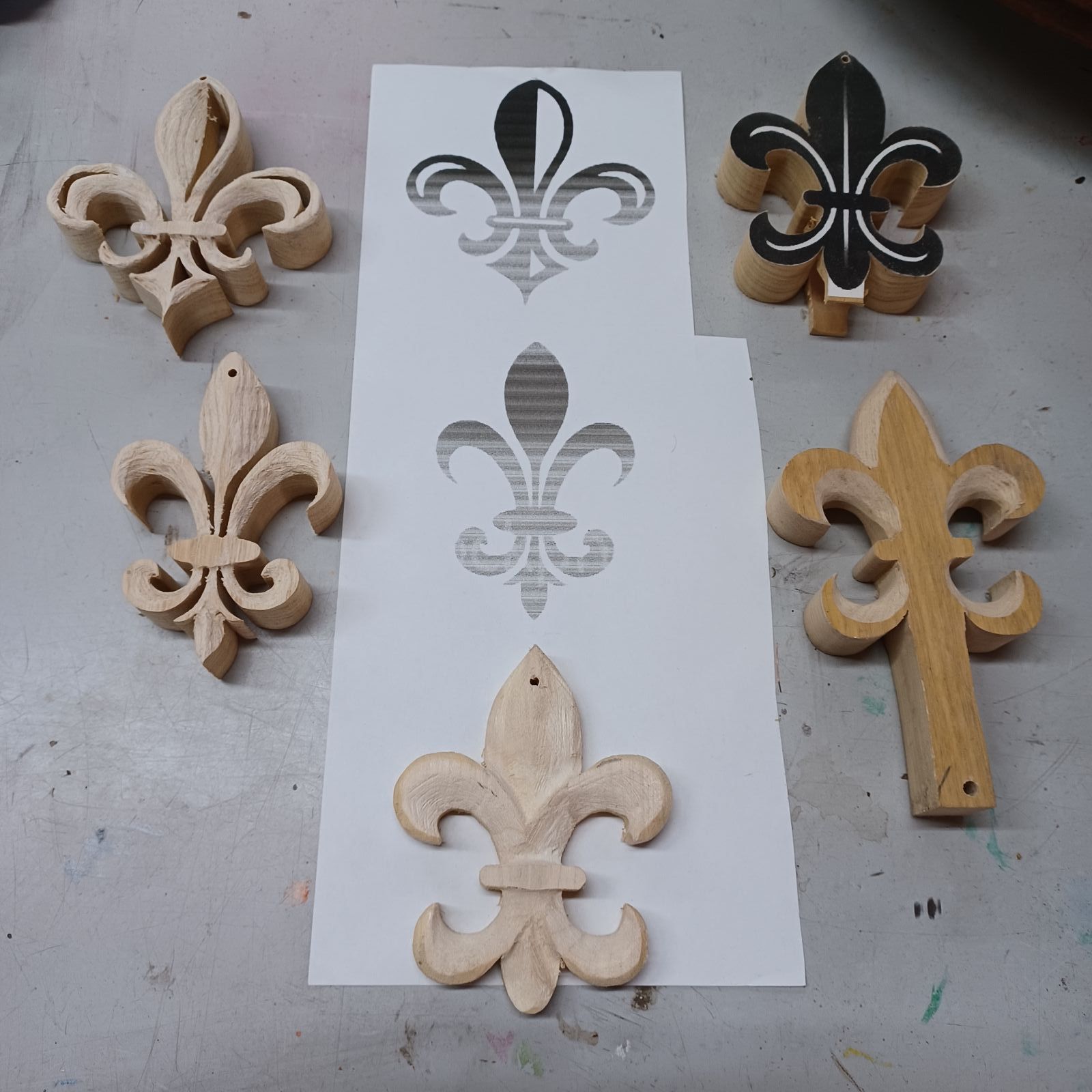

20240301_102607.jpg.5149ffa29a5c3090e65499c686236d07.jpg These small carvings on this picture were store bought for I wanted something that was only about 1/4" and these
appliques are great for this type of project I keep one of everything I buy like these and trace around them for more patterns....Lawless Hardware.com and they have good prices.. The big appliques I scroll saw them apart to fit a special area
   This is how I learned to carve by tracing around one on paper then gluing it on to some thicker wood to give me more room to get deep curves and things. When I cut out lots of pieces of a picture to carve and after I slope both sides of the pieces it kinda hides the sawn out voids.
  I never have to sand any of the areas where the blade went through the wood.
