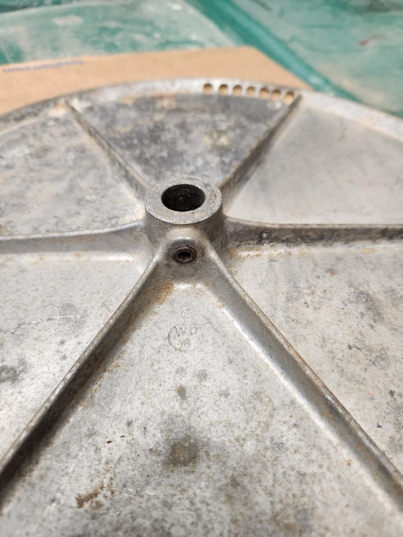

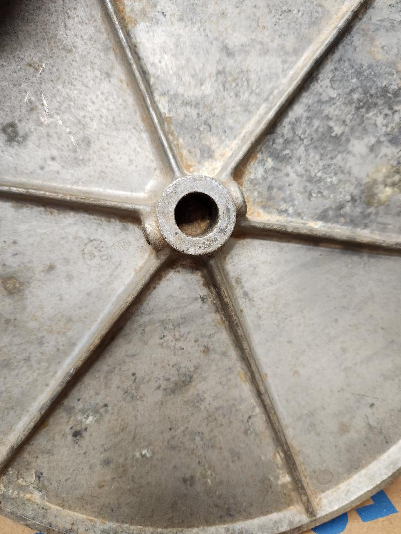

Got a picture or two of it Smitty?
I was afraid of that. My SS is a bit newer.
Now that I'm back home!!!!
Pics of the sanding disk:
I'm THINKING this MIGHT work:

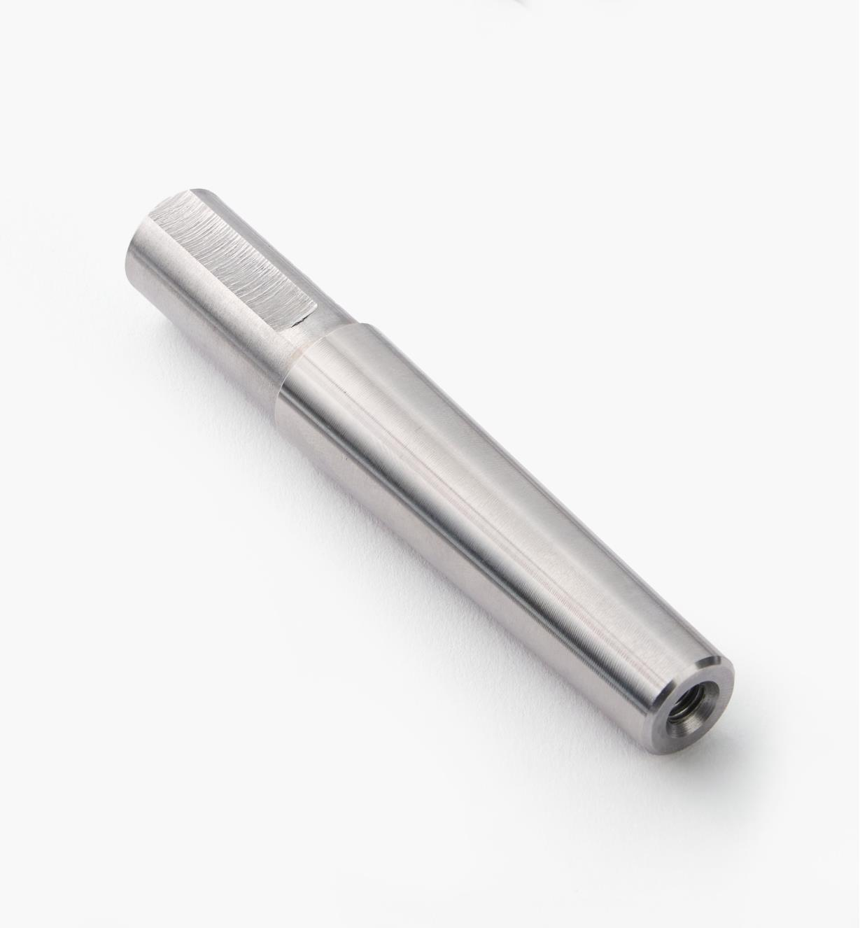

https://www.leevalley.com/en-us/shop/tools/hand-tools/turning-tools/101553-beall-morse-taper-mandrels?item=44J2692
Thoughts?? Insight??

Thanks for the pics Smitty. Looks like that spindle shaft from Lee Valley is exactly what you were describing. Should work OK.
