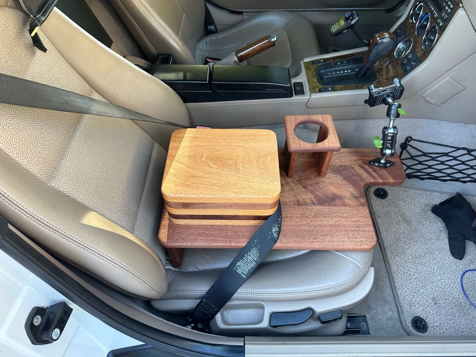

December 28, 20232 yr Popular Post comment_326688 I was recently lucky enough to find a 2000 BMW Z3. The car was owned by a close friend and has very low miles and pretty close to perfect. The one issue I have with the car is the center console which is severely lacking. Really no cup holder. There is one but it’s in the center console behind the seats so you have to be a contortionist to use it. That also means no place to put your phone. I saw on Amazon someone is making a caddy for the passenger seat which is perfect as I will be riding alone in this car most of the time. I decided to make one out of wood and see if it will work. I think I will make a small storage box for it also. Except for that it’s complete. Paul Report
December 28, 20232 yr Popular Post comment_326689 Cool looking holder, Paul! Just don’t slam on the brakes! Report
December 28, 20232 yr Author Popular Post comment_326690 The commercial ones use a Velcro strap that goes around the seat. I think I will probably do the same. Paul Report
December 28, 20232 yr comment_326706 Very nice Paul. Any problems with it setting off an SRS (Airbag) warning light? Report
December 28, 20232 yr Author comment_326726 Apparently there isn’t enough weight on the sensor for the airbag to activate it. Paul Report
December 28, 20232 yr comment_326731 1 hour ago, Masonsailor said: Apparently there isn’t enough weight on the sensor for the airbag to activate it. Paul The weight sensor on our Pilot will go off if the wife sets her purse on the seat without latching the seat belt requiring having to reset the system. Edited December 28, 20232 yr by Larry Buskirk Report

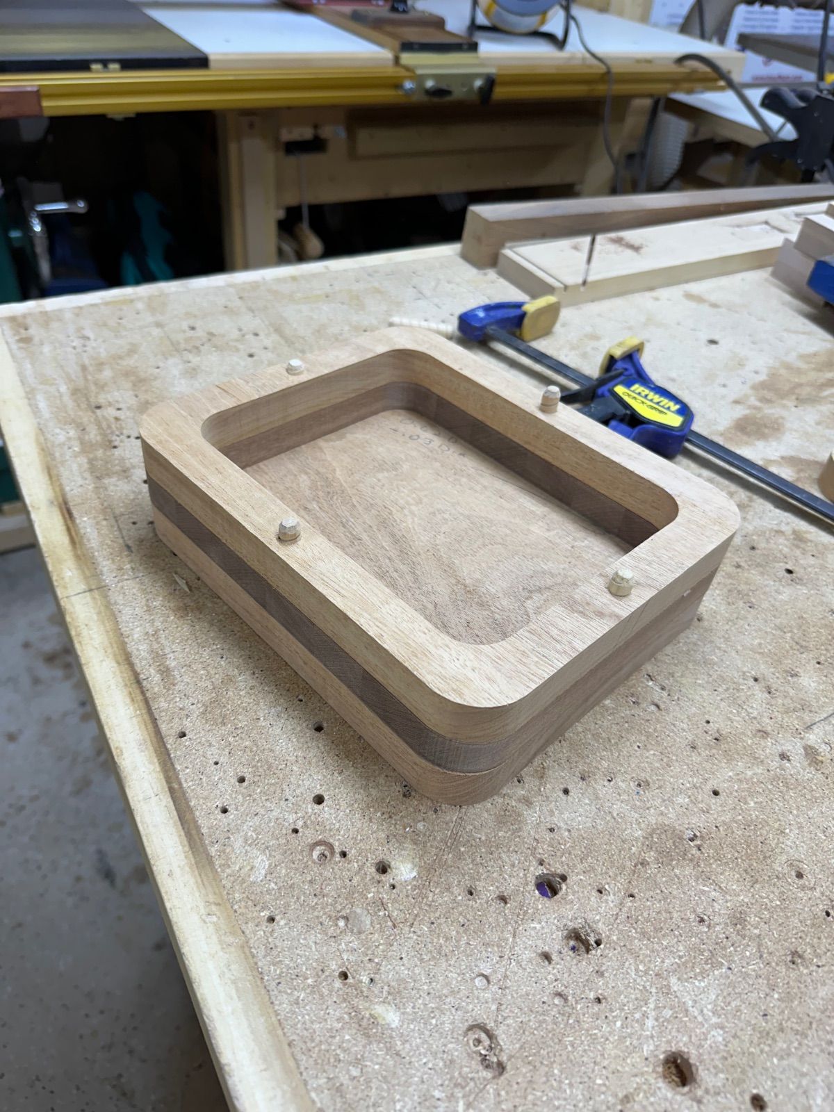

December 29, 20232 yr Author Popular Post comment_326783 I checked the sensor yesterday. Thanks for the heads up Larry. It seems to take about 40 pounds to activate the sensor. I used a couple of barbells for a test. I started the little storage box for the caddy. I am making it using the Shaoer Origin mostly because it’s quicker. It’s just large enough to accommodate a model 27 of Gaston’s who recently died. Paul Report
December 29, 20232 yr comment_326805 Beautiful work, as usual. The teacher gene of mine that apparently is still active worries about the conflict of grain direction between the top and side foot, and cup holder sides against the top with round hole in the square block. Particularly for something left in a car where the humidity will vary considerably. It'll be a good test for the dowel joint. This I learned from personal experience and ended up with sheared dowels and a rippled board. 4D Report
December 29, 20232 yr Popular Post comment_326808 redneck: would have just taken an old cup, sawed off the lower 4", and attached that with a few screws thru the bottom into the wood. maybe 2 even! Report
December 29, 20232 yr Author Popular Post comment_326815 I thought about that 4D but as usual I am building this with scraps so it is what it is. A good test ! It’s all done except for the test drive. Paul Report
December 29, 20232 yr Popular Post comment_326817 Don't worry. Best lessons are learned from experience. What I enjoy about wood is that it can be reconfigured if the grain of a scrap isn't going the right direction for a project. Rip, tip, glue back together. The cup holder top looks like it could be popped off and turned 90 degrees. Lost a job thanks to un-anticipated wood contraction. Wasn't my fault but they needed a sacrifice to save face. A sub contractor who made the parts I designed changed from a plywood piece with a hardwood piece of trim on top and bottom to a piece of solid wood run though a moulding machine. A piece of plastic trapped between the top and bottom lip ended up either popping out or splitting the back when winter came and the air dried out. These were door signs for the Menninger Foundation that was in Topeka KS. That job loss led to my teaching job though, which lasted 4 decades and was considerably more interesting and fun than designing signs. 4D Report
December 29, 20232 yr Author Popular Post comment_326818 Life is what happens while you’re making other plans ! Report
December 29, 20232 yr Author Popular Post comment_326819 Took it for a vigorous test drive. I’m going to have to come up with a method of securing Mr Gaston’s invention. Rattled around a bit. But phone was secure. Paul Report
December 30, 20232 yr Author comment_326820 Well the boss took her first look at it and a very negative reaction. We’re talking negative here. She says it needs to be in walnut burl like the rest of the car. Not sure that’s possible. Paul Report
December 30, 20232 yr Popular Post comment_326822 Make sure the burl trim isn't actually plastic. If it is then ask the boss if she really wants it to be made from plastic. Report
