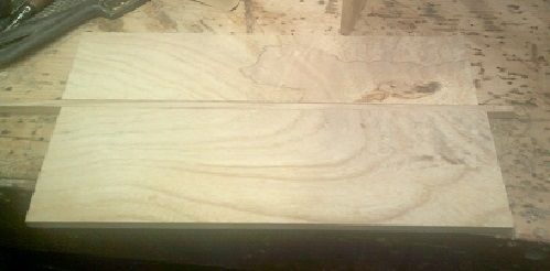

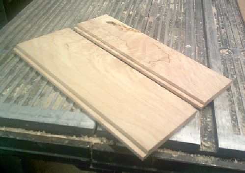

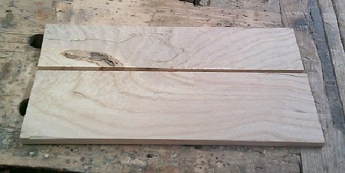

The fancy pair?   Well, they were trimmed up a bit...:ChinScratch:
One on the left will become a couple drawer fronts...with the one on the right being the top of the case...to be built..:ph34r:

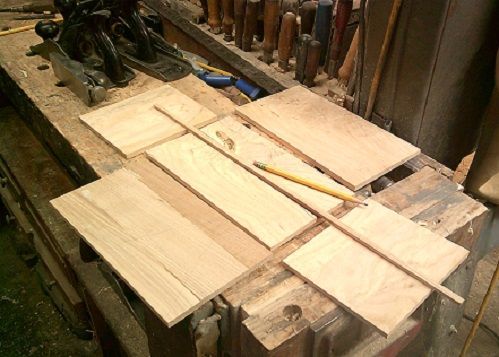

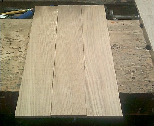

Ok..Making a couple panels, that The Single Brain Cell Sketch Up decided I needed to make...sorted through the dozen longer slats..:Cheer:

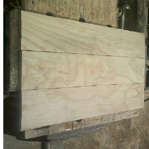

Panel #1 and...
Panel #2...both looking rather gappy....we have ways..:DevilLaughing:

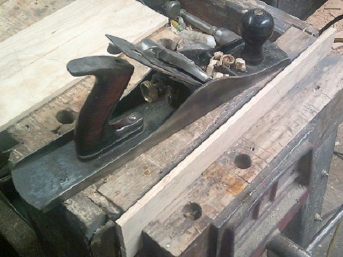

Straighten the edges were the Stanley No. 5-1/2c....to get things close.   Plane is a bit hard to keep level...so..:ChinScratch:

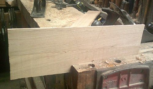

These 2 and a square, to refine things...dry fits to check for gaps...:OldManSmiley:
There is a light pencil mark, in the shape of a "V"...to help with alignment...Rinse and repeat..:Cheer:Until..

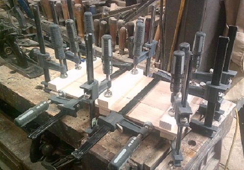

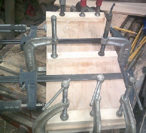

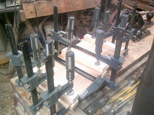

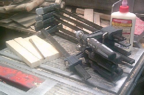

Glue, clamps and doubled cauls..:SaluteandRun:
Panel #1.   Set aside, and repeat everything for Panel #2..:Cheer:
Was running low on c clamps...used the 6" H-F ones, instead....pine scraps were cut down for the cauls...:TwoThumbsUp:
Now, as for the trimmed up fancy boards?   One with the split going ( Growing?) on, will become 2 drawer fronts...the one without the split, will become the top of the case...have to align the grain so it wraps down the front.  Panel #1 will be cut to form the two sides of the case.    Panel #2 will be the start of a base for the case..:OldManSmiley:

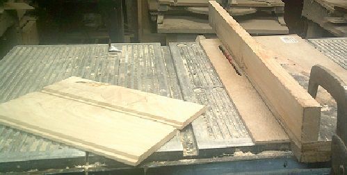

Got the drawer fronts ripped to width, for now..
Everything else went off the panel for the top of the case..
Had to rip the bottom panel for width..and get it flat ( drawer will be sliding on it..)

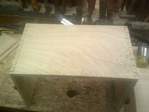

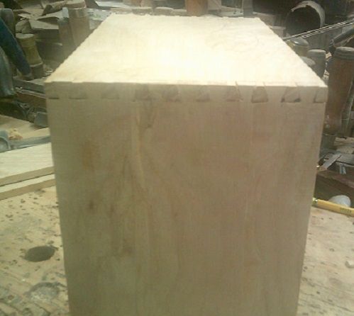

Lots of double and triple checking, THIS time...corner #2 is FINALLY dry fitted..:Tapping:

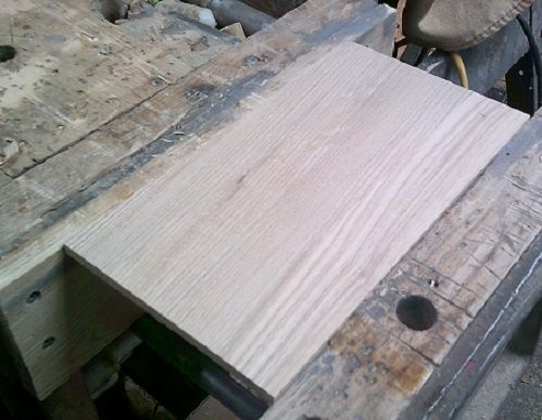

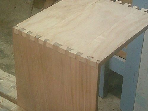

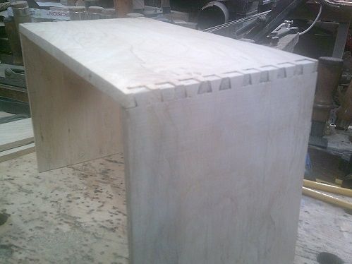

This is what one will see when looking down at the top of the caseB)

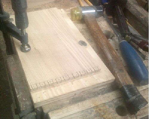

Laid out and sawed the pins for corner #3:TwoThumbsUp:
Extra "clamp" to keep things from moving around too much...

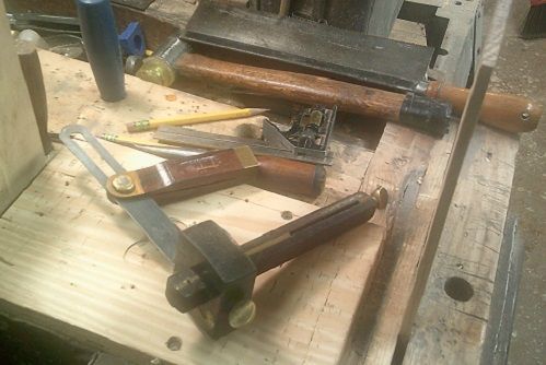

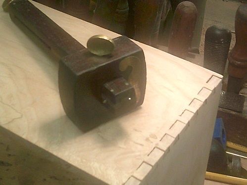

Ok...Layout tools..
Bevel Gauge by Stanley SW, 6".....Stanley No.77 SW mortise/marking gauge, Swanson 6" combo square..
Has a single pin on one face, and an adjustable double pin for marking out a mortise...
Where I spent half of the shop time...getting well worn?   Or, just broke in?

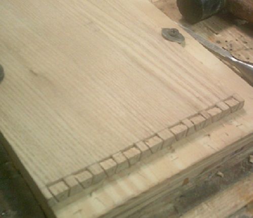

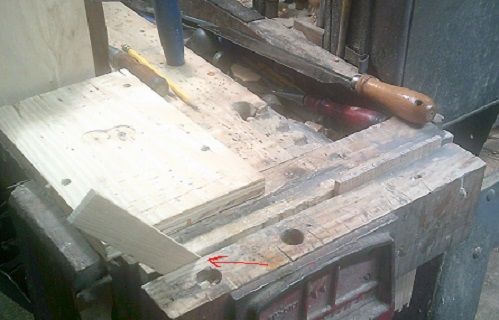

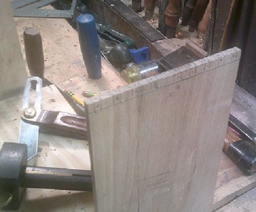

Set this up high, for better lighting..pins laid out ( this is for Corner #4, BTW)

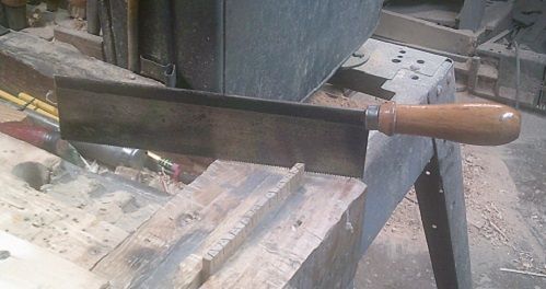

That stick is an Anti-racking Device...I drop the part down low, to make the saw cuts..
Last saw cut....then a bit of chopping..
Starting on the "Show Face" chop about half way down....prevents blow-outs when I turn it over and finish the chops..

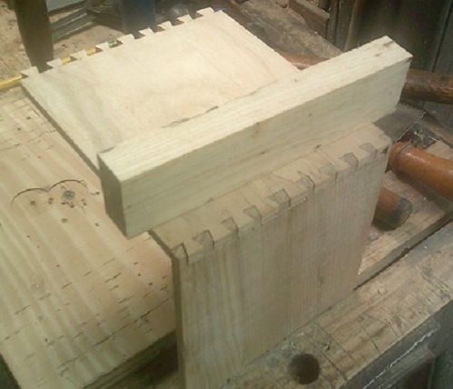

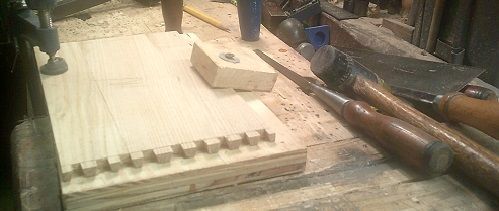

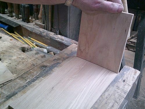

Pins are done.    Stand this up onto the side panel...chin to clamp things steady....SHARP pencil to trace around the pins...marking gauge to cut a baseline...bandsaw to cut the waste out...was a bit easier than chopping....just needed a small file for clean-up...dry fit #3 corner..

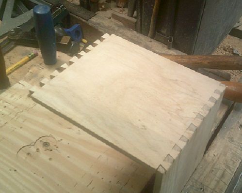

Almost right off the saw..rinse and repeat for #4 corner..
Getting better at this?    Corner #3 was a bit on the tight side, needed a "helper"..
Hitting the block means less damage done..full dry fit?

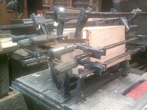

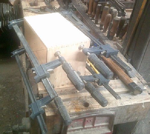

Well....glue-ups happen, I guess...:ChinScratch:

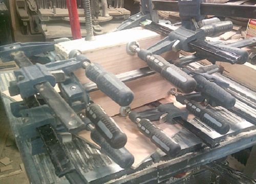

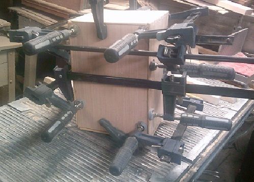

Clamps, cauls, Glue and a brush...hardest part?    Holding 2 cauls in place while holding a clamp in place on the cauls...and trying to tighten the clamp...at the same time:PullingHair:
Some cussing was involved?:ArguingSmileys:But...
Included a diagonal clamp..to pull things into "Square-ness":ChinScratch:
Letting this sit a spell...will see how it looks tomorrow?    Need to glue the back on...need a spacer block for that.  :OldManSmiley:

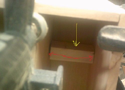

Back has been glued in place...after the case has been cleaned up and checked for square..
But...because that shelf the top drawer will ride on bowed up...I needed to add a spacer block..:OldManSmiley:

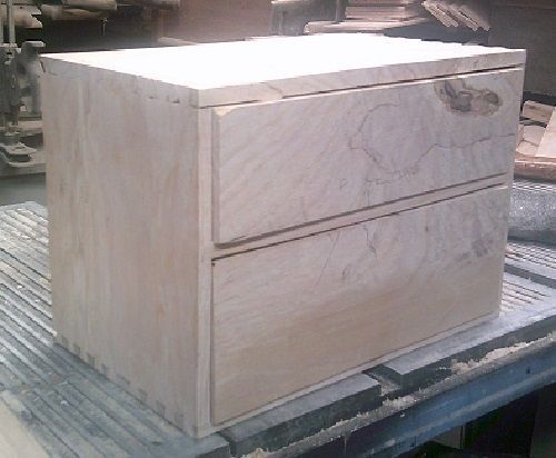

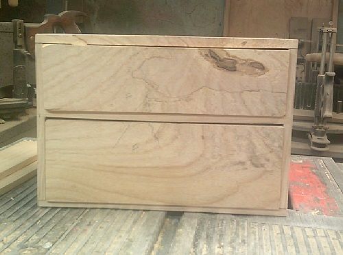

Today, the clamps came off, that spacer came out...time to see how well the drawer fronts fit..
Meh...These are supposed to sit flush with the front of the case..:WonderScratch:
Didn't want them to get stuck...and have to pry them back out..:ArguingSmileys:

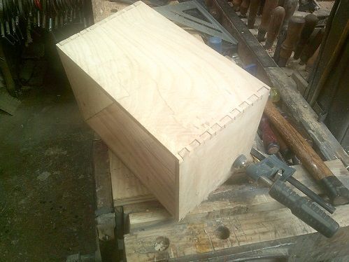

Plus a plywood panel for the bottom of the drawer...Decided to do the top drawer, today...
Front corners are through dovetails,  and the back sits in rebates at the back of the sides...plywood bottom then was cut to fit...

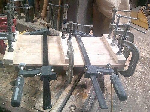

Dovetails glued up...back glued in place..bead of glue all around for the bottom panel...:ChinScratch:

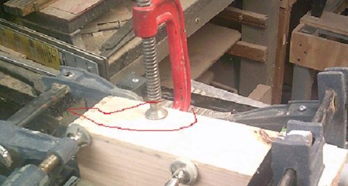

The red c clamp?:WonderScratch:
Had to fix a crack.:ArguingSmileys:..dovetails and the clamp to hold things in place, while the glue sets up.

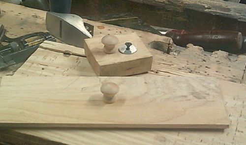

Also dug out a couple knobs for the drawers..:TwoThumbsUp:
These take a 1/4" dowel as a "tenon"...then are glued in place...thinking maybe one per drawer, centered up?:WonderScratch:
