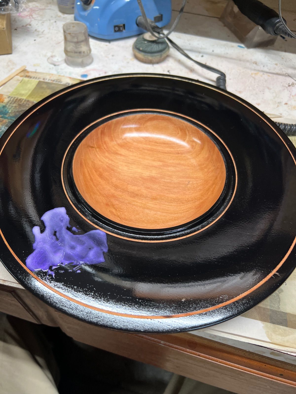

Almost completed today. Started by turning out the bowl. I have not left a bead above the bowl rim before and decided to try.
got a bit ahead of myself and remembered to take a shot of the hollow. After hollowing clear lacquer is applied. Now time for color.
This is what it looks like with paint. The wonder about the paint by Josana is that they all just look white so you have to label the cups you mix it in . Now to let it dry a couple days and then more clear lacquer.
That’s really cool! How did you keep the paint from getting into the grooves?
You paint before hollowing so the bowl is natural and the grooves are cut after painting. The purpose of the grooves is to stop the paint from going too far.
   The color on this is awesome but maybe my eyes are confusing me. Is this a picture of the inside of the bowl?
Actually it is more like a bowl with a very wide rim. The rim is decorated.
