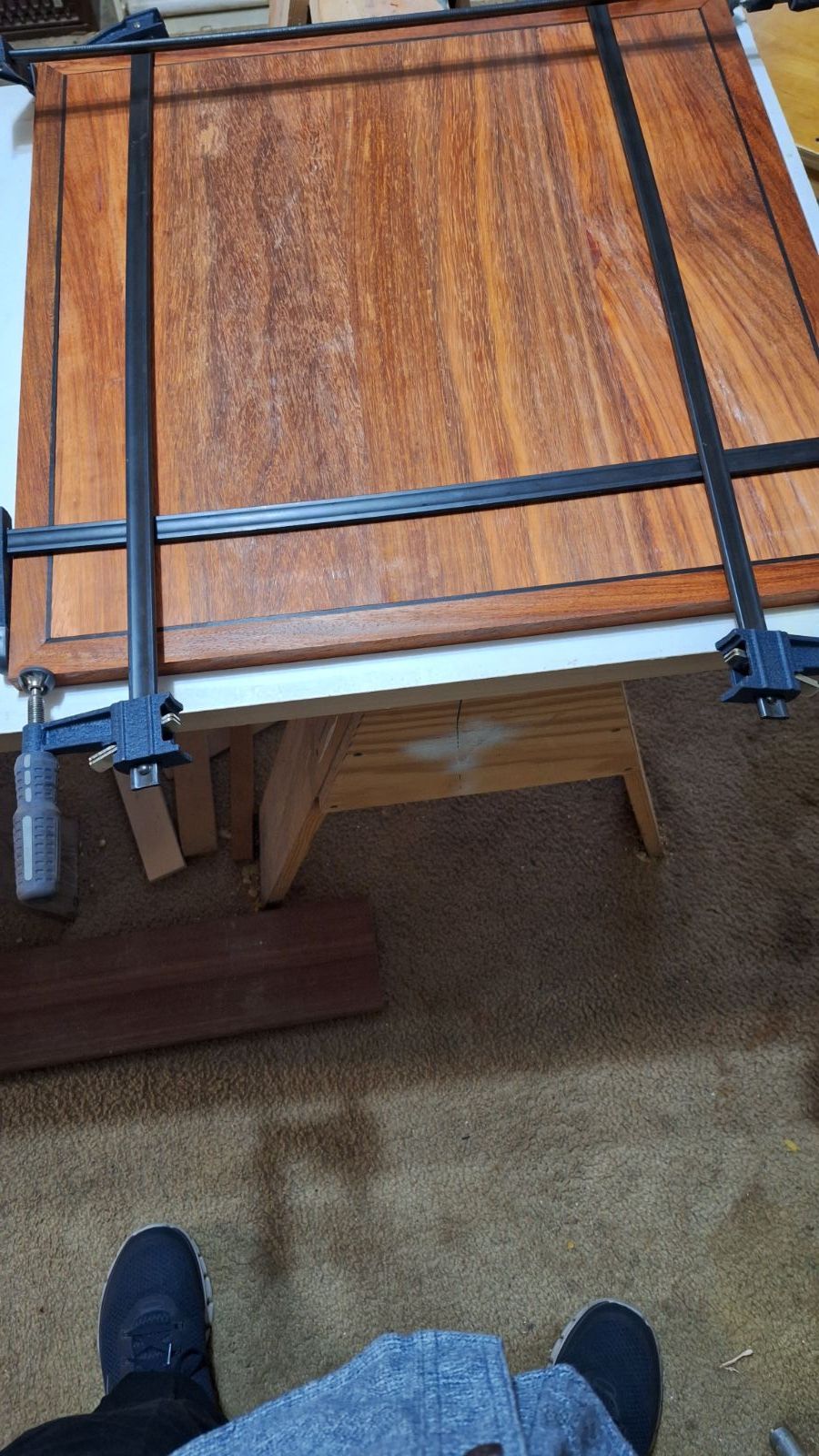

January 1, 20242 yr Author Popular Post comment_327045 Ok, time to catch up on my progress on the table. It's been some time since I posted on this project, so if I repeat myself, just chalk it up to old age. I have trouble properly matching captions up with their associated pictures, but I'll do my best. This is my completed tapering jig. The glued up edging with the ebony for the simulated inlay. This is the tapering jig almost set up to cut a taper. Yes, I know, it's on the wrong side of the blade. I did that intentionally because I discovered it's easier to set up that way without the blade and splitter in the way. Of course, I moved it over to make the cut. The mortises were done using my hollow chisel mortiser. This is the first time I have used it since making my work bench. Clamping it down so that I didn't wind up with it in my lap was a pain, but yet another learning experience. I have a pair of 12" bar clamps that I filed the stop off of from the end of the bar. Took that side of the clamp off, fed the bar up through dog holes in my bench and reinstalled the clamp. A little awkward, but it worked. Two more clamps on the front of the mortiser clamped it down to my bench the normal way, and it worked fine. After the mortises were cut and the legs tapered, I spent some time removing the inevitable burn marks on the legs. That's my progress so far. Next up is to fine tune the tenon to fit the mortises properly. Report

January 4, 20242 yr Author Popular Post comment_327216 On 1/3/2024 at 6:23 AM, Cal said: What is simulated inlay Tom? Those mitered corners are It's a simulated inlay in that the ebony does not sit in a groove. It is a layer surrounding the table, the full thickness of the table, with padauk surrounding that. Think of a sandwich with ebony as the meat, and the padauk as the bread. And thanks for the comment on the miters. That took some time and patience, but they turned out pretty good, if you don't look too close. Report

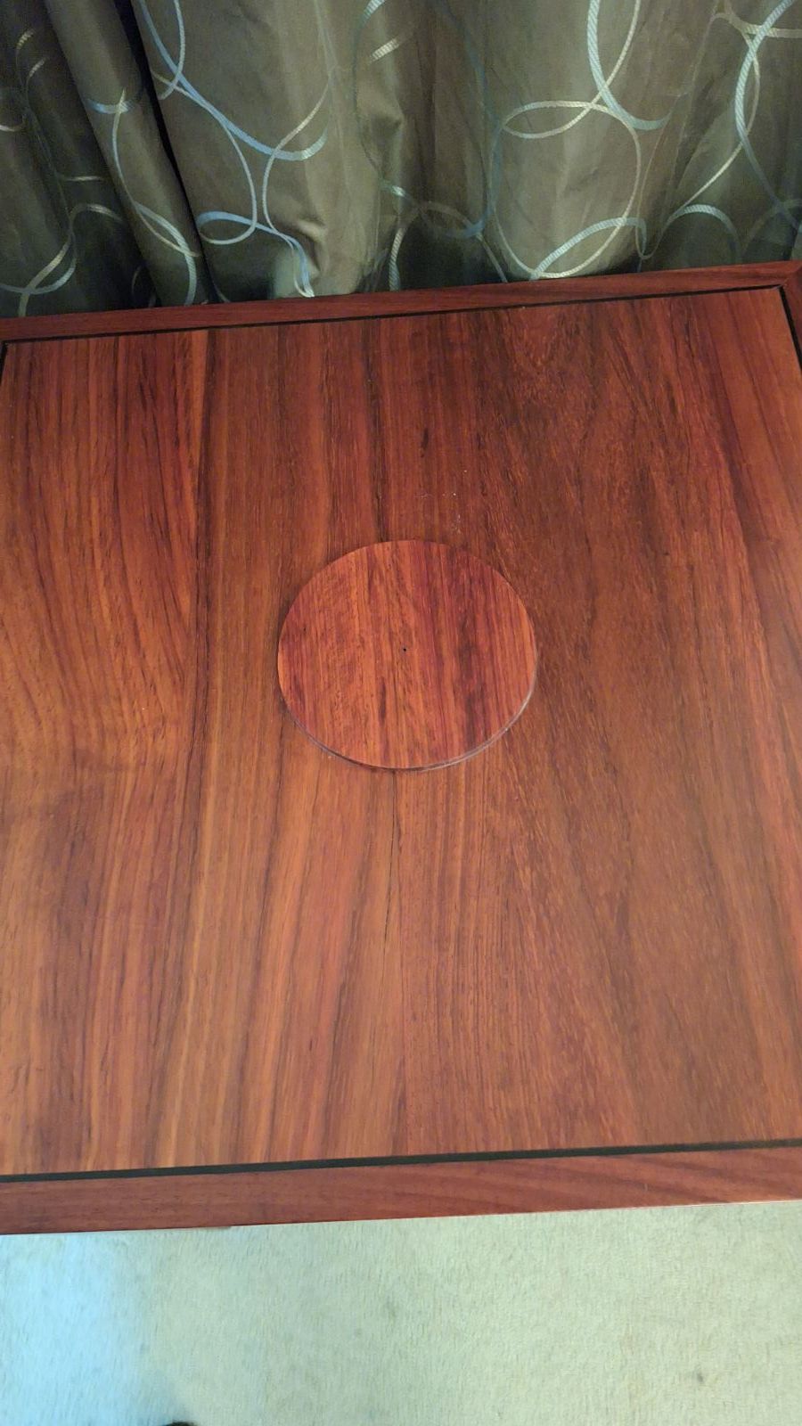

March 29, 20242 yr Author Popular Post comment_332691 Well, I finished the table. I had promised the gentleman who runs the thrift store where I bought the pitcher and basin that when I finished the table, I would bring him a picture of the finished product. That was about two years ago, IIRC. The finish on the top and legs was 3 coats of Zinsser Bullseye sanding sealer, and 3 coats of Minwax Helmsman spar varnish. Zinsser to get the shellac base coats, and Minwax to get the UV inhibitors. I have trouble captioning the pictures, so I will describe here. The top pic is the finished table. (Finally!) And the bottom pic shows the registration disk for the basin. Thanks for following and looking. Tt Report
March 29, 20242 yr comment_332699 Turned out spectacular Tom! Thanks for sharing the project build and the finished piece. Bowl and pitcher really compliment your build. Clever idea for the bowl registration too. Report
March 29, 20242 yr comment_332706 4 hours ago, PostalTom said: bottom pic shows the registration disk for the basin Beautiful work! That registration disk is a really great idea. Report
