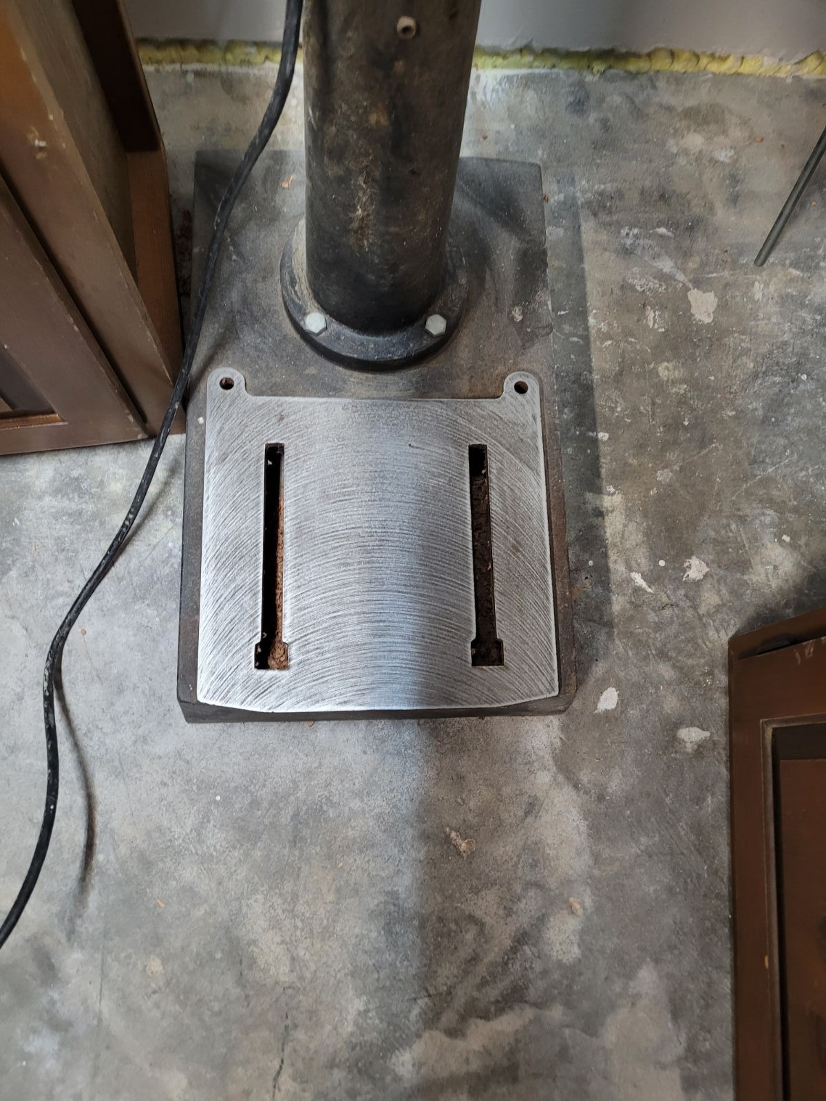

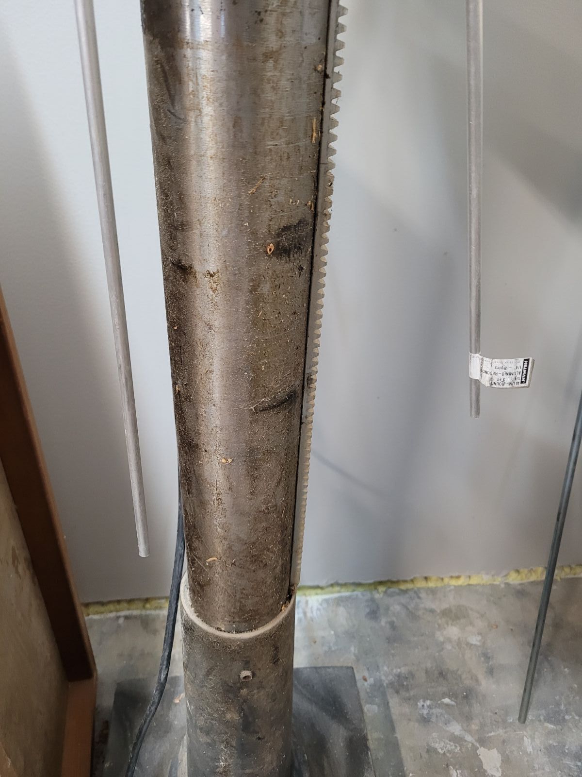

September 14, 20233 yr Author comment_321081 Before sanding 120 150 220. After sanding 120 150 220 and wiped clean with Mineral spirits. Looks much better. Any ideas what the foot of the drill press is used for? Any ideas on how to clean up the post. I would think wrap sheets around and twirl? Edited September 14, 20233 yr by Michael Thuman Report
September 14, 20233 yr comment_321085 MY DP looks much like yours, and for the column I'm thinking sanding strips (maybe the ones from HF), I'm not sure sheets would provide enough reach. In any case Ttat's the only way I would do it. Report
September 14, 20233 yr comment_321086 What Fred said. I'd start first by wiping it clean with some mineral spirits. Appears to me to still have some of the original protective cosmoline coating. It will just gum/load up your sandpaper. Report
September 14, 20233 yr Author comment_321088 Thanks for the sources I have ordered the 320 and 400 5" 5 hole. For the drill press with the rough surface I see no need to sand beyond the 220. I need some feed back on the pole please. and do you use wax or "Power glide" to lubricate and protect the cast iron surfaces. Report

September 14, 20233 yr comment_321092 The column is what I was addressing with the sanding strips, holding a long piece in your hands and working it back and forth is my plan. Report
September 14, 20233 yr Author comment_321093 1 hour ago, Fred W. Hargis Jr said: MY DP looks much like yours, and for the column I'm thinking sanding strips (maybe the ones from HF), I'm not sure sheets would provide enough reach. In any case Ttat's the only way I would do it. Thanks I will cut strips and work on it later today. Report
