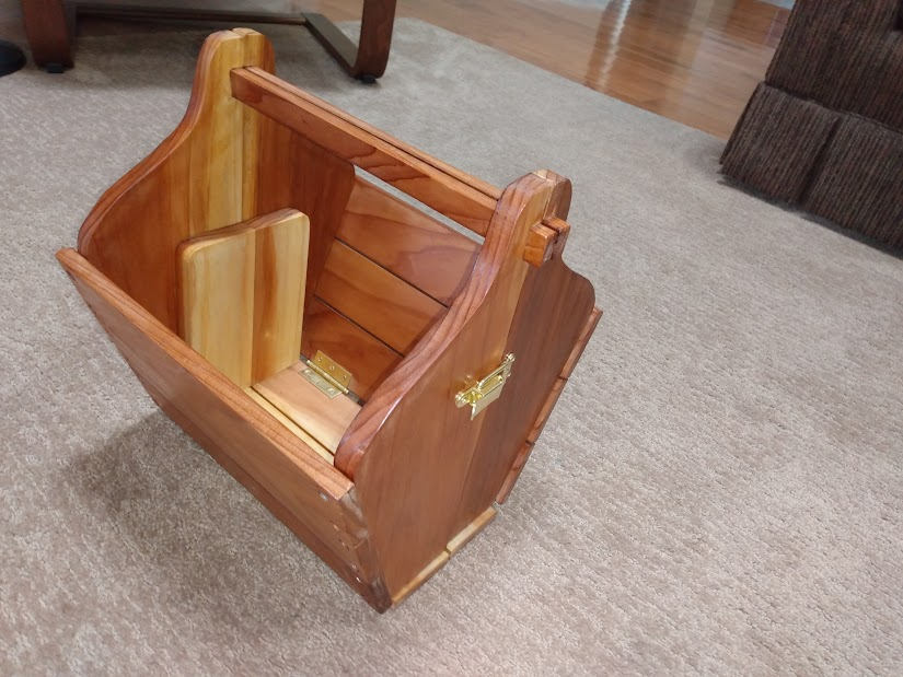

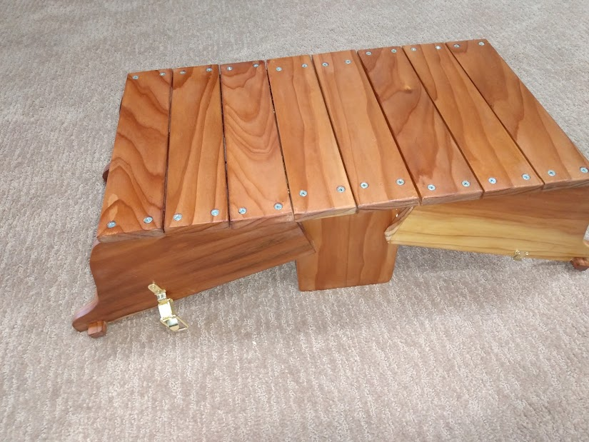

August 17, 20233 yr Author comment_319505 15 hours ago, steven newman said: Would like a pdf file plan for one of those...if you don't mind... Sorry, it was sort of "design on the fly" based on materials available. I ended up with dimensions taken from the first photo, construction similar to the video. I ripped an inch off the 1x4s to yield slats 2.5" wide. Two across the bottom, three up each side. For space between them, I just used a couple of nickles. The slats are about 3/8" thick and the end panels closer to 5/8". I did not make the end panels swivel legs, they are just two halves on each end. Overlapped the slats about 1/4" (spaced with a 5mm piece of plywood). Layout of the end panels just sketched out. Middle support leg ended up being 5x7 based on width of bottom and need for support. The one thing I wish I'd done differently is to cut out the slot for the handles before putting the whole thing together. Would have been much easier when all the ends were together. And not put so much carpet tape on the ends -- they were tough to get apart. Report
