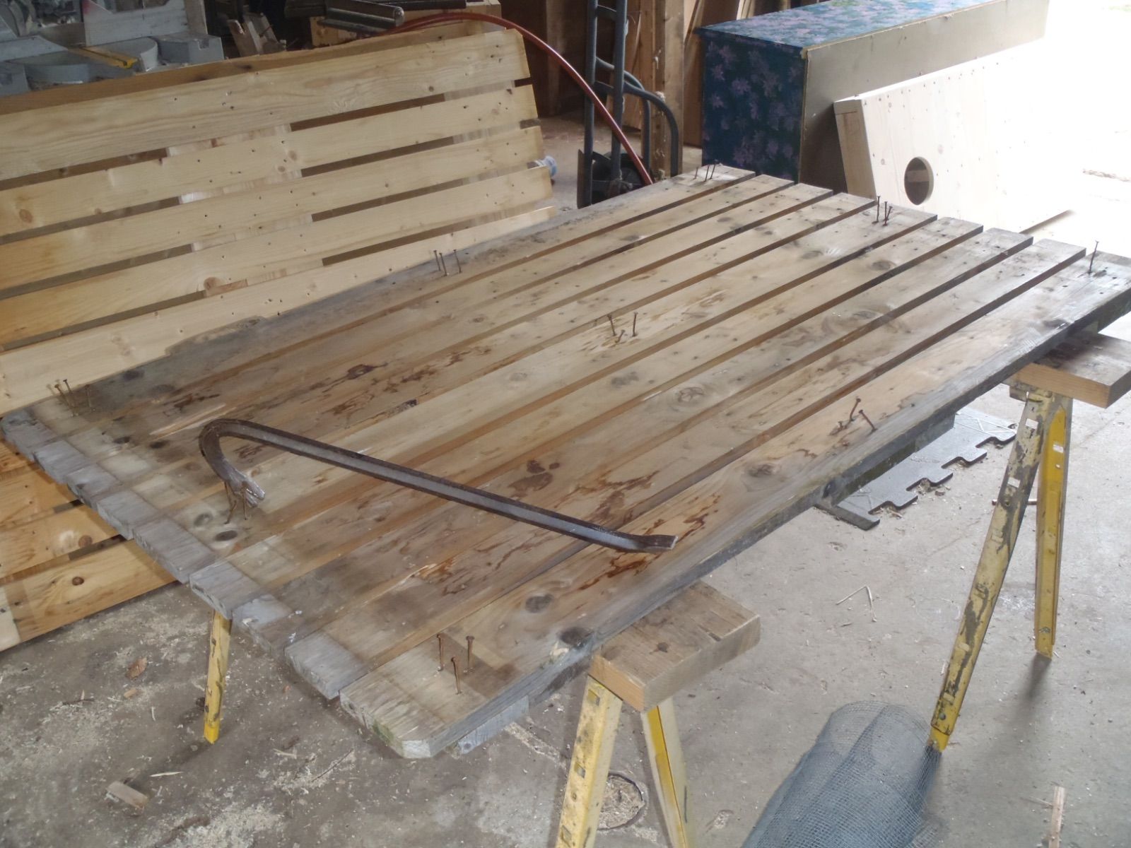

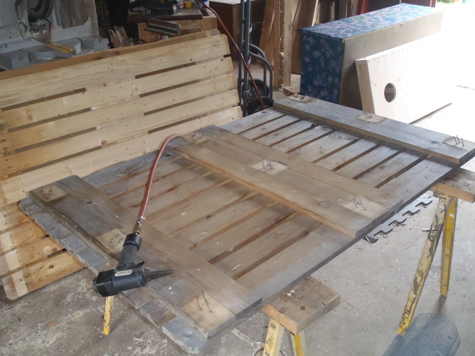

After removing the blocks and the bottom boards I used my pneumatic nail driver to drive out the bent and crooked nails. This gun is a lot faster then than doing it with a hammer.

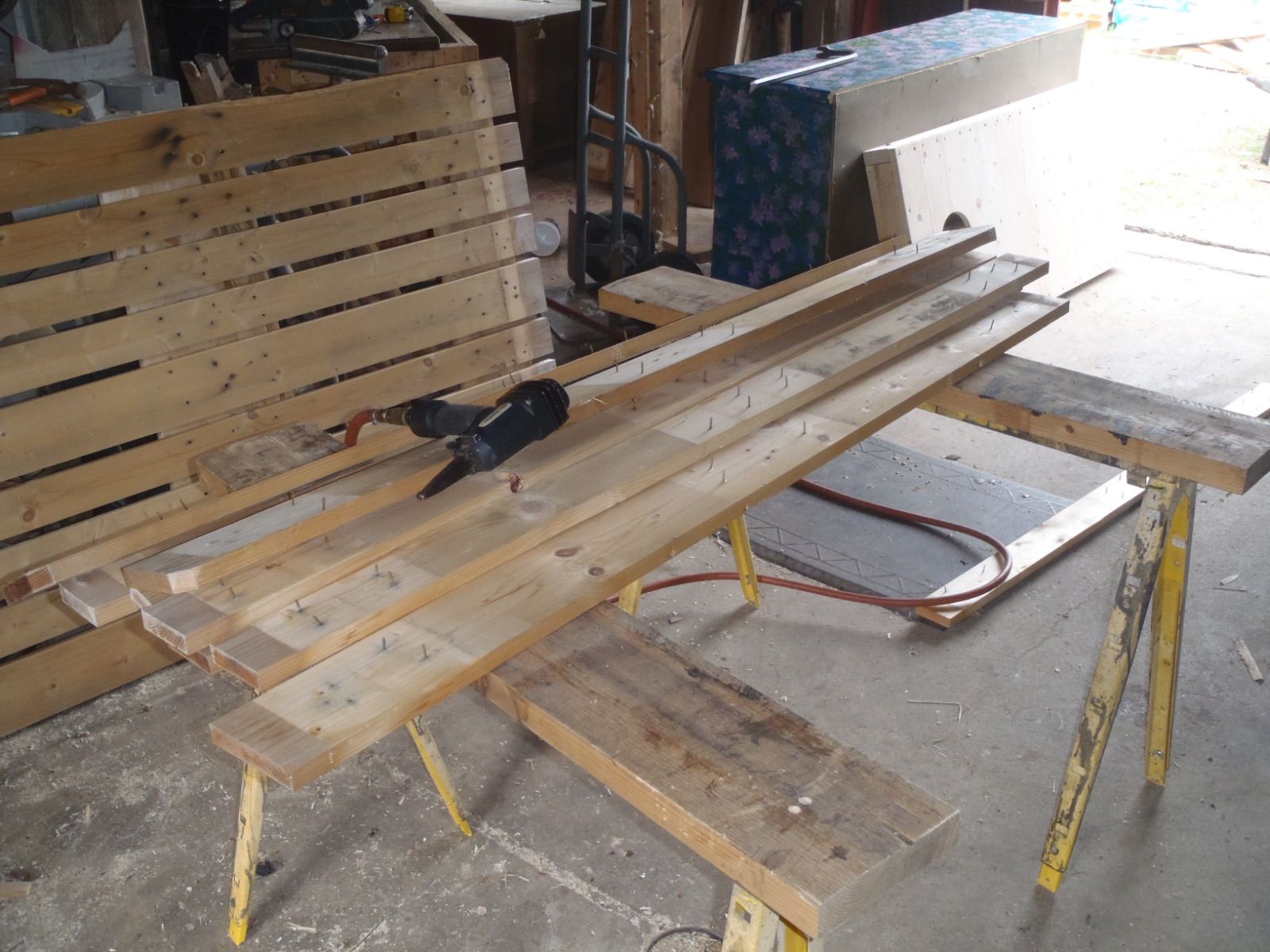

Then it's really easy to pull the nails.
It works great on the 1 5/8" nails

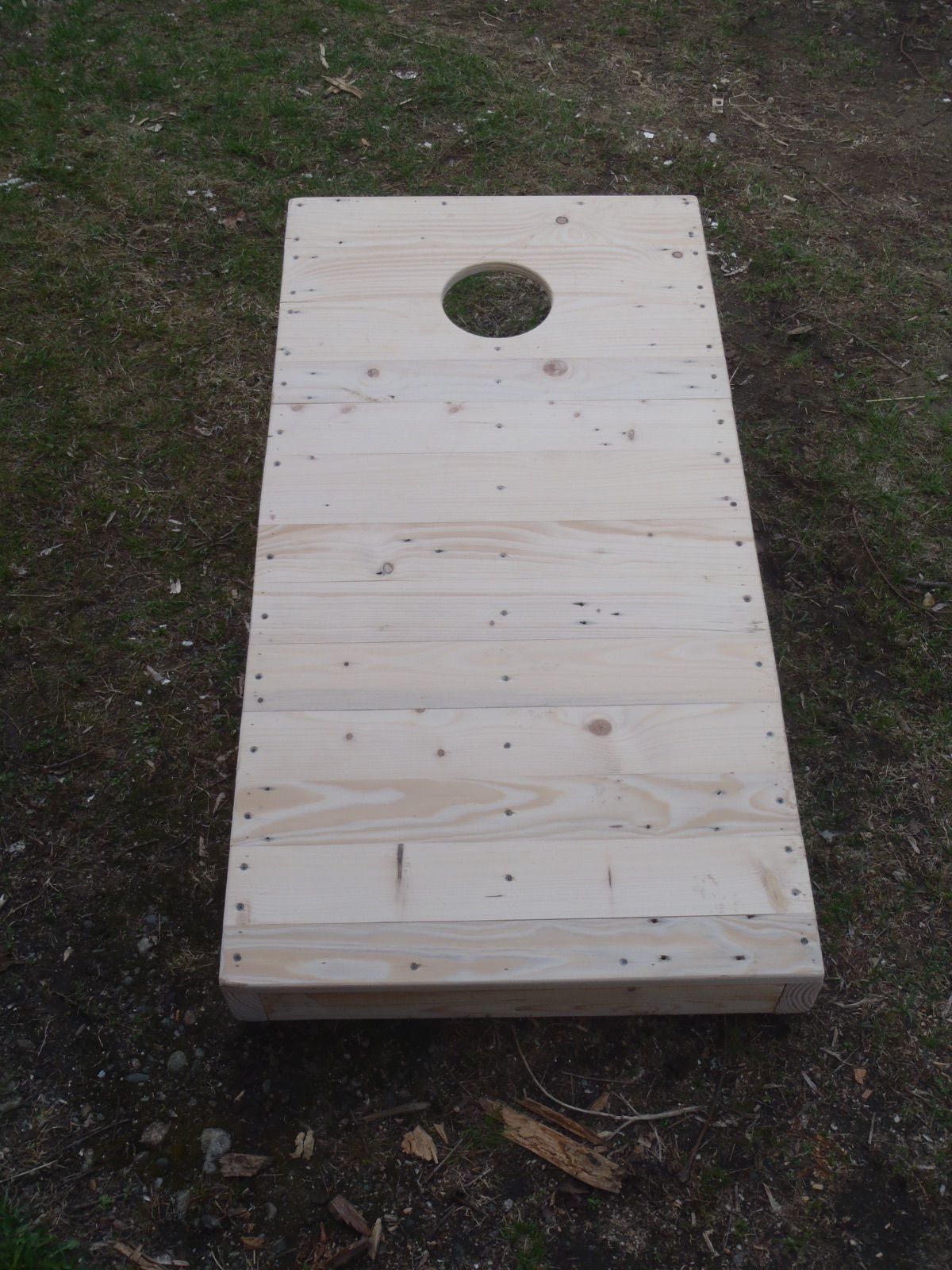

It takes a lot of prep to get these boards flat enough for a smooth finished product BUT for the price of a few dozen screws and four carriage bolts they will have their boards

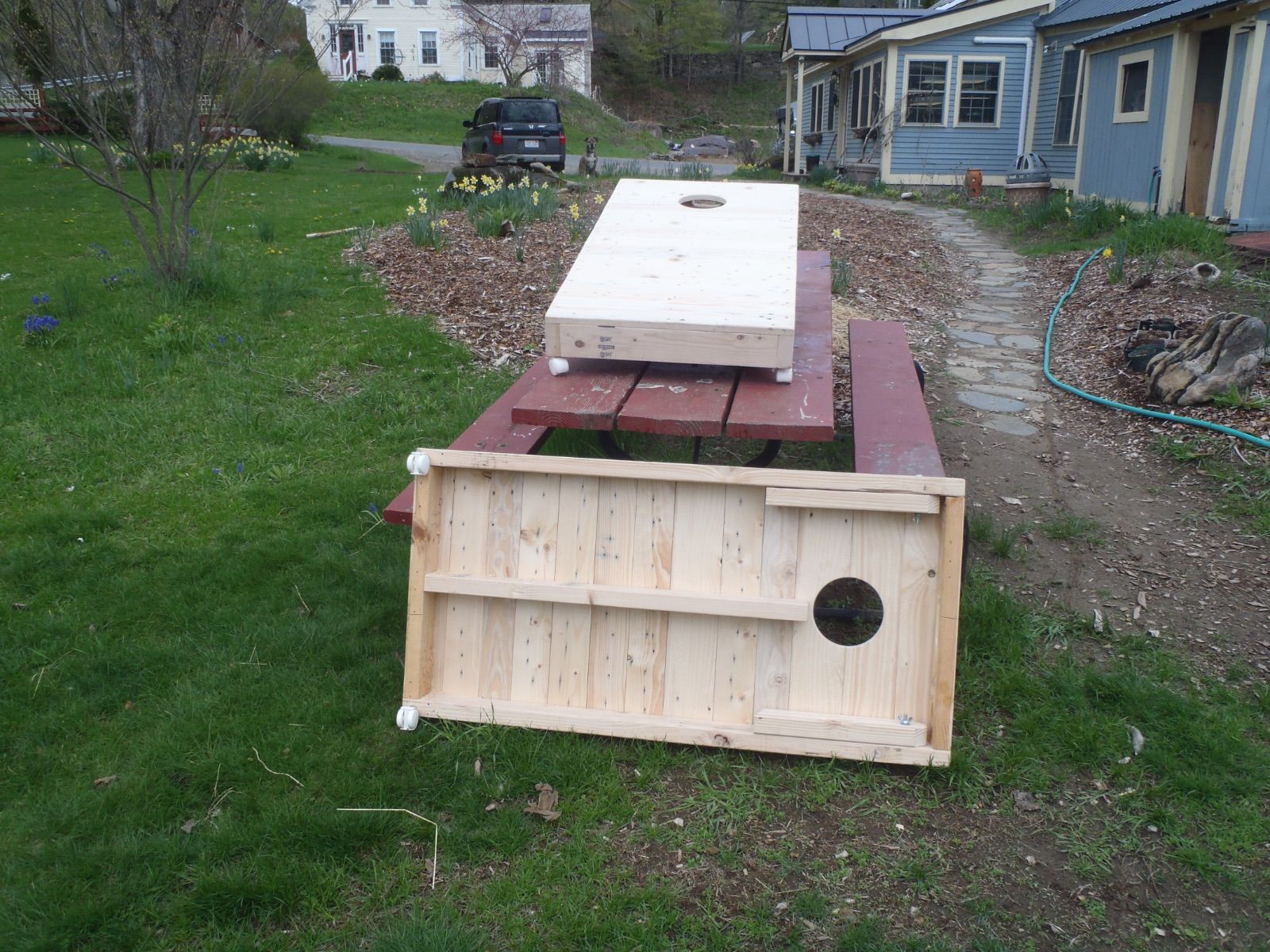

So I got the Corn Hole Boards built for the seniors.

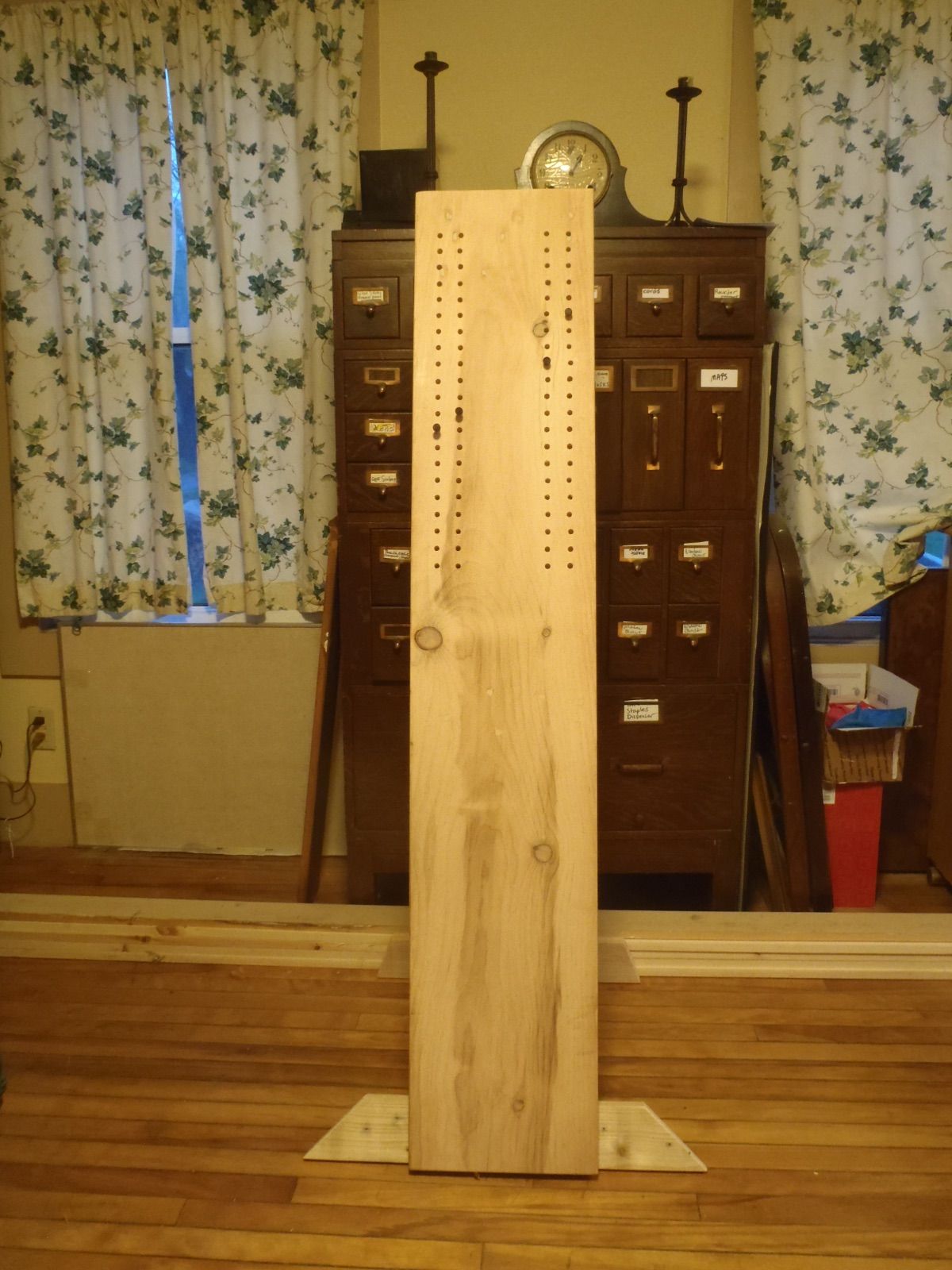

and built this piece so they can keep score.
One of the women has a kids' crafts class and they are going to paint them

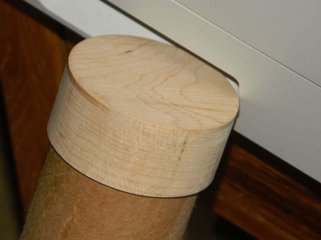

Only woodworking I did was a little CNC work.  My Grandfather was an Architect, and among my possessions is a complete set of home design construction drawings/floor plans/elevation views he designed and drew up for my parents.  In addition I have a book of plans/perspective sheets of 50+ house designs he did to show prospective clients.  I posted on Facebook that I was looking for a younger relative that might want to take these family archives and sure enough a nephew spoke up as wanting them.  I'm shipping these to him, and found a carboard tube for the construction drawings.  The tube was 1/2" too short and needed a cap.  I found a 1.25" thick scrap of maple and used my CNC to cut a cap to solve the challenge.
It has a 1/2" recess for the top of the drawings, and 5/8" of collar to slip over the cardboard tube.  I'll seal it with something before taping it down to ship to my nephew.

That is all round great 4D; that you still have some of the original work of your grandfather's, that someone in the family (next gen?) wanted them, and of course your CNC work :TwoThumbsUp:

Nice of you to build those for the old folks. The score board is great, too. At first, I thought it was a cribbage board.:rolleyes:
