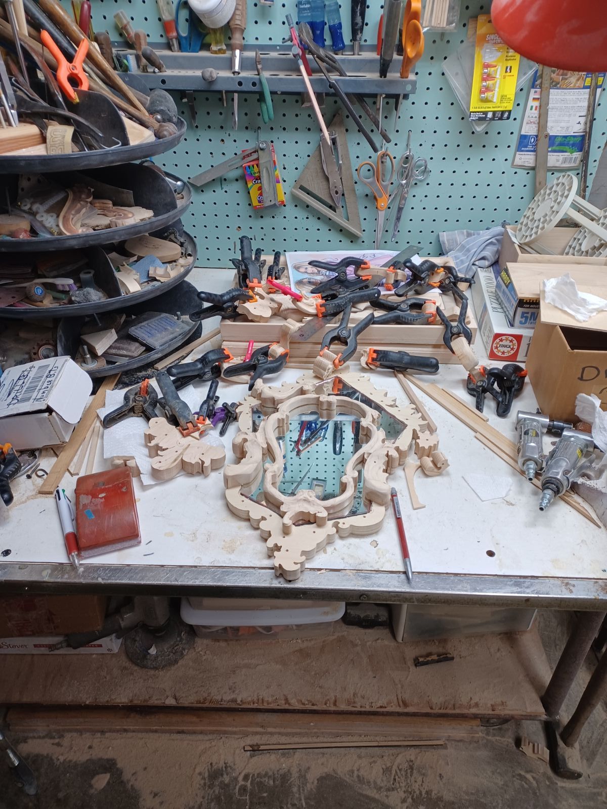

Popular Post Smallpatch Posted February 16, 2023 Popular Post Report Posted February 16, 2023 Thursday morning and lots of smoothing to do This is the hardest part of carving and this is what separates the boys from the men for not leaving any scratch marks on the carved pieces. Gene I used the same number blade for cutting the picture out then also for cutting all the pieces apart. # FD- SR 5 flying dutchman blade from The Wooden Teddy Bear. com It has nothing to do with all those teddy bears for it a wood working site. Order them 1 gross at a time and they will be much cheaper than the blades from the big box stores. I built this blade holder the week I bought the 788 in 98 or 99? I used 1/2" pvc with wood plugs in the bottoms. Can't remember for sure but there must be more than 20 tubes for blades and I bought some of all I could find to buy, anywhere........ fast forward, all those blades are still in that nice little storage container. Only two other blades I ever use is an Olson blade for metal sawing with the scroll saw...which has no teeth at the bottom of the blade sticking up from The Teddy bear.com and an Olson precision cut blade for cutting away the out side of the carving pieces I don"t need. Its also a reverse tooth # 5 but it saws and last longer but when new it wants to go faster????Only word I have for it as it is more agressive but not as easy to precision cut when needed on inside sawing!!!! And its from The Teddy bear.com also. This carving I\m working on now I used the same blade. This bull I'm shooting at you are my own opinions. Lot of people out there has more opinions than they got brains and again this is just my thinking... Lots of wood to smooth so I'll check in when more has been done. FrederickH, Grandpadave52, Gene Howe and 2 others 4 1 Quote

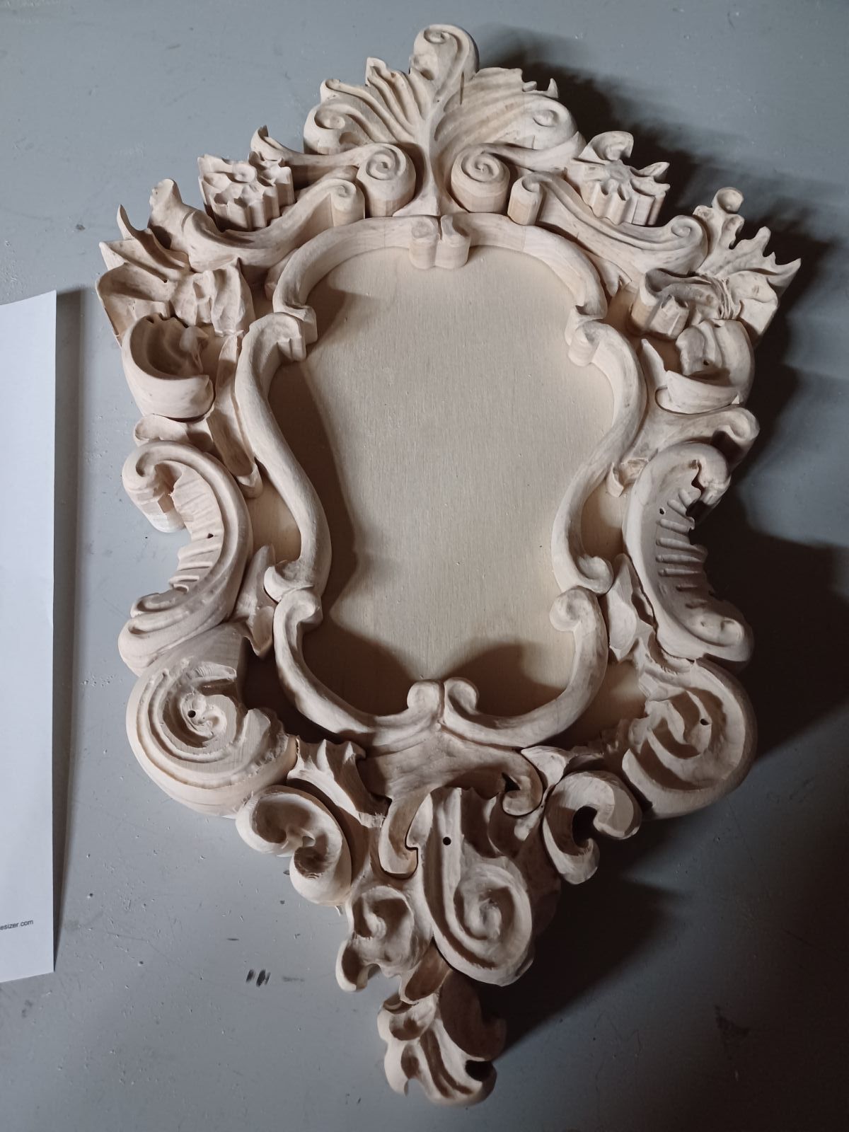

Smallpatch Posted February 17, 2023 Author Report Posted February 17, 2023 No clock, just a mirror FrederickH, Sherri Marx, Cal and 1 other 2 1 1 Quote
Smallpatch Posted February 17, 2023 Author Report Posted February 17, 2023 By the way, this picture was taken wednesday morning for I had a goof up and had to work on every piece with glue before I could continue this morning, Thursday. I'll explain someday. FrederickH, Grandpadave52, Gene Howe and 1 other 3 1 Quote

Sherri Marx Posted February 17, 2023 Report Posted February 17, 2023 13 hours ago, Smallpatch said: No clock, just a mirror I like it upside down . Can you stain it medium brown? Grandpadave52 1 Quote

Smallpatch Posted February 18, 2023 Author Report Posted February 18, 2023 this is first picture here since I got the rebuilt computer repaired again... I think this is so old 2014 that even though they did say the new Microsoft 11 would be installed I believe some of the safety features are not there for they were not invented back then.. I think I goofed for buying a rebuilt computer through Walmart but it cost us nothing for we use their card and get points. They fixed it but it cost us freight one way. This is the picture I finished the carving part and just wanted to see if this part of the computer is working. Grandpadave52, Headhunter, Sherri Marx and 1 other 3 1 Quote

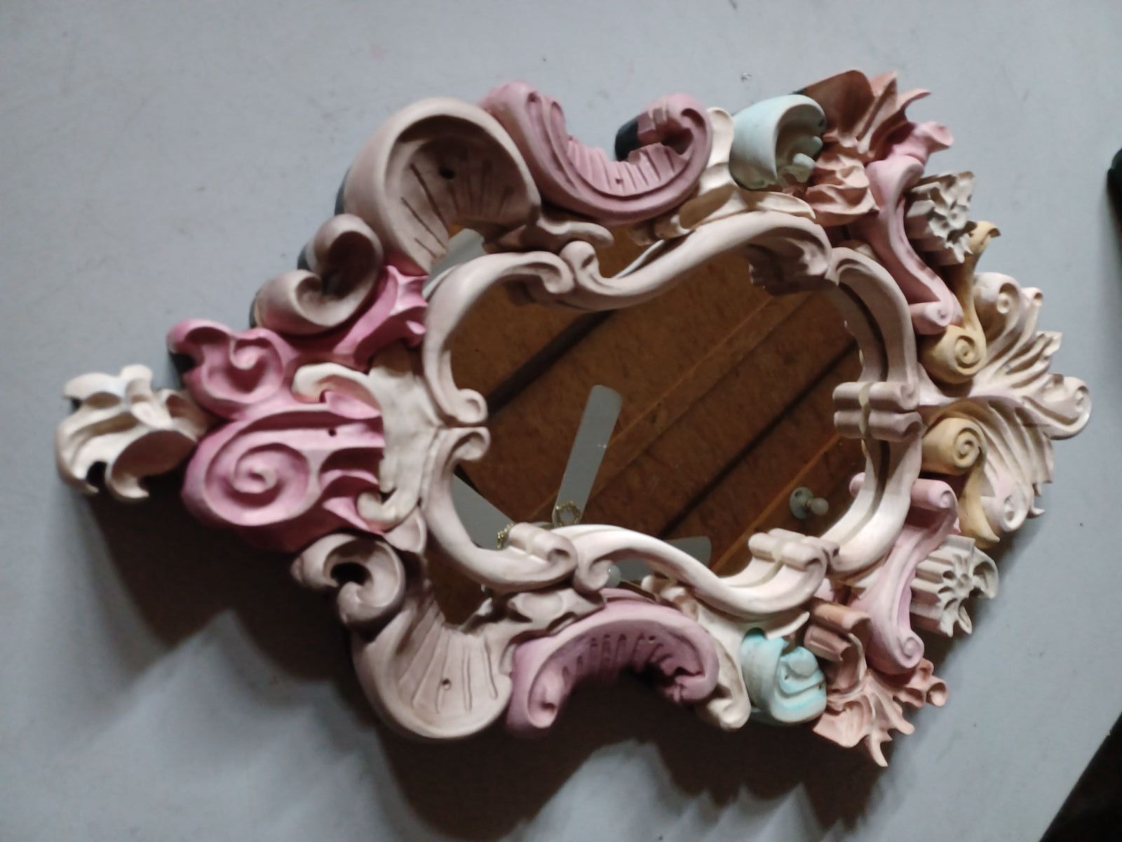

Smallpatch Posted February 21, 2023 Author Report Posted February 21, 2023 Sherri, what can I do to the phone to stop the blurry picture when I have a mirror in the middle of the picture. It acts like it is set on infinity and the closes images gets the blurrs. The light bulb looks okay!!! Grandpadave52, Al B and FrederickH 3 Quote
Grandpadave52 Posted February 22, 2023 Report Posted February 22, 2023 That's really cool Patch. Especially that little light right in the middle. Headhunter and Gene Howe 2 Quote
Gene Howe Posted February 22, 2023 Report Posted February 22, 2023 Another beautiful example of your scroll saw and carving skills, Jesse. Grandpadave52 1 Quote
Smallpatch Posted February 22, 2023 Author Report Posted February 22, 2023 finished and ready to start another Sherri Marx, Headhunter, FrederickH and 1 other 3 1 Quote
Grandpadave52 Posted February 22, 2023 Report Posted February 22, 2023 Well done Patch. I think you've got the hang of this now Sherri Marx 1 Quote
