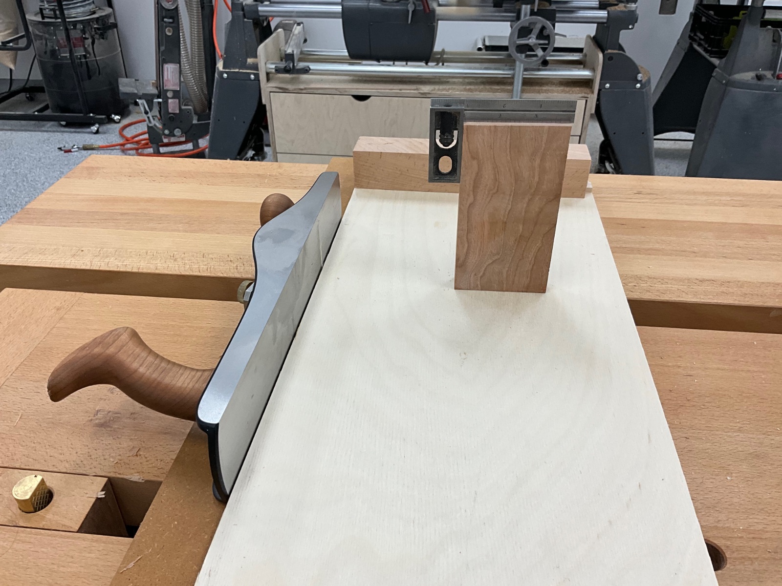

Shooting board is pretty much done.  Designed to be used with a Lie-Nielsen No. 62 low angle jack plane using a non-radiused jointing blade (which really needs to be sharpened when I get a moment).  The dado in the first pic is a 5/8” x 1/4” deep and is fitted with a 1/2” thick hardwood insert. This doubles as a stop for planing thin stock.
Taller stops like the one on there in this pic as well as other jigs can be attached by simply routing a matching 5/8” dado on the new jig.  Useful for making angled jigs for various purposes.  I will make up a 45* here shortly and test that out.
My little square says this is close enough for practical purposes…
