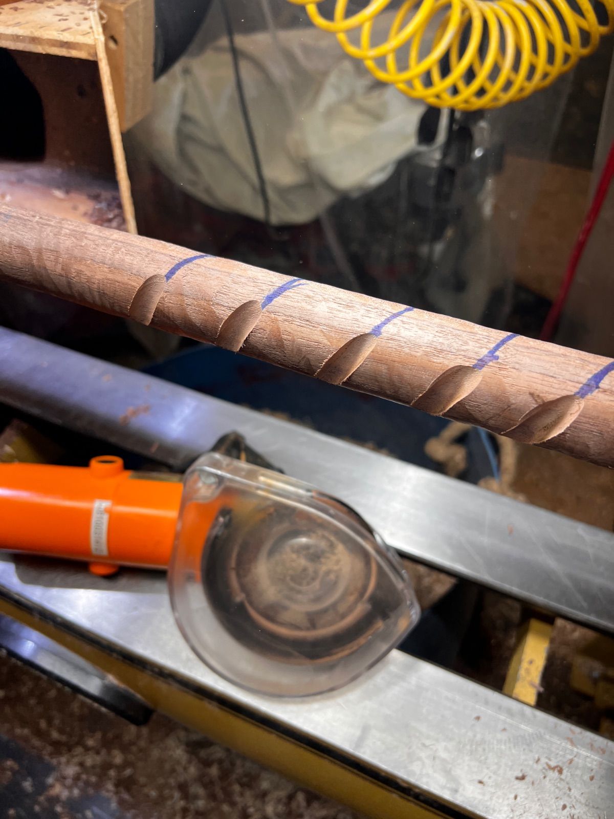

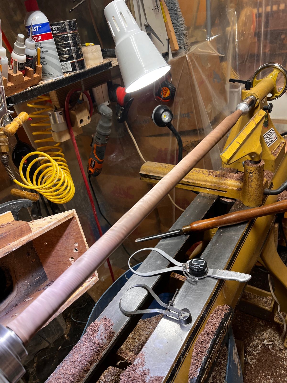

February 9, 20233 yr Popular Post comment_308262 Wouldn’t ya know it Woodturner gets new knee and still has not turned his cane. I prototyped the design yesterday and turned the cane in walnut to day. Used a string to lay in the twist. Doing both right and left twist. Start cutting tomorrow if all goes well. Report
February 9, 20233 yr Author Popular Post comment_308268 Yes . Will use Arbortech for first cut, then files and rasps with a bit of spindle sanding before final had sanding. Report

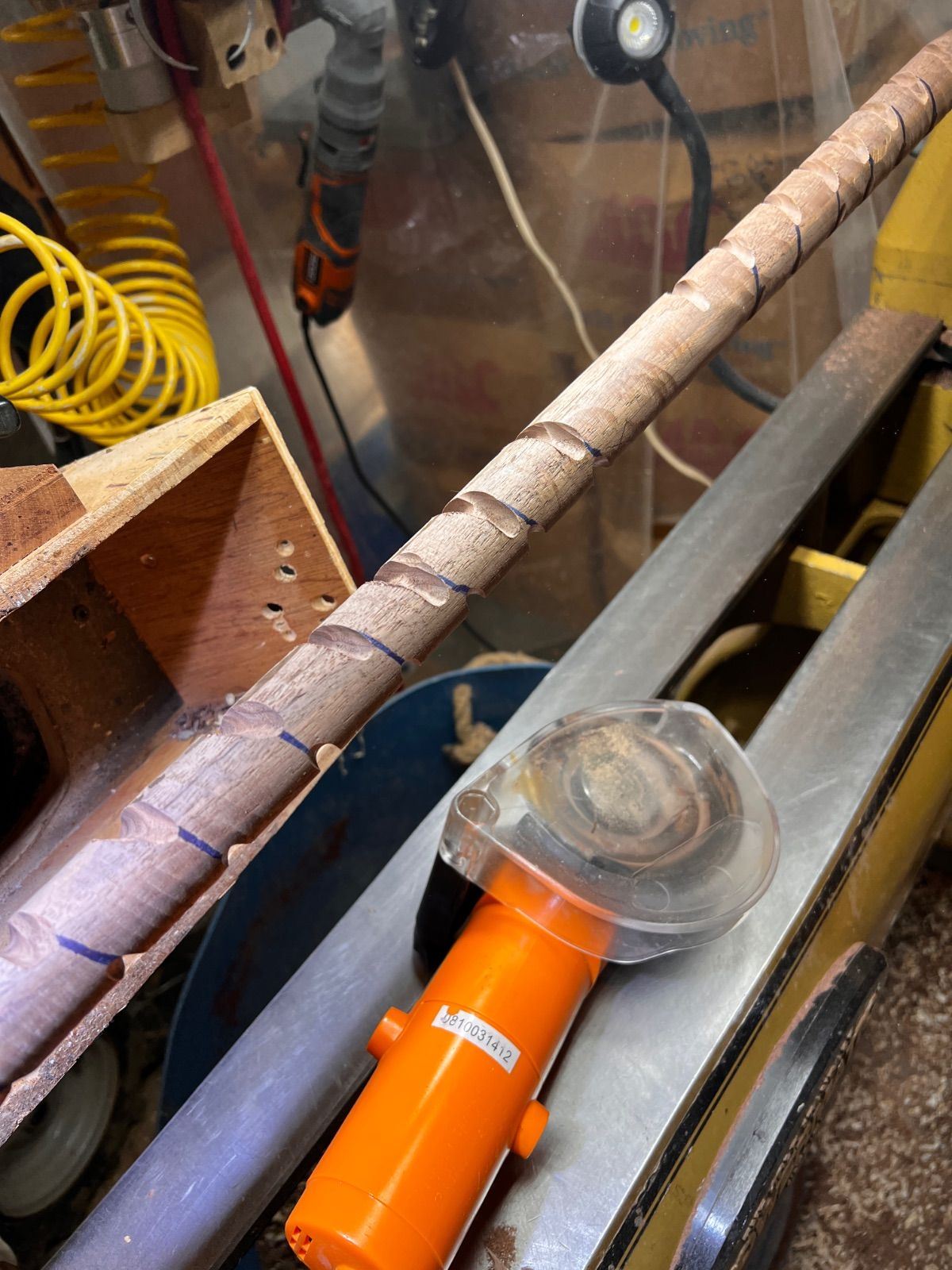

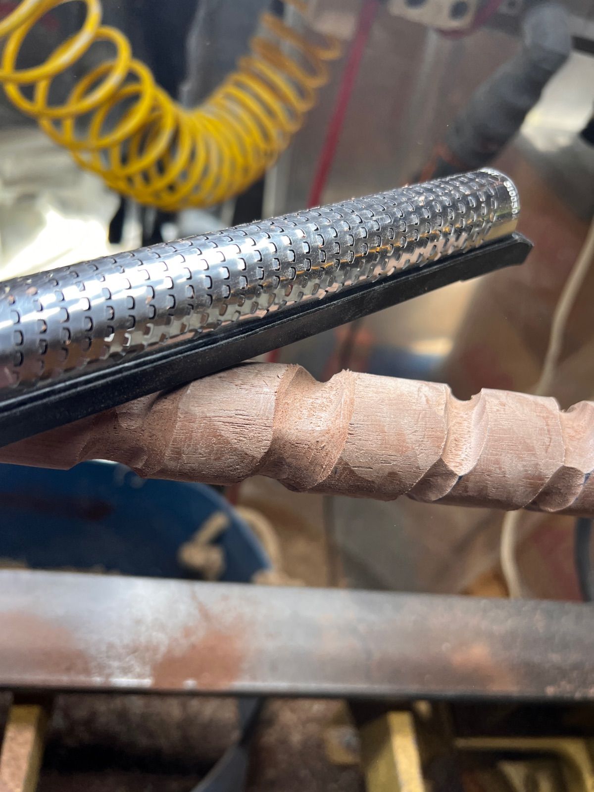

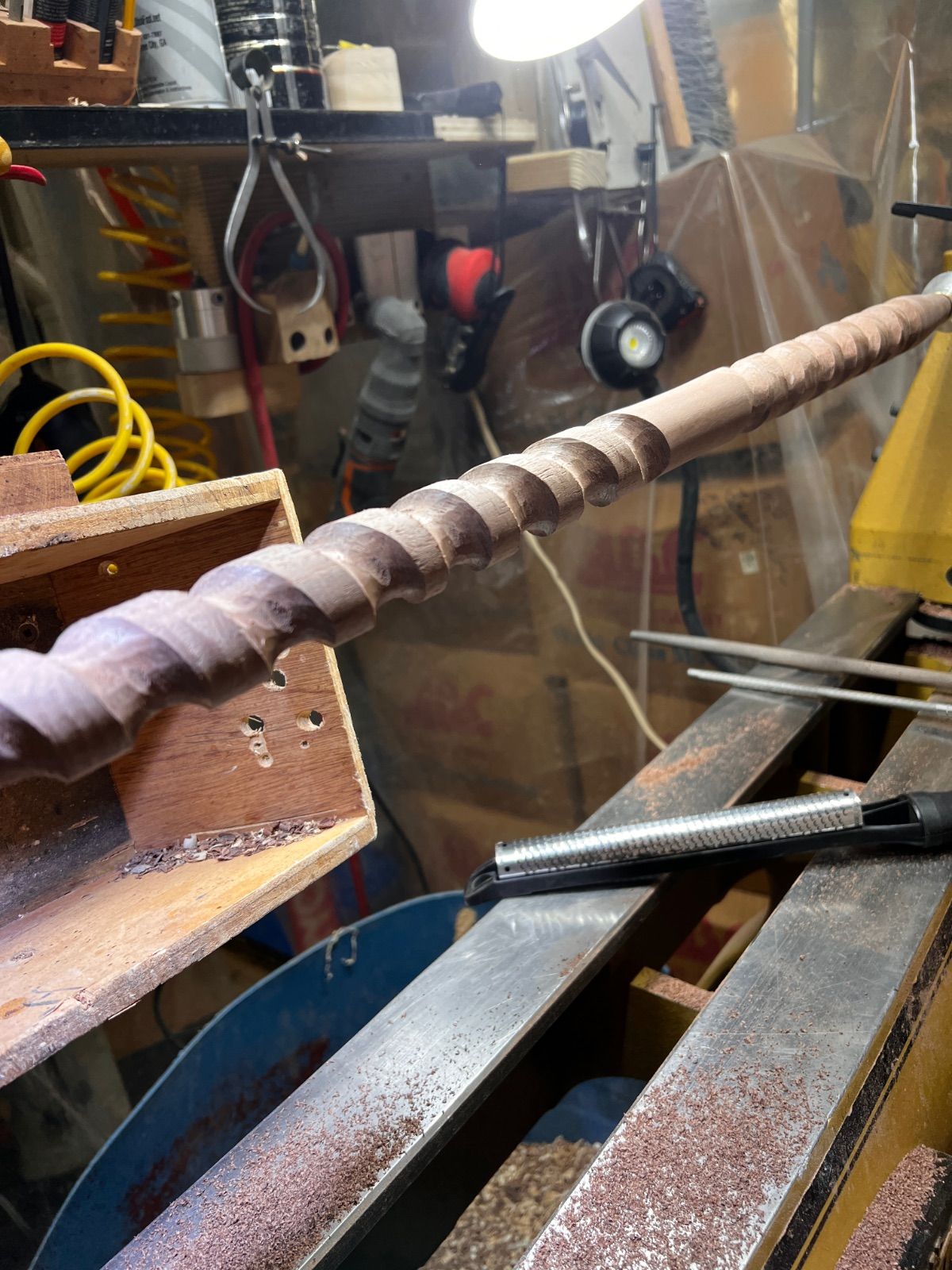

February 10, 20233 yr Author Popular Post comment_308378 Time for a big step forward. Started by cutting the line 1/4 inch deep with Arbortech 4inch wheel. Then use a micro plane file to smooth bottom and widen the cut. Also round wood rasps will help at this stage. Now on to the occilating spindle sander . The sleeves wanted to spin on rubber shaft so I used the round end of the belt sander. Now to round over those shoulders done partly on belt sander and part with hand sanding. Not yet done . A lot more sanding and maybe a bit of wood burning to add a bit of flair. Report

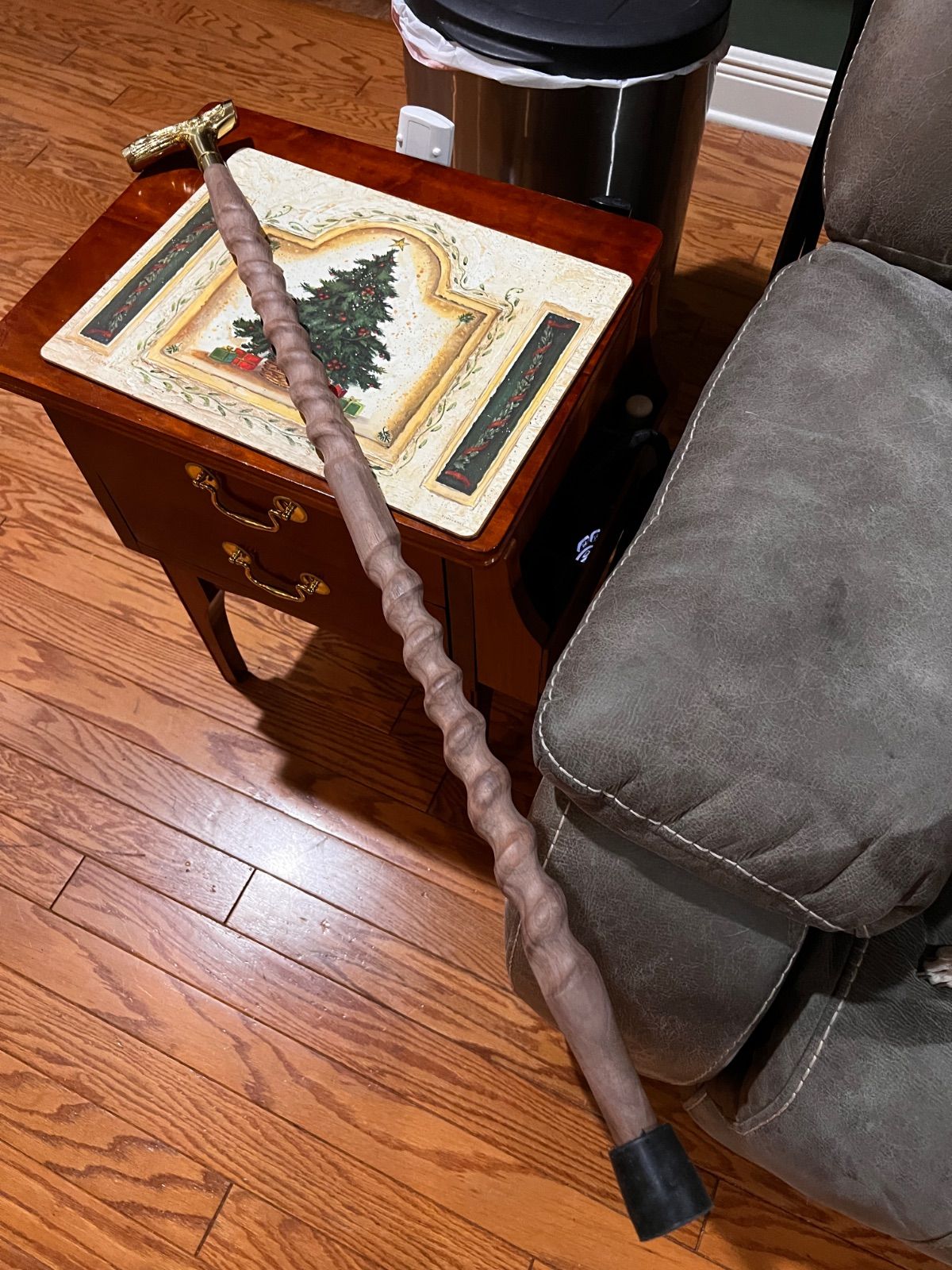

February 11, 20233 yr Author Popular Post comment_308435 Found the handle on eBay. After doing all the cutting in one day and most of the sanding it did not take as long as I thought it would. I put down a couple coats of lacquer yesterday and burned in a Celtic pattern and added color. Edited February 11, 20233 yr by Gerald Report
February 12, 20233 yr Author comment_308465 Thanks for the comments. The wife likes it but said it is heavy, which it is..Half or more again than the one she bought. Report
