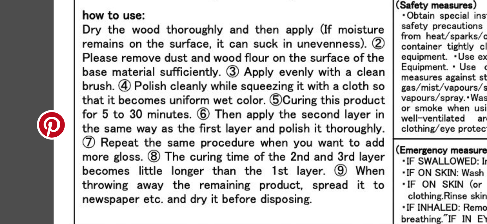

John Morris Posted January 1, 2023 Report Posted January 1, 2023 I have been curious about this finish that I found on Woodspirit Handcraft's website. It appears to be a food safe "ceramic" coating that penetrates and leaves a natural protected finish. I don't know anything about it, other than what I have read at Woodspirit. It looks interesting, any feedback greatly appreciated, @kmealy if you know anything about this? Or by reading the label can tell us your opinion on the product? About Hassui Ceramic — WOODSPIRIT HANDCRAFT WWW.WOODSPIRITHANDCRAFT.COM lew, Gene Howe and Cal 2 1 Quote

Masonsailor Posted January 21, 2023 Report Posted January 21, 2023 It says to polish in between coats but doesn’t give a clue as to how. Any ideas ? Paul Cal 1 Quote
John Morris Posted January 21, 2023 Author Report Posted January 21, 2023 Ya, in the small crafts circles such as spoon and bowl carving, and traditional chair making, it just means to rub it in, use steps 3 through 7 as often as you deem necessary to achieve your final sheen. Keep in mind Paul, this is not a cabinet grade finish, it's purely a hand rubbed finish for smaller arts and crafts and small furnishing such as chairs and such. I don't think I need to tell ya, you been around this craft a long time, but in the genre of woodworking I am involved in, which is crafts and chairs and small furnishings, we don't typically paint finishes on, spray or use any commonly used methods that involve the Varnishes and Lacquers and Poly's and such, we'll use hand applied finishes and rub in finishes, in our work we don't want the layered look of finishes, we desire the "in the grain" appearance of rubbed in finishes. If I am not mistaking, the Hassui finish is along those lines, rubbed in and buffed by hand. I hope this helps ya Cal 1 Quote

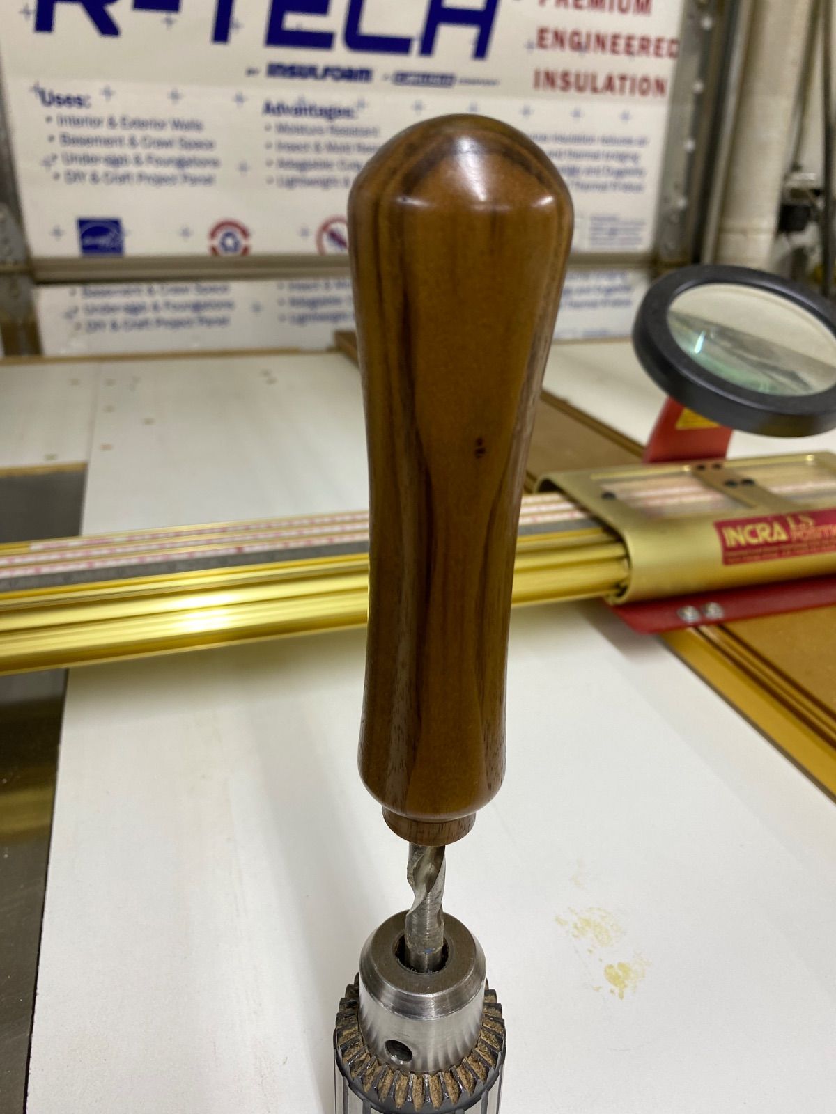

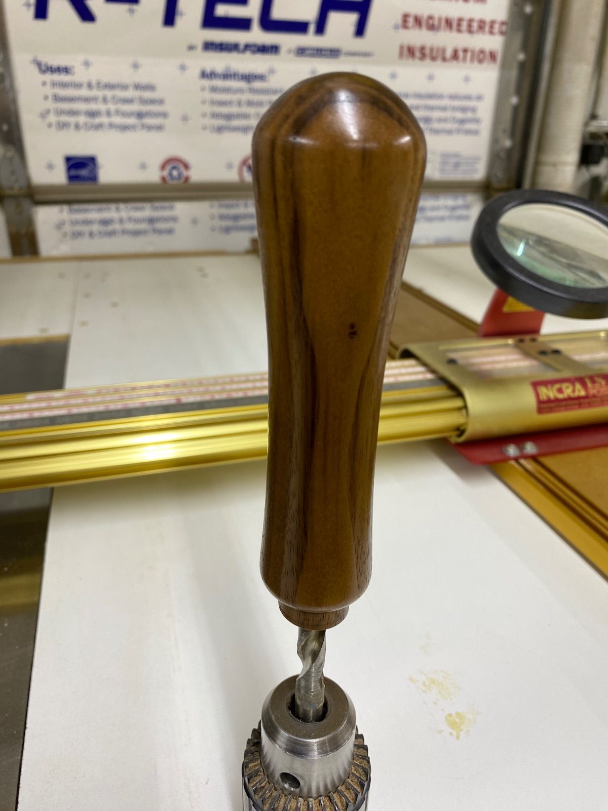

Masonsailor Posted January 24, 2023 Report Posted January 24, 2023 I made another ice cream scoop handle today to try out this new finish. First coat is on, pretty much looks like the first coat of any oil finish. I will take this one to gloss just to see how this stuff looks. Paul Cal, HandyDan and Headhunter 3 Quote
Masonsailor Posted January 25, 2023 Report Posted January 25, 2023 Today I put 4 more thin coats on and it’s pretty glossy. It’s very easy to apply with a rag and dries very fast. I was waiting about an hour between coats but I think it was usually dry at about 30 min. All the coats were very light. I might try one more coat and make it a heavy coat to see what happens. So far it’s very easy to get a perfect glossy finish in one day which is great. Paul Gerald, Headhunter and Cal 3 Quote
