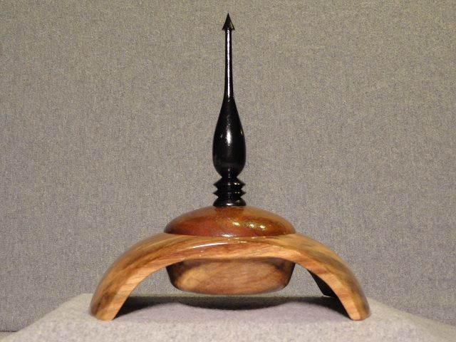

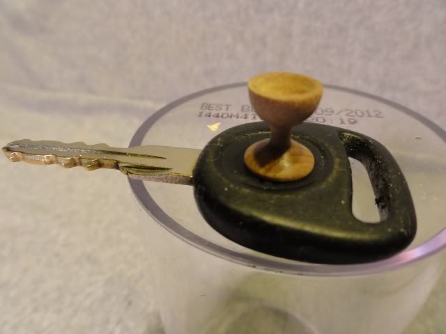

December 9, 20223 yr Popular Post comment_303833 These are the spindle gouges I use and I have turned many small items and dainty finials. They were offered by Craftsman years ago but cab be had from Ebay. I used them to turn these items. Small and or dainty items can be easily turned with common tools. Here are a few finials turned with these same tools. Edited December 9, 20223 yr by HandyDan Report

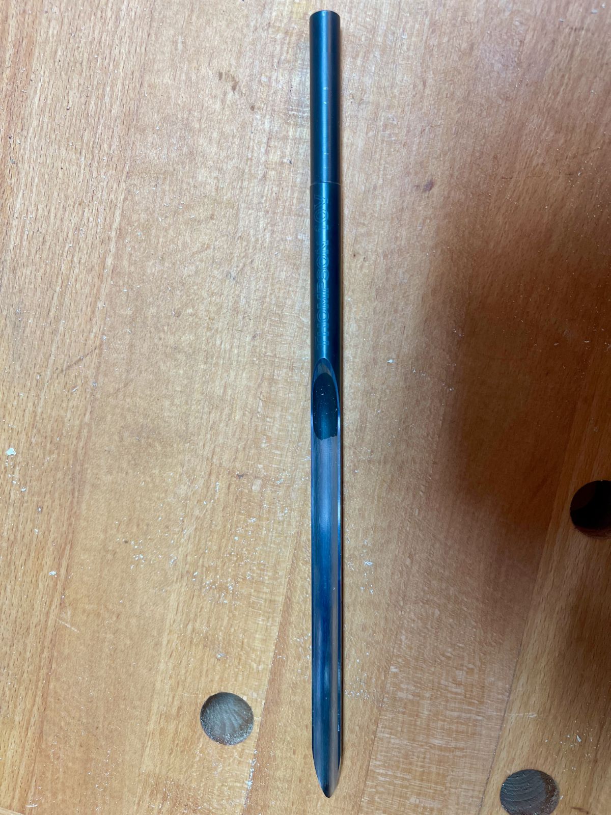

December 18, 20223 yr comment_304500 On 12/9/2022 at 1:36 PM, lew said: Cindy Drozda is considered one of the turners who produce really nice finials. She sells her signature ground tool on her website- http://www.cindydrozda.com/html/Tool_Info.html Her description- Drozda Signature 3/8" Finial Gouge This 3/8" Spindle Gouge with the Drozda Finial Grind is designed for making the accurate, precise, detailed finials for which Cindy is well known. The tip is shaped with a small radius, giving it the detail cutting ability of an 1/8" gouge, while having the strength of a 3/8" tool. The long swept back wings are used like a skew chisel for planing cuts. This gouge has most of the heel removed for better access. Hand sharpened and ready to use! 3/8" 10V Finial Gouge, 10V, made in USA, 9 1/2" long, 5" flute, unhandled. For best 10V Gouge performance, hone with diamond, or use a CBN sharpening wheel You can see , she grinds the wings quite aways back Here's a link about sharpening, from Cindy- http://www.cindydrozda.com/handouts_Pdfs/handouts/sharpening/sharpening.pdf I haven't used this tool. Lew's post sparked my interest. I had been window shopping for a spindle detail gouge and decided to try this one out. The tool is branded Thomson and may be similar to the one @Gerald described earlier in the thread. I also purchased on of Cindy's custom handles. My interest in the handle was mainly in the insert used that holds the tool. The inserts are available separately on the website. They are made of anodized aluminum and seem to be of high quality. All-in-all an elegant way to add a tool to a shop made handle. The handle is 12" long and made from mahogany with a hexagonal profile. The tool itself is well made and arrived sharp. Most of the heel was ground away. The cutting edge was difficult to photograph due the shine. I took a walnut spindle blank from the shelf and mounted it in the lathe. In about 5 minutes I had the start of a finial. The tool was easy to handle and left a smooth finish. Smooth enough that I could start sanding with 220grit Overall I would recommend the tool and I'm happy with both the performance and the purchase. .40 Report
