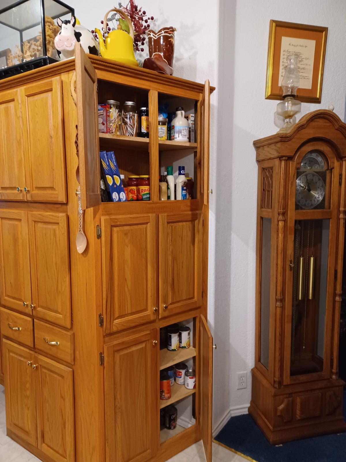

November 11, 20223 yr Popular Post comment_301991 Artie I can't express my thoughts on any subject in just a word of two.. My wife needed more areas to hide things that set out on the counter tops. She said a few hundred times can you come up with ways to hide things. The kitchen area already has 60 drawers and doors to hide things which was about double the amount we had at the last house. First we cleaned out 4 drawers by building a wall spice rack... Very simple and up out of the way and high enough the bottles stays sort of clean. Its 25 inches wide and 46 inches tall. It seems like every thing I build has something to do with baltic birch sizes. We looked at those little slide out thingies and she said they looked like they were for bragging rights only and not practical for her house...she is the cook so this her territory so I keep most of my thought to my self only part of the time.. This next picture is a very small area that the builders were stumped for what to do so they just stopped the cabinets and wasted space we thought. Where I connected to the existing cabinet I only used about 4 inches wider than the front of the cabinets already were but angling them out to match the angling hall way I ended up with 13" deep at the wall. These were just regular sets of cabinets and stopped before they took up all the room at the end. This area is slightly angling going in to the living area. The cabinets are oak and all I had at the time was ash so with a little color the wood ended up fake oak . I had built her some knife holders that set on the counters then when we moved here she said don't get mad buy I want you to build something else for the knives for this is just something else that is always in the way on the counter. My motor home gave me the thoughts to use the backs of the cabinet doors for knife racks. They used to backs for road maps. The fronts of some of the doors are also used for conviences and it does not effect the doors of working properly. The little towel racks on the two or three of the lower doors is the last thing we did and now the towels dry faster. Then when we bought the double oven it wouldn't fit right because of the size so I thought I needed to angle it to match the other side of the hall way and now it looks like this is how the builders had planned every thing to start with. I don't know why I think a book size of words is necessary so sorry for that!! Report

November 12, 20223 yr comment_302071 Artie after I had wife read what I typed yesterday she said there are two main reasons I like the rack you built better than anything else .. Number one was when she needs a little spice or seasonings she says most of the time her hands are greasy covered with butter or something sticky or what ever and they never seem clean enough to pull or slide out anything and this rack is built so nothing is behind something else hid like use to when all the things were in those four drawers I would waste more time just trying to locate something. I can stand up straight and see any and all the bottles and cans without taking any extra time I hardly ever have to waste. This is not things a man would consider when trying to accommodate wifeeee. Report
