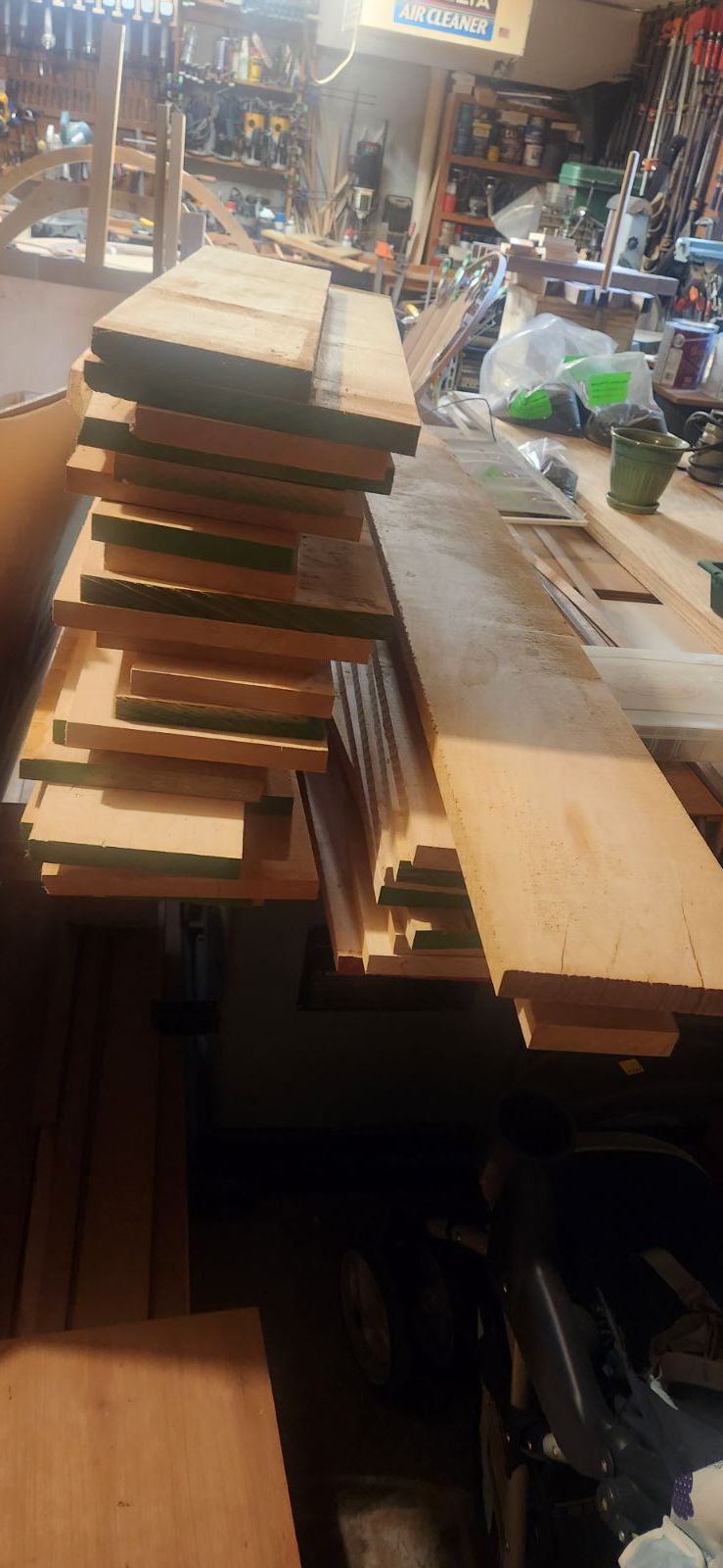

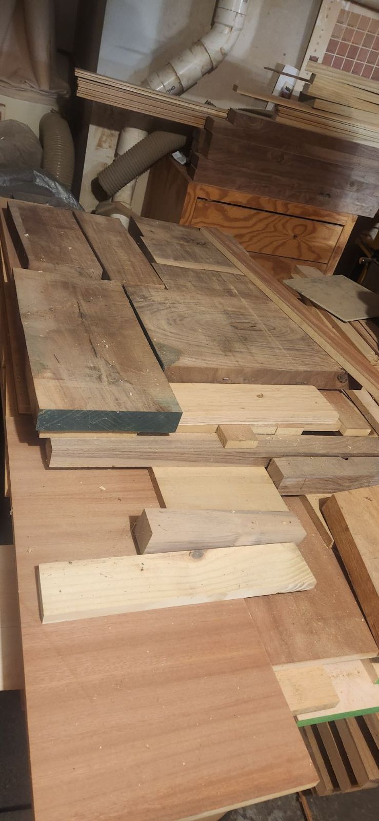

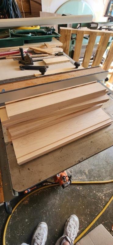

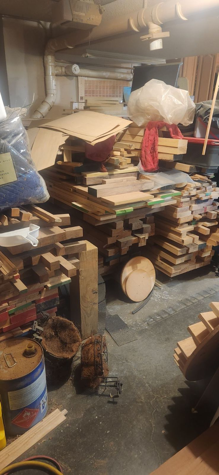

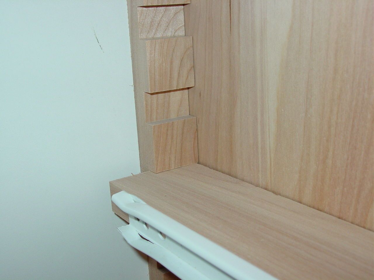

October 11, 20224 yr Author Popular Post comment_300214 Too 2 hours of moving scrap . I'll make these the way we did in the 90's. I bad sone maple and will try and use poplar scraps for the adjustable. Report

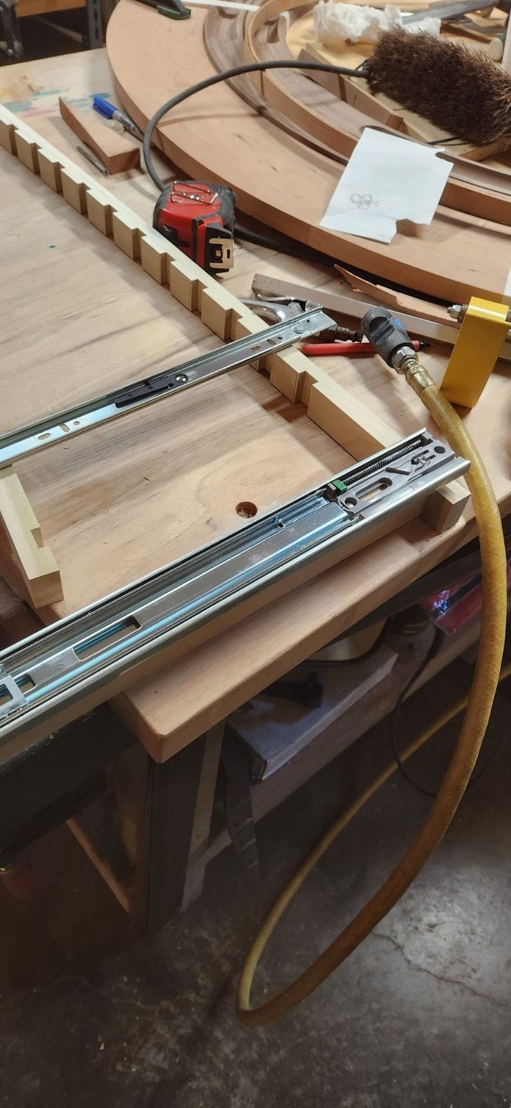

October 11, 20224 yr Author Popular Post comment_300215 I'll even use an old face frame that never got used. Report

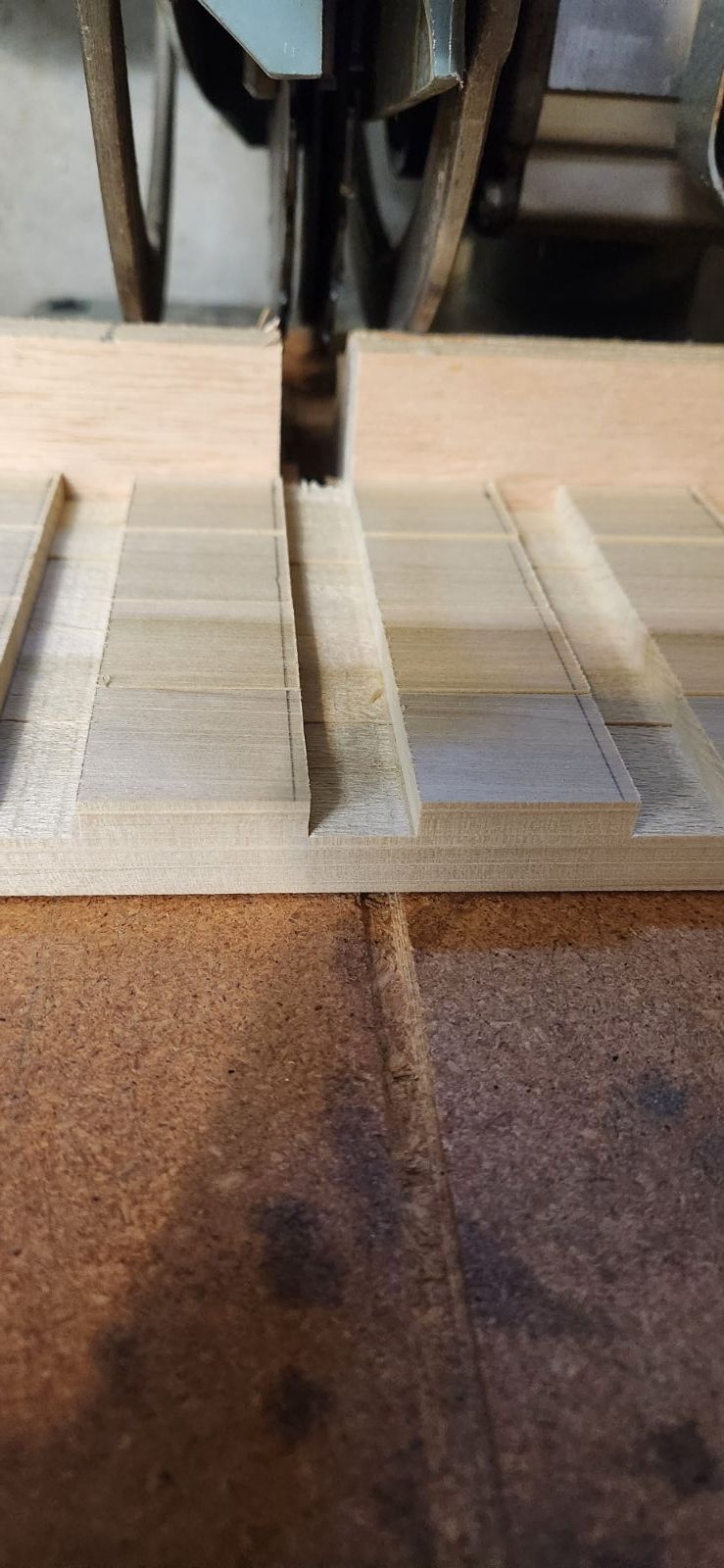

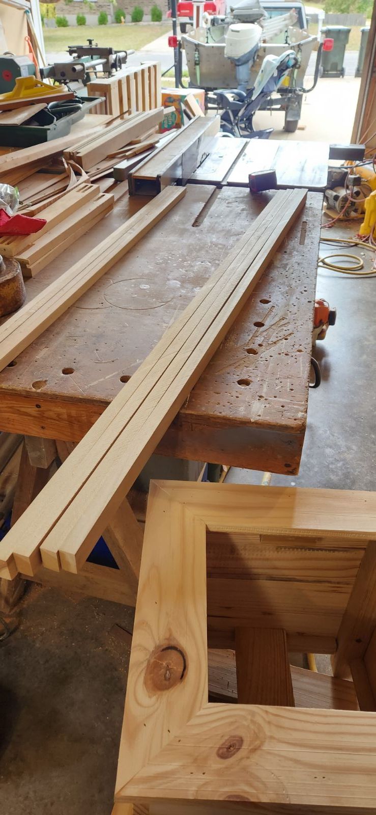

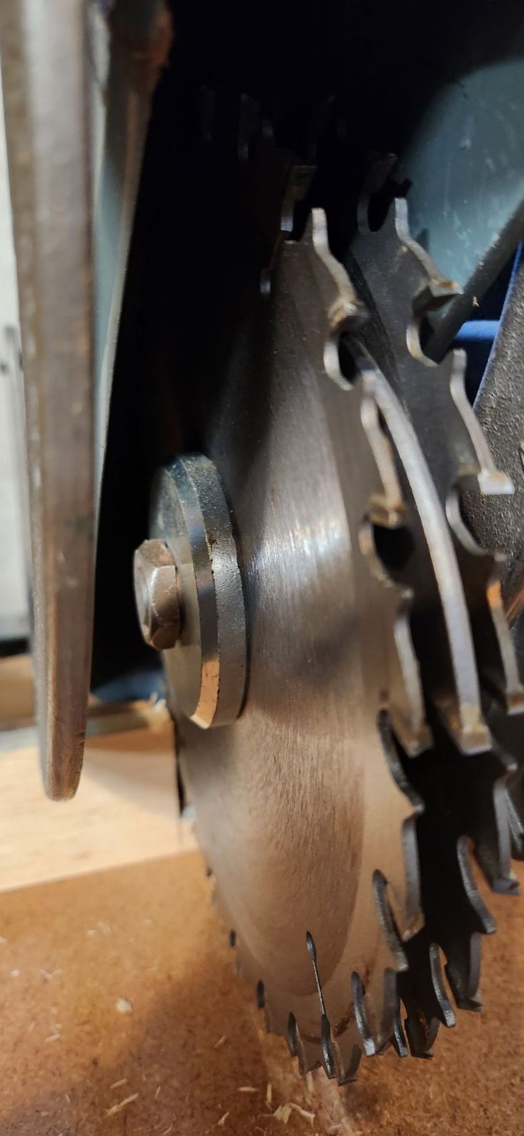

October 12, 20224 yr Author Popular Post comment_300258 A little slow down. I have a Delta 12" turret RAS.. Cuts angles perfectly, but because I have been out of the shop so long I believe the table has moved. And is no longer flat to the blade. This isn't a problem just cutting boards, but making dados it becomes an issue. I know I'm cheap, but I'm feeling perdy old these days crawling around under tools, etc... Maybe... Report

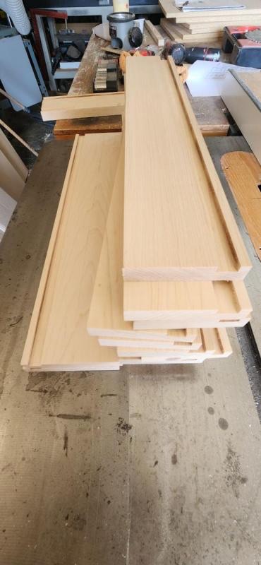

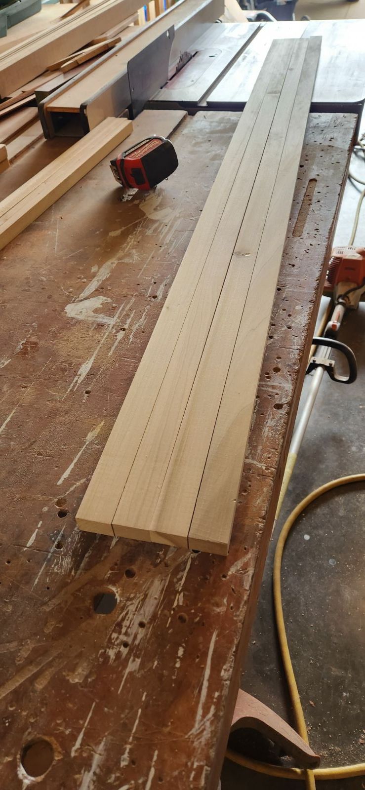

October 14, 20224 yr Author Popular Post comment_300393 I took the faceframe and cut them to useable parts. I cut, planed and sized the verticals for dados. I would much rather dado one board , but this is a recycle job, so I'll tape and dado at one tine. Report

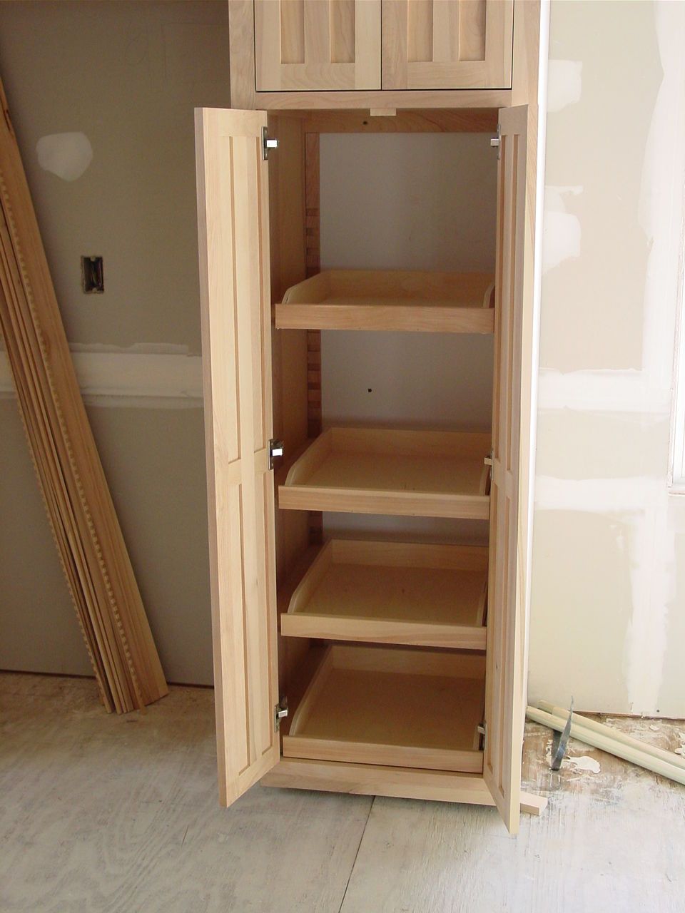

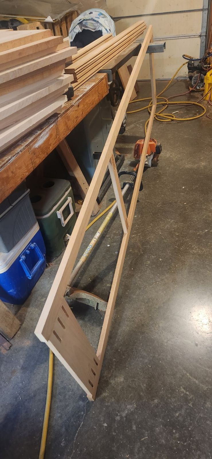

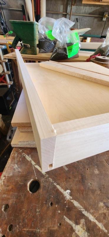

October 15, 20224 yr Author Popular Post comment_300481 To get an idea of what I'm doing here. Report

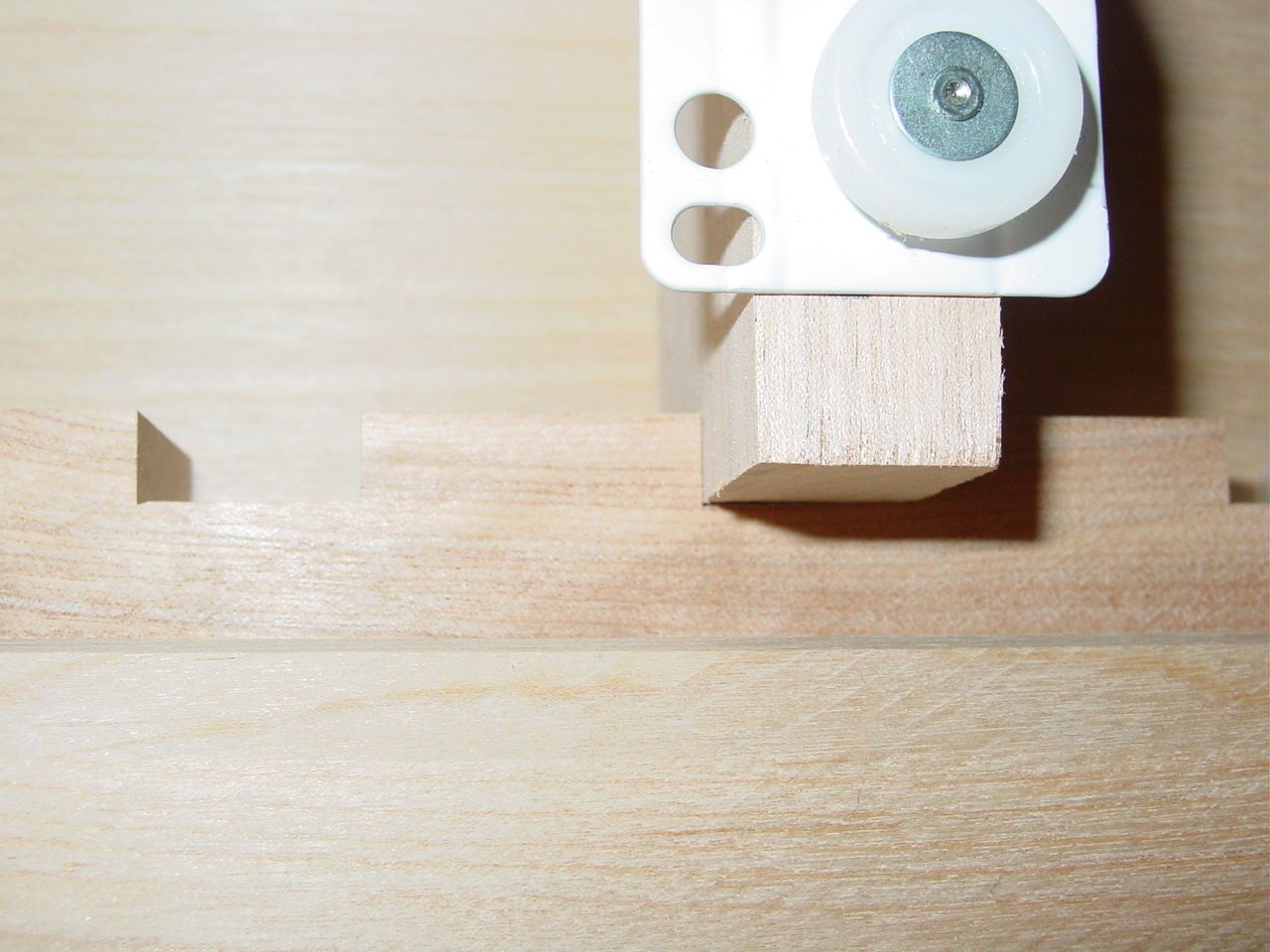

October 16, 20224 yr comment_300552 Adjustable glides. That’s pretty darned clever. And, that's one sweet cabinet, too. Report
October 17, 20224 yr comment_300631 Very nice ! Love the idea of the adjustable drawer slides. Paul Report

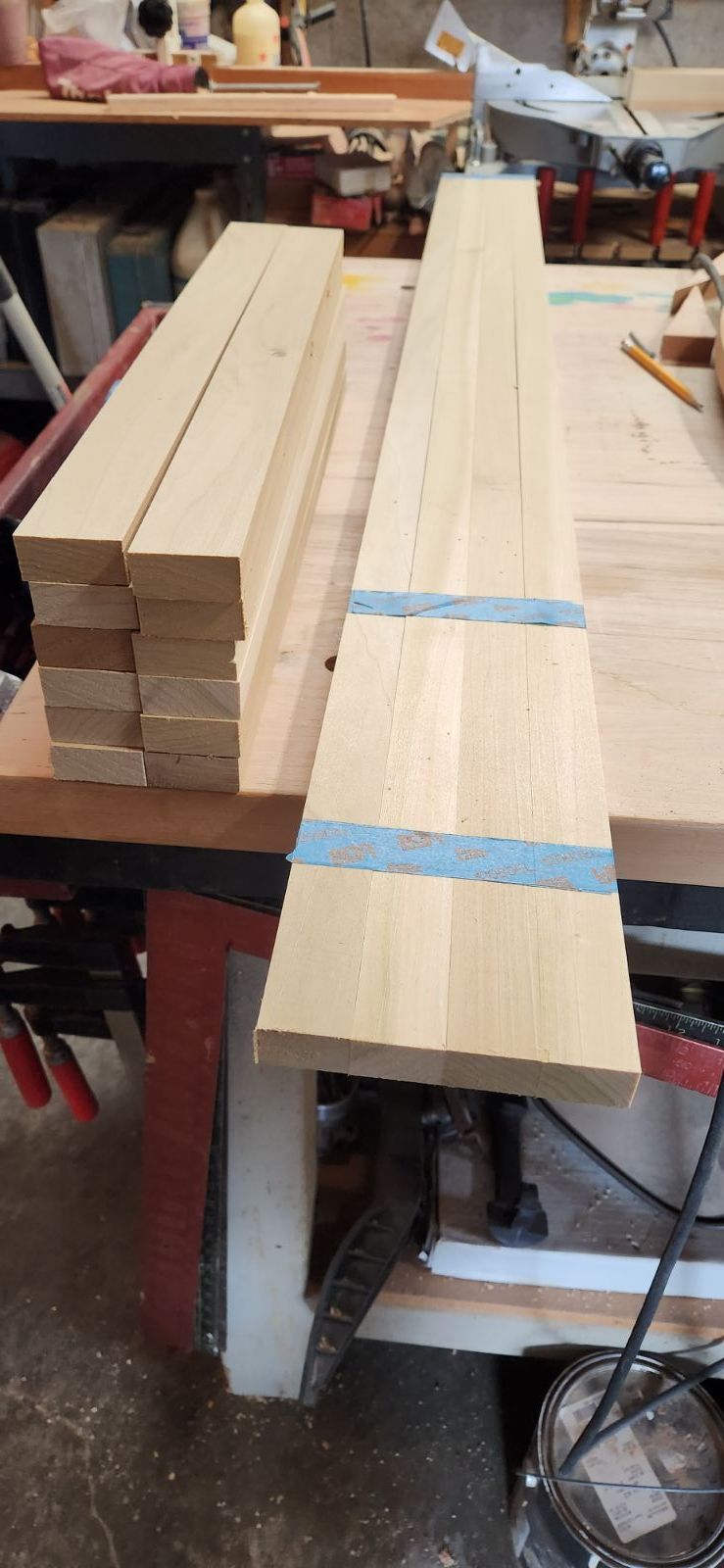

October 17, 20224 yr Author comment_300650 I spent a little time prepping some of the maple for rollouts/drawers. Before I planed my sides and back down I wanted to check my screw inventory. I made the sides and back around 9/16. Report

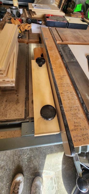

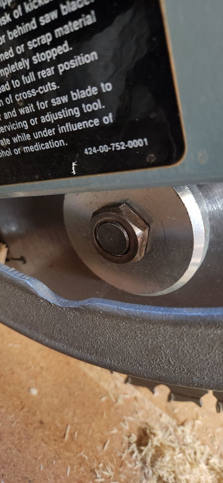

October 18, 20224 yr Author Popular Post comment_300697 I took a look at the RAS. It will take a 3/4 stack , but the nut hardly goes on. I decided I'd just do 5/8 and feel comfortable. Edited October 18, 20224 yr by BillyJack Report
October 18, 20224 yr Author Popular Post comment_300698 With the dados cut, I planed the runners to fit. As you ca.n see hoe they will mount. Report
November 8, 20224 yr Author comment_301864 Nothing much going on today. I finally did get the Freud dados installed with shims for the 1/2 maple melamine. I don't like to do dados anymore so I made a jig. It’s easier to run dados for cabinets with a router in the table.using the tablesaw fence. Don't let anyone tell you running dados is easy.its more complicated than that. Try doing dong dados for several hours, better be on your game. Edited November 8, 20224 yr by BillyJack Report
