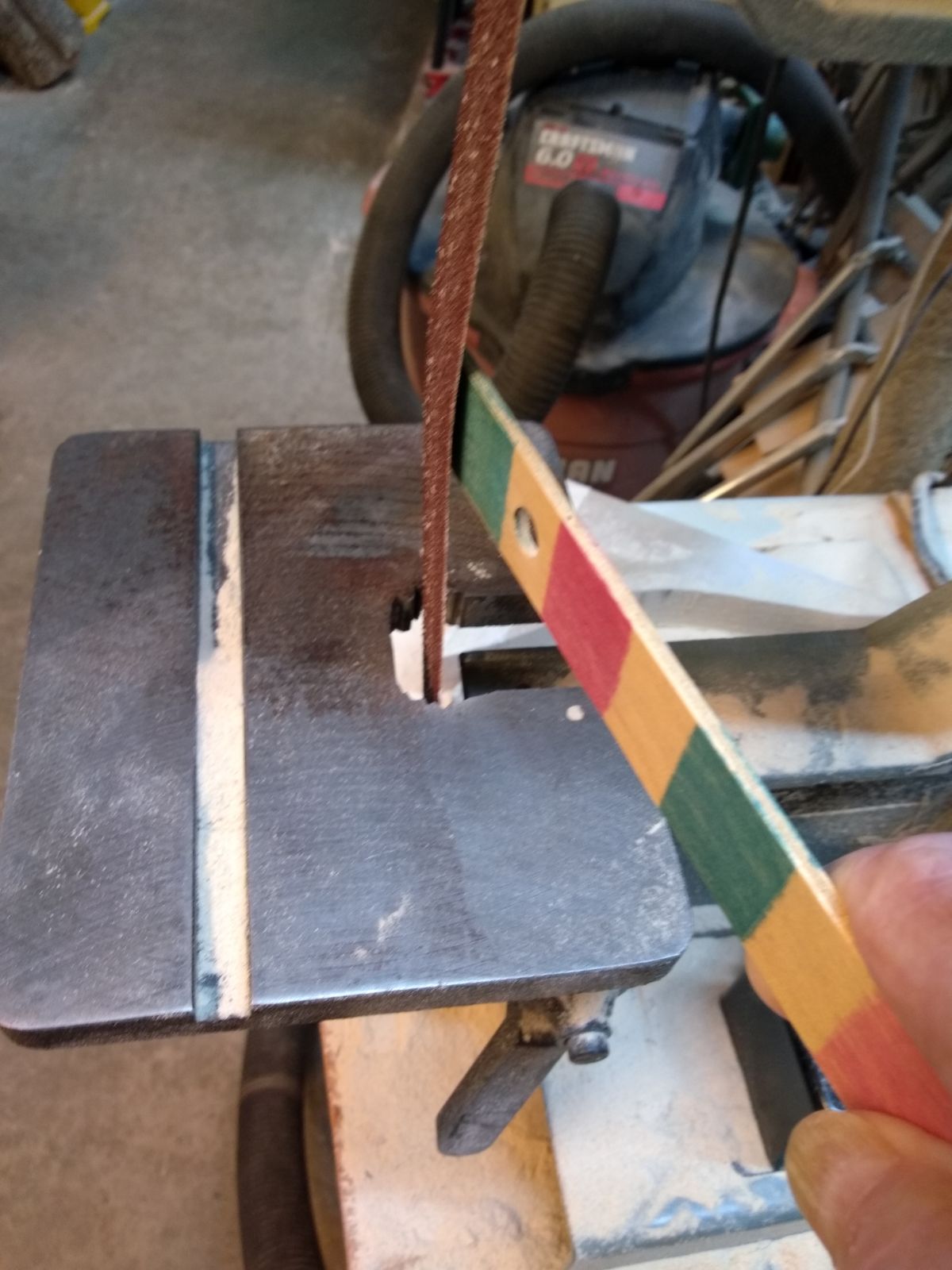

September 4, 20224 yr comment_298038 I agree Cal for the scroll saw is totally different than learning wood working tools in general and thats not counting cnc type of things. Just getting to where one can saw a straight line is almost impossible for the first few years and thats why I keep mentioning spiral blades for they do not offer any experience using regular scroll saw blades. And the regular pinless blades are what is used on 99% of the things a scroll saw is used on. Another machine that takes some time on is the 1" x 42" belt sander when rounding these small pieces of these puzzles I put together regularly. When I first started using them I would have to bend down and pick up those pieces that got ripped out of my fingers plus going in to the house for bandages and having to stop the blood flow. Now I use a 1/8" piece of BB about one inch wide behind the running belt as I guide those pieces of wood in to the shapes I need and do it much faster than using the large Saburr bits in the small 1/4" collet chuck. I never seen any one do that before. I take the flat piece of metal backing the belt slides on completely off so it does take some time to end up not making the belt slip off the pulleys. This does make the belt come apart more often but I think the time saved is worth it. So now I am looking for some real small bearings to put side by side on a little axle to have say a1 1/2" wide idler type of thing to use instead of the flat piece of wood. I hope all this can be understood for I'm no book writer type of person. Report

September 5, 20224 yr comment_298084 17 hours ago, RustyFN said: I think it was Steve Good that had something on tension. What I learned from it if you pluck the blade with your finger and get a dull sound it needs to be tighter. When you pluck it with your finger and get a crisp ting sound you are good to go. Would that be with, or without, hearing aids in Rusty? 20 hours ago, Smallpatch said: I hope all this can be understood for I'm no book writer type of person. Pics would be helpful Jess. There was a guy a week or so that posted up pics of a small belt sander that had an idler pulley that was only used when the table and belt backing thingy was not used. Sounds a bit like what you are thinking about. Report
September 5, 20224 yr comment_298101 Cal I will do the picture thingy. And RustyFN I have read that pinging thing before and I don't believe any two people alive can both come up with the same sounds they think they hear when beating on a saw blade! Please excuse my bluntness but the more I thought what I was reading the more I kept shaking my head in wonderment? So my blade tensioning is maybe more of a standard thing as most all times I set the Dewalt 788 in the middle of the dial and go from there for different thicknesses of wood and the density of the wood makes a difference also like if I was to saw bass wood would get a different setting when sawing Maple. Report

September 5, 20224 yr comment_298139 Cal this is what I do to make this sander save me some time for making or to sand out inside curves already made. I do know it also causes the belt to come apart more often but I know it saves me lots of time. I have ordered some real small bearings to make a roller set up to hold in my hand to guide where it needs to sand to go behind the sand paper. Then I read where lots of guys are not so happy with what they got for their money but like some one said hey I got 10 bearings for 10 bucks where one american made bearing is over 11 bucks each. And after I would also need 10 bearing for what I am thinking of making they are worth a try. These sanders comes with a flat piece of metal that mounts behind the blet if some one needs to sand something flatish in case I need things flattened. Edited September 5, 20224 yr by Smallpatch Report
