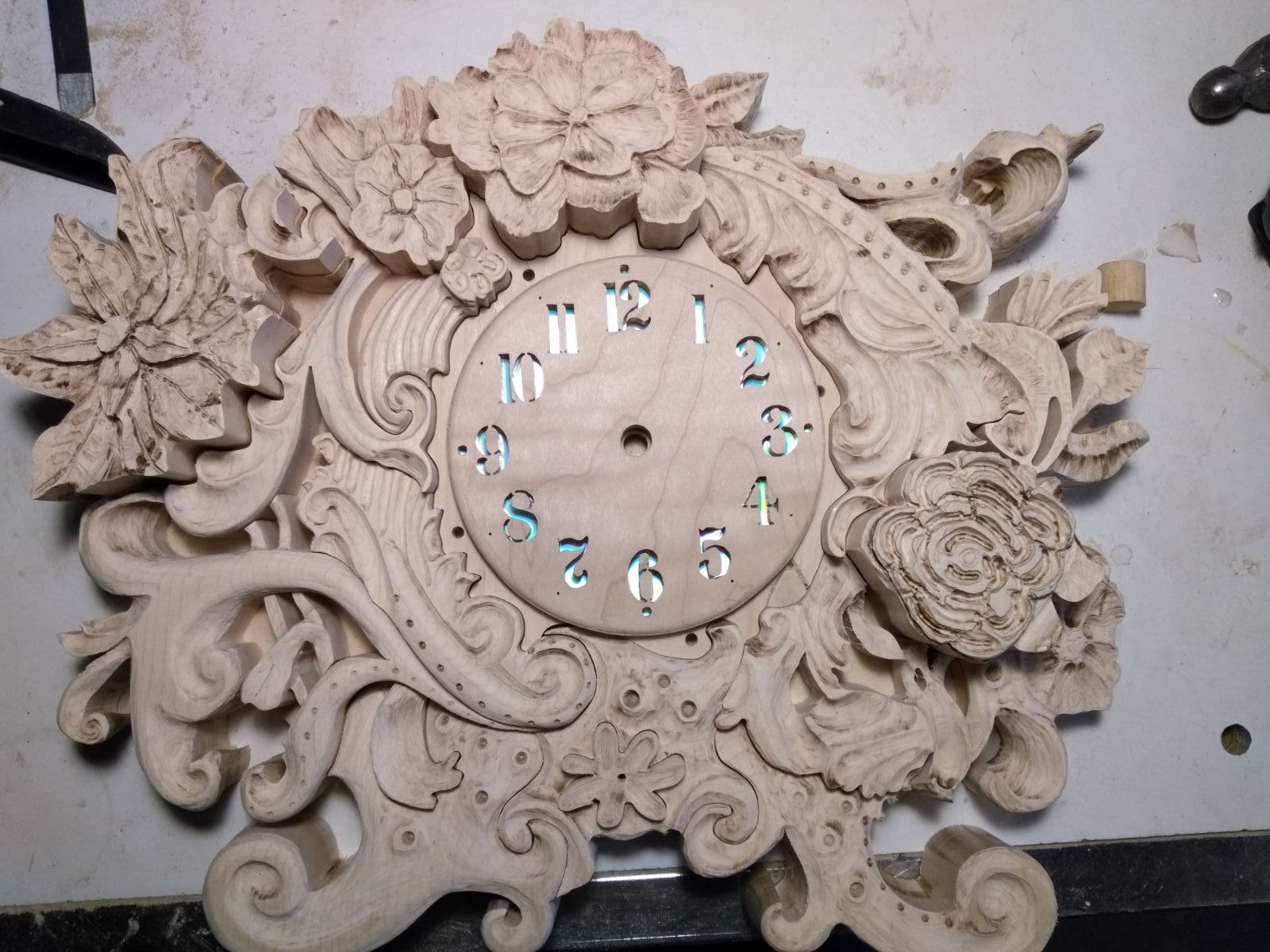

If you will use an air brush to apply the stain or dye you can do away with blotching. And you can save a lot of stain in the process.IMG_20191127_143625185.jpg.6a622d3ea4e5eafeceb04febc8f0b7bf.jpg
  I did this using maple so I wanted to get just enough color to separate the boys from the girls, so to speak. IMG_20191101_164850068.jpg.d4f57531cf5d4acffaa42f621cddc2ce.jpg
  And this was before any color. To me it looked a little blaw if that is a word.
