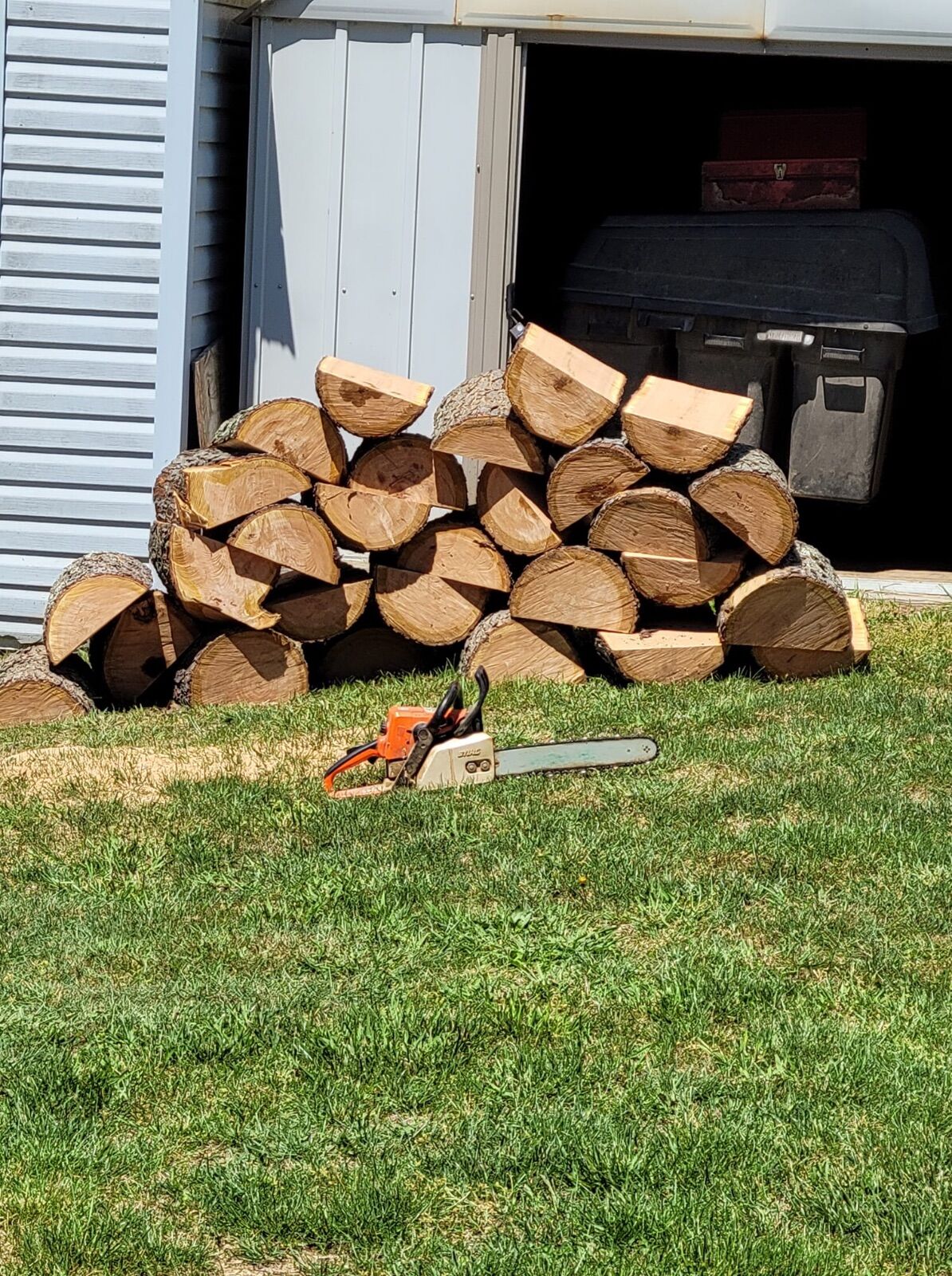

May 12, 20224 yr Popular Post comment_290572 I went to play disc golf with my friend. We found a cherry tree that looked like it was just taken down. After we were done we went to my house and got my chain saw. The rest is history. Report

May 12, 20224 yr Author comment_290608 9 hours ago, Gerald said: Talk about luck! was it already cut up? I had 3 logs about 6 to 8 foot in back yard for several months before I processed them and once cut I put one log in barrel of water and covered. That was last fall and may turn a little this coming fall. No it was a solid tree. They normally cut them up and just pile them up and let them rot. We cut this one up and threw the branches on the nearest pile with the old stuff. I’m sure who ever is in charge at the park will go back and wonder what happened to the tree. The top 15 feet was starting to get rotten inside so we threw all of that on the pile also. I will cut these in half to cut the pith out then I will wax the ends. They will last a long time like this. Then I will start to rough turn a bunch of bowls and vases and set on the shelf to let dry. Edited May 12, 20224 yr by RustyFN Report

May 12, 20224 yr comment_290644 6 hours ago, RustyFN said: I’m sure who ever is in charge at the park will go back and wonder what happened to the tree. I did that once, with century-old gutter pavers buried during an unknown dig, uncovered by a later utility company. One guy said "Take them this weekend or they'll be gone on Monday" . . . Rusty, can you tell me what I'm looking at regarding the wood? Is the center dampness sap? What about the thick yellow outer part? Report
May 12, 20224 yr comment_290651 58 minutes ago, Woodman said: I did that once, with century-old gutter pavers buried during an unknown dig, uncovered by a later utility company. One guy said "Take them this weekend or they'll be gone on Monday" . . . Rusty, can you tell me what I'm looking at regarding the wood? Is the center dampness sap? What about the thick yellow outer part? Not Rusty but the white is the sapwood, which is usually larger on smaller diameter trees. He said part of the top was rotten so I think that wet spot is the beginning of rot. Buy the way if you turn cherry when fresh you can keep that sapwood whiter, same also true of walnut. Report
May 12, 20224 yr Author comment_290653 1 hour ago, Woodman said: I did that once, with century-old gutter pavers buried during an unknown dig, uncovered by a later utility company. One guy said "Take them this weekend or they'll be gone on Monday" . . . Rusty, can you tell me what I'm looking at regarding the wood? Is the center dampness sap? What about the thick yellow outer part? Not sure. I am fairly new to all of this. I know the wood is good because my friend I was with is what I call a master turner. I call him that because he is a registered artisan at Tamarack in West Virginia and is one of the people that judges the work of anybody that wants to get into Tamarack. He has been turning for years and we left behind anything that was questionable. The wet part in the center is solid. Report
May 12, 20224 yr comment_290655 The first second picture shows them already dry. It is Spring so the sap is flowing well this time of year. Looks good to me. Neighbors Maples bled like that. Report
May 13, 20224 yr Author comment_290724 Today I cut them all in half, cut the pith out and waxed the ends. The one that were wet in the center were only like that on the surface. The inside looked good. Report
