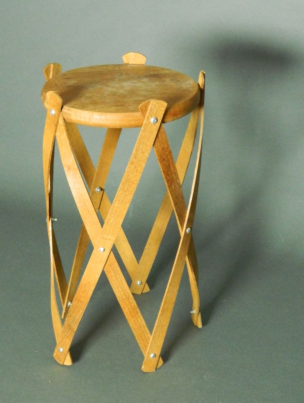

This is a baby Twister table.  Also used as a plant stand until the plant died. All teak, but not much of it.  These twister tables I like to make when I've just got a little bit of some wood left over from a larger project. I generally look at the direction of the wood grain and draw a line parallel to it near an edge.  I trim to that line with the band saw and run the edge across the jointer.  Then back to the band saw to rib a strip, the join the edge, then repeat 9 more times for 10 strips with one good face. I run them through my drum sander bandsawn edge up to smooth them out.  Drill the holes at my drill press with a fence and stop block so they'll all be in the same place. I assemble the lattice base before drilling holes in the round top.   The assembled cylinder shows me right where the holes need to be around the edge of the top.  This little teak twister looks nice. I believe the nicest one I've ever made was cherry wood and for a customer. On that one the strips got a little more attention to take the sharp edges off with a small bevel.
4D
