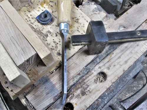

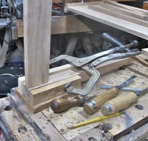

Legs are made of Ash.   Key Tip:   ONE good whack, then move, and whack again....clear the chips as you go.
6mm Narex Mortise Chisel, and a Mortise gauge set to that width.   Jig is set up on the top of the bench's leg...no bounce allowed.
One curved chisel for bottom cleaning, wide chisel to clean the sides of the mortise...Mallet has plastic faces ( Hyper Tough, Walmart brand) Rest of the tools as needed...Then I just sit down on the shop stool, and get to chopping.
I strop the chisels after each mortise is done.  Usually by using the pants leg of my work jeans...

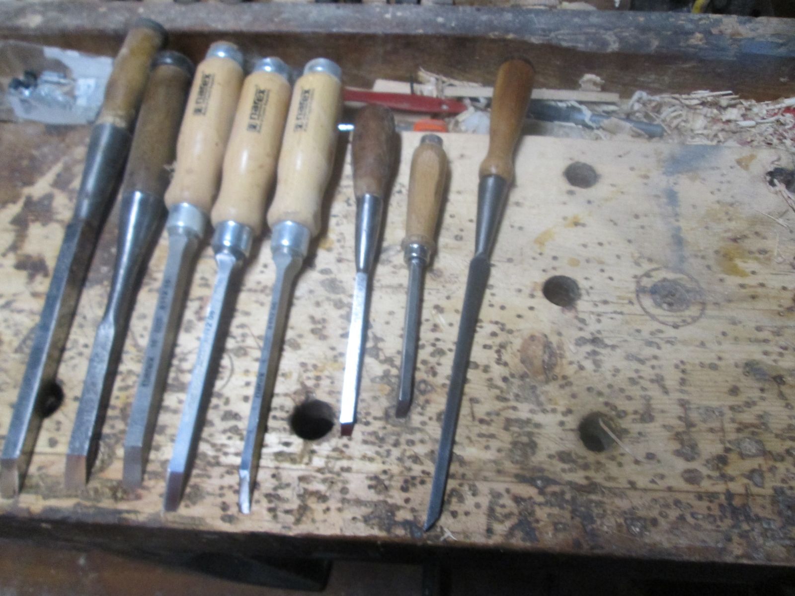

Mortise chisels in my shop..
Big guy is a 3/8" Buck Brothers.   Japanese is 12mm..the 3 narex chisels are from gene Howe
And remember,
Them skinny mortise chisels are usually call Sash Chisels....that short one came from a Handy Andy tool set...
