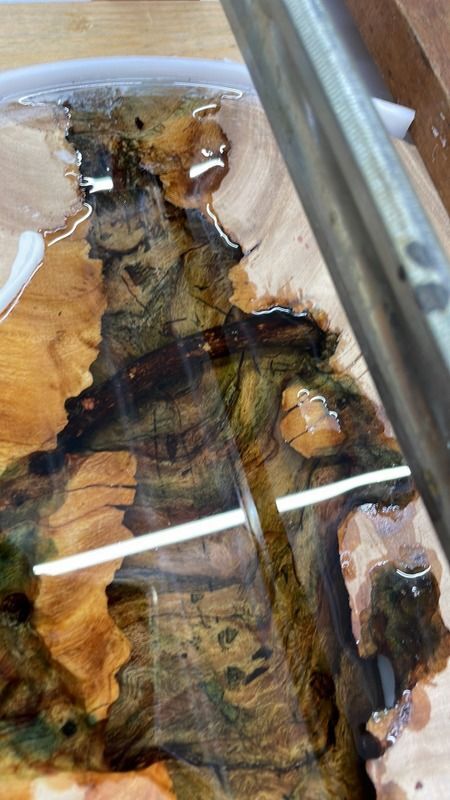

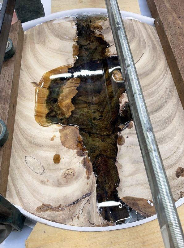

March 11, 20224 yr Popular Post comment_285841 I think I posted pictures of this piece of wood earlier but a quick search didn't find that post. I had started to turn this into a platter but it was just too iffy for my taste. That, and I found a neat inclusion that I wanted to save so I took it off the lathe and decide to make a tray or a platter. To do that, I needed to do a resin pour, something I'm not the best at. Did some research and decided on a product called "liquid diamonds" and finally this morning I worked up the nerve to try the pour. Not the best picture because of the glare from the lights and the colors don't show up real well. I dyed the "creek bed" with aniline dye in red, blue, and green. It shows up well but not in pictures. The resin I used is supposed to be glass clear and not have bubbles, so far I'm pleased with what it's doing. I had this piece of wood mounted on a faceplate and of course that meant screw holes. I didn't want obvious screw holes showing so I carved out a couple areas of "erosion" on either side to hide the screw holes hoping to make it at least a little natural looking. This picture shows what inspired me to attempt this. I have seen a lot of crotch pieces but I've never seen one that had limb inclusion in it. I just felt that had to be preserved and highlighted if possible. Honestly, I'm not sure how to proceed after this cures. I may put it back on the lathe to dress the edges or I may use a circle jig and router. I do know, I really, really, hope it goes well from here. Edited March 11, 20224 yr by Steve Krumanaker Report
March 11, 20224 yr comment_285852 Oh, Wow! that is going to be beautiful!! Do you thing it might be necessary to put a clamp around the perimeter to hold it together when re-turning it? Report
March 11, 20224 yr Author Popular Post comment_285863 59 minutes ago, lew said: Oh, Wow! that is going to be beautiful!! Do you thing it might be necessary to put a clamp around the perimeter to hold it together when re-turning it? If I do return it at all it will only be to dress the edge. After the resin hardens I don't believe it could fly apart if it had too. Report
