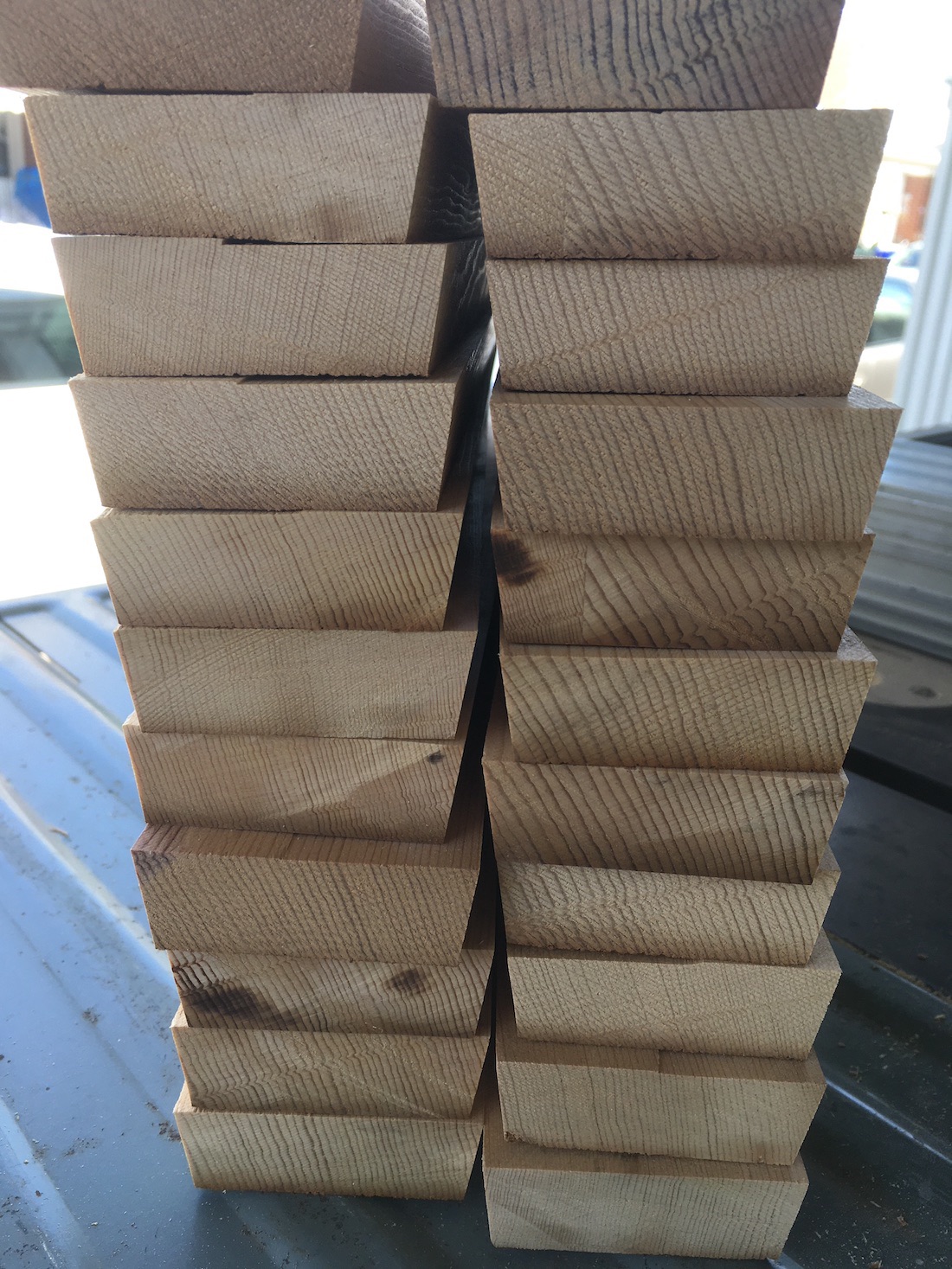

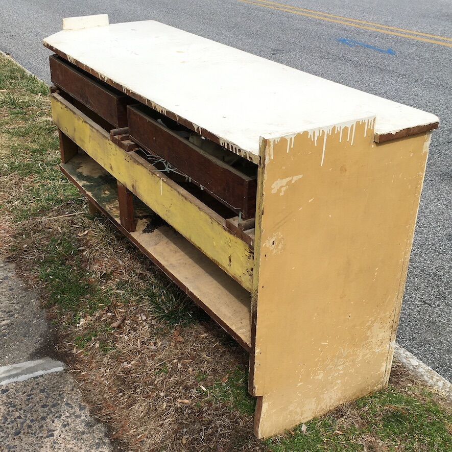

May 1, 20224 yr Author Popular Post comment_289699 The basement re-de-cluttering is in high gear; had the opportunity to look at the curb find top and get a picture. LED bulbs, overexposed, not my favorite. A tough grain to capture. I plan on ripping the fine-grained part into slats, ripping on a bevel, and assembling a larger cylindrical vessel. 12"D x 14"H will be big enough to hold more. I'll also save a piece for a mandolin maker; it'll carve nicely for one top. The reclaimed cedar was too knotty, had to go with 60 grit and 'lectric. Not this time. It should plane real pretty into roundness. On the last three round vessels, I beveled both sides of each slat, say, 10˚. The final should look the same if only one edge is beveled 20˚? Edited May 1, 20224 yr by Woodman reduced viewer image size to 400 pixels to allow users quicker download; 1200 pixel resolution available by following link Report

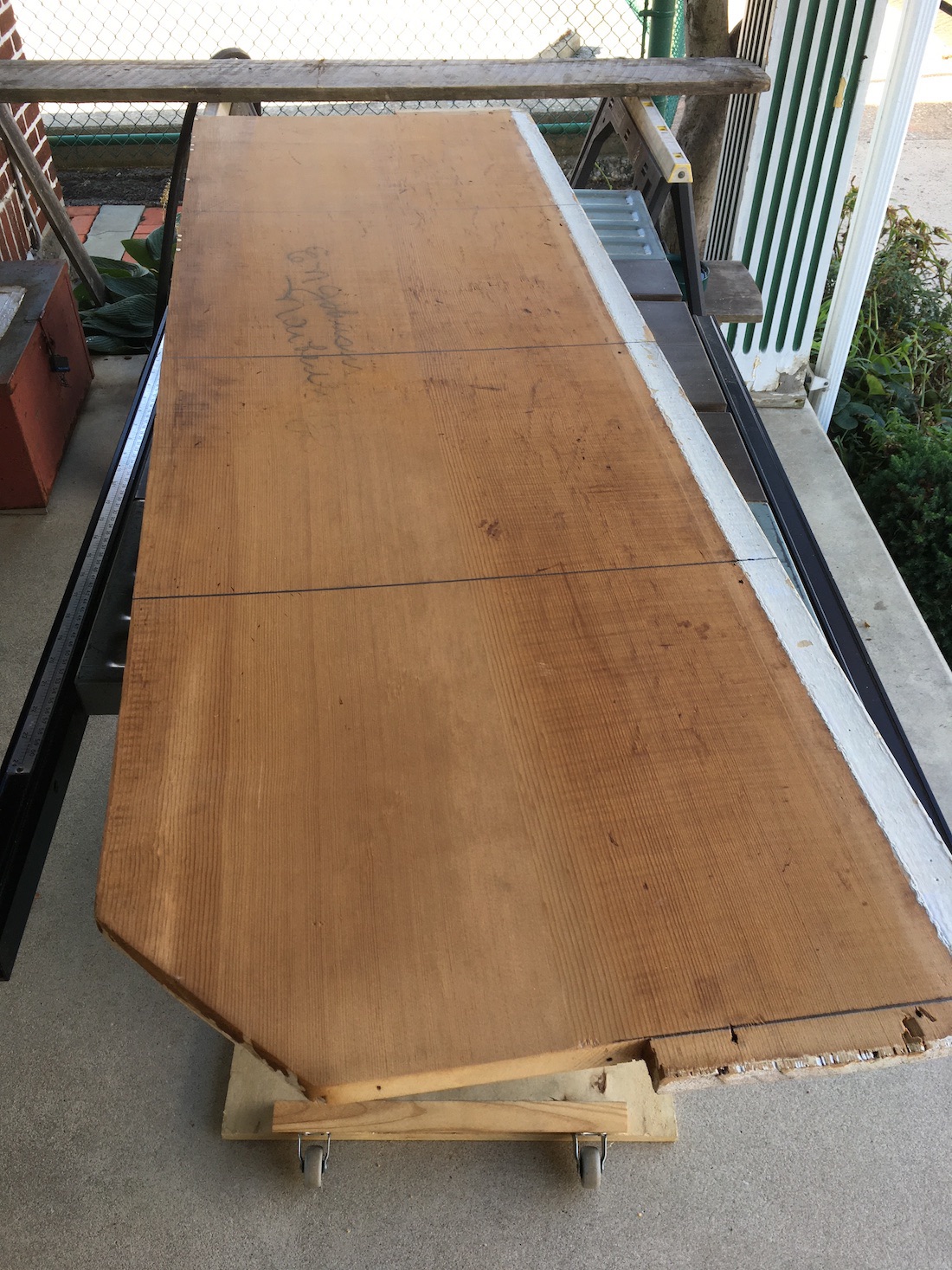

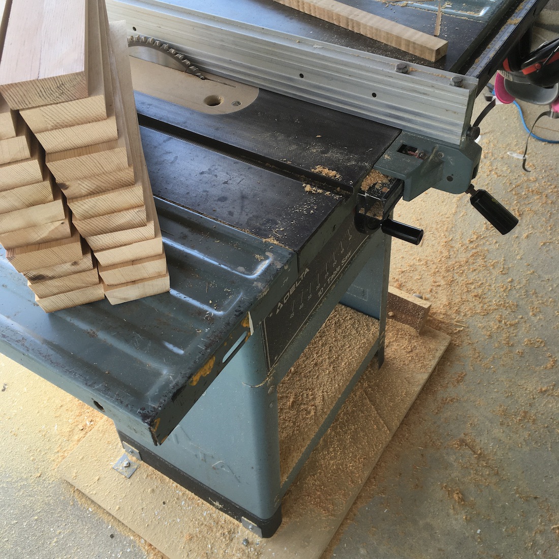

July 25, 20224 yr Author Popular Post comment_295228 It only took two months! The sideboard top was laid out, studied for a few days, measured twice, lined out, and yesterday porch-cut on the c.1988 ∆ Delta 34-670 10" 110 lb table saw. Freehand crosscut into half, twice more, everything ripped to 2 7/16". All planks had 3/32" resawn off to remove old paint in two passes each with half-height blade for safety. A 10˚ bevel ripped into both edges. Cylindrical Vessel No. 4 begins. And I treated myself to a 60 1/2 adj. mouth block plane because this old-growth grain is REALLY fine. Report
August 3, 20224 yr Author comment_295901 The top of this curb find has become a laundry vessel. 15" D x 14" H x 8+ lbs Nearly all of the wood from the sideboard top was used to make this vessel. It's got one application of SealCoat on the exterior. Things got wonky. The cylinder began moving into a helix, so the rabbeted ledge for the base had to be abandoned. I made that bottom the top and retained part of the rabbet detail in the final. The inside was mostly scraped but I did sand to remove some glue and dripped SeatCoat. I'll scrape the inside again when my forearms heal. The grain becomes dark, crisp, and handsome after a fresh burr. Report
