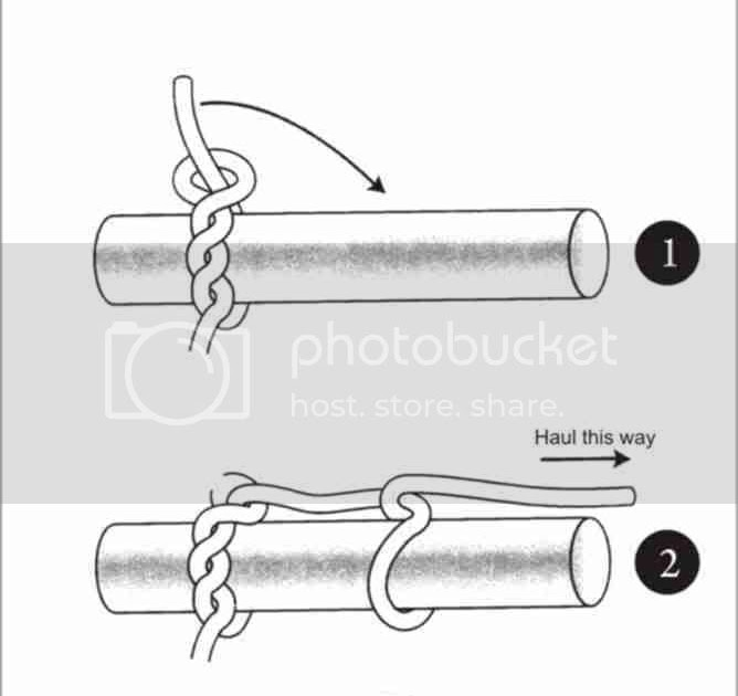

A "Two half hitch" knot, followed by 2 or three half hitches would be my recommendation, as if the load starts to slip, the knot tightens.  But if you can factor in a trailer or van, that would be another option.  Enterprise, for example, will rent cargo vans and I don't think they charge mileage like U-Haul does.
In this diagram, the numbers would be the front of the bed where the loose end is secured.  If the load starts to slide out, tension tightens the knots.  This diagram shows the terminal knot a timber hitch, though.  This is sometimes called a "killen hitch"
Thanks for the knot tying information.  In the past I always had a way, but usually not the best way.   I may look into the cargo van rental.   Danl

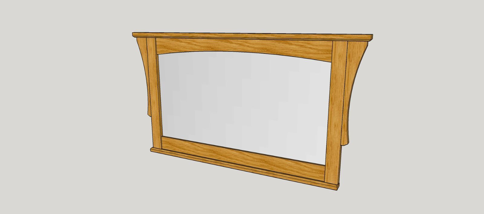

Ooops.  I for got the pic of the mirror again.  Danl2046234865_mirror-1wcolor.jpg.14f947c297bb66a781631de3c3d19cc3.jpg
