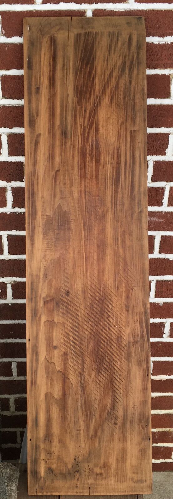

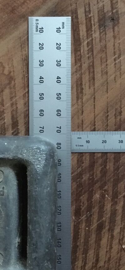

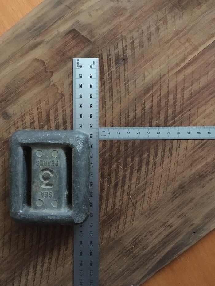

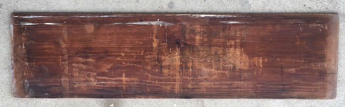

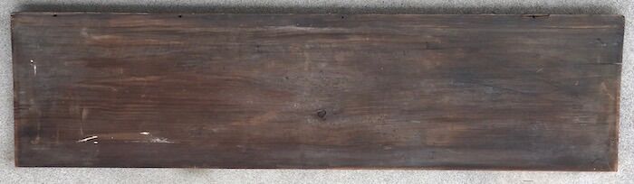

Wanting to know what size blade cut these markings, I did some research. Then a bit of math using a formula. The straight line is called the chord and the other, the rise.
[(rise-squared x 4) + chord-squared] ÷ (8 x rise) = radius
I used millimeters for accuracy; chord = 140mm, rise = 4mm; 19600/32 = 612.5 x 2 = 1225mm = 48”

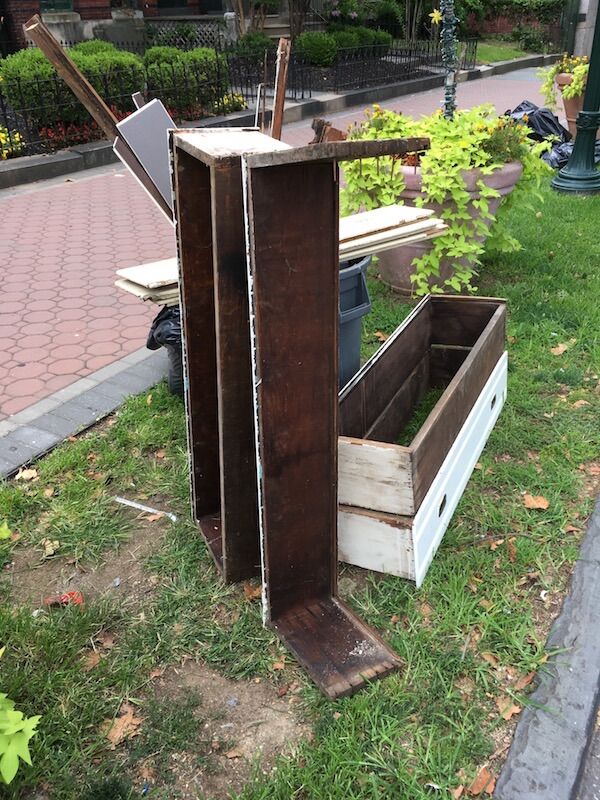

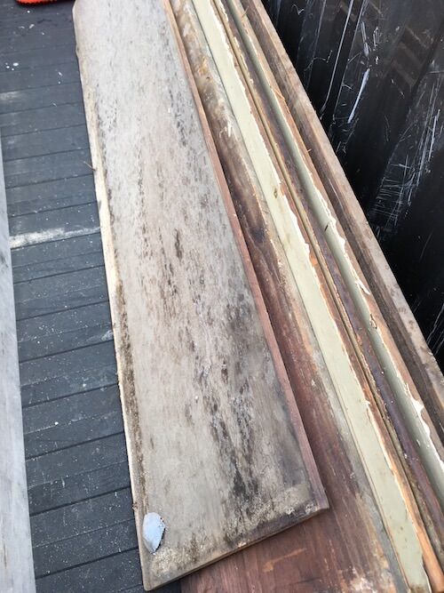

This pile of wood looked interesting. It had remained curbside for a few days. Eventually I stopped. With a little more forethought I wood have taken the pile. But only grabbed the drawer bottoms. And they sat in my basement until Mid-Covid ... I found images of the boards on my blog from August 2018.
In the rough, and a few projects. The fourth board chosen had these blade markings. After online sleuthing this morning, I find the phrase kerf marks and kerfs (term confirm please).

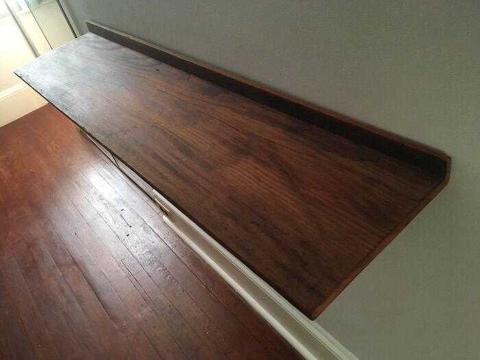

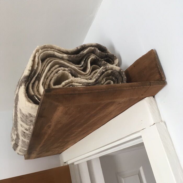

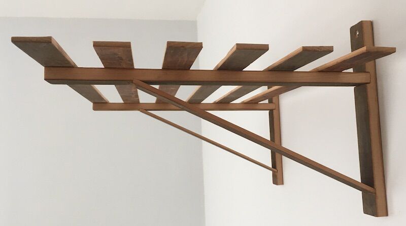

The slat shelf is my favorite; I use it every day as a pillow shelf. Radiator closed (it usually is off), linens and blankets put on hooks, pillows on the pillow shelf, window opened, door closed, the whole compartment aired out daily.

Kerf & kerf marks - IMHO, the kerf is the gap left when the saw blade cuts through the board.  In my mind a gap doesn't leave marks, the saw blade did.
***Notice when I typed the word "kerf" that it became underlined?  Supposed to take you to a TPW dictionary for the word - but it doesn't seem to do that, or maybe I don't know how to access it... hey @John Morris, what's the key here?  May just be semantics, but I've never heard or used the term kerf marks.
Getting to your formula, I'm sure our resident "math guy" @kmealy  could join in here with some commentary.  My first question is whether the speed the log was carried by the blade, or with a bandsaw the speed of the carrier by the log would make any difference?  Or blade speed, or tooth size...

Yes. I get nauseous recounting my ignorance that summer of 2018. Clear aged 5/4 sugar pine, likely. A few blocks away, '00 or so, I found a table outside a church covered with contact paper. Its top was 5/4" x 22" sugar pine.
These bottoms were 1/2" stock, hand-planed on three sides to fit a slot on the drawer sides and back, tacked on the front. Back before closets, before folks own twelve coats and enough clothes for a family of fifteen, when masonry structural walls interrupted modern flow, nooks would have been filled with whatever method was favored by the carpenters. These were built-in-place to size drawers. I've seen them before but never realized their architectural significance.

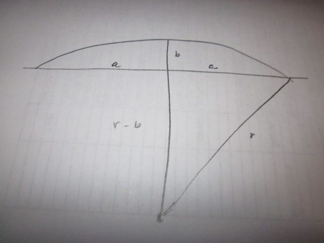

Easier for me to derive the formula that find it.  See the diagram, chord is 2a, rise is b, unknown radius is r
Using the Pythagorean theorem
a^2 + (r-b)^2 = r^2
simplifying this to solve for unknown r,
a^2 +r^2 - 2rb + b^2 = r^2
a^2 + b^2 = 2rb
(a^2 + b^2) / 2b = r
Which, if my mental math is working is the same as your result, but a little simpler because I took the cord length / 2 as my known.
If you have a compass and straightedge, you can find the center of the arc, and thus the radius without any arithmetic.

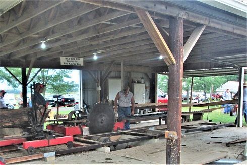

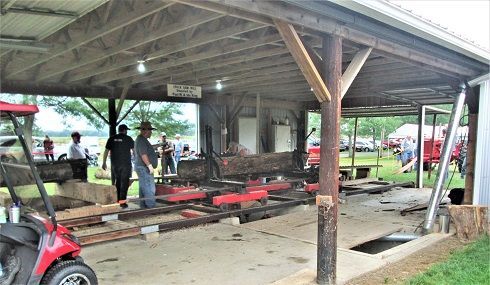

There is this one down in West Liberty, OH...
Note the size of the saw blade...and..this was the SMALLER of the 2 in the shed..
:JawDrop::JawDrop::JawDrop:
Hey! It works!
4916/8 = 615mm = a little more than a 24” radius

Always thought most of these sawmill blades were similar size, but irregardless bigger than I want to get close to.

Nine feet, according to one resource:
After 1813 or 1822 saw mills use large circular saws, up to 3 meters (9 ft) in diameter.
