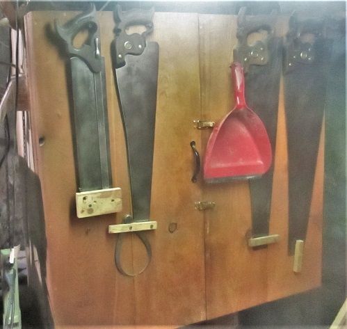

Crafting hand saw ideas
Old school for a handsaw...
or...
or..
Disston No. 68?
Millers Falls coping saw....
Disston No. 4 backsaw...a few coping saws...D-8 Panel saw
One on the right is a xacto razor saw..24 tpi
